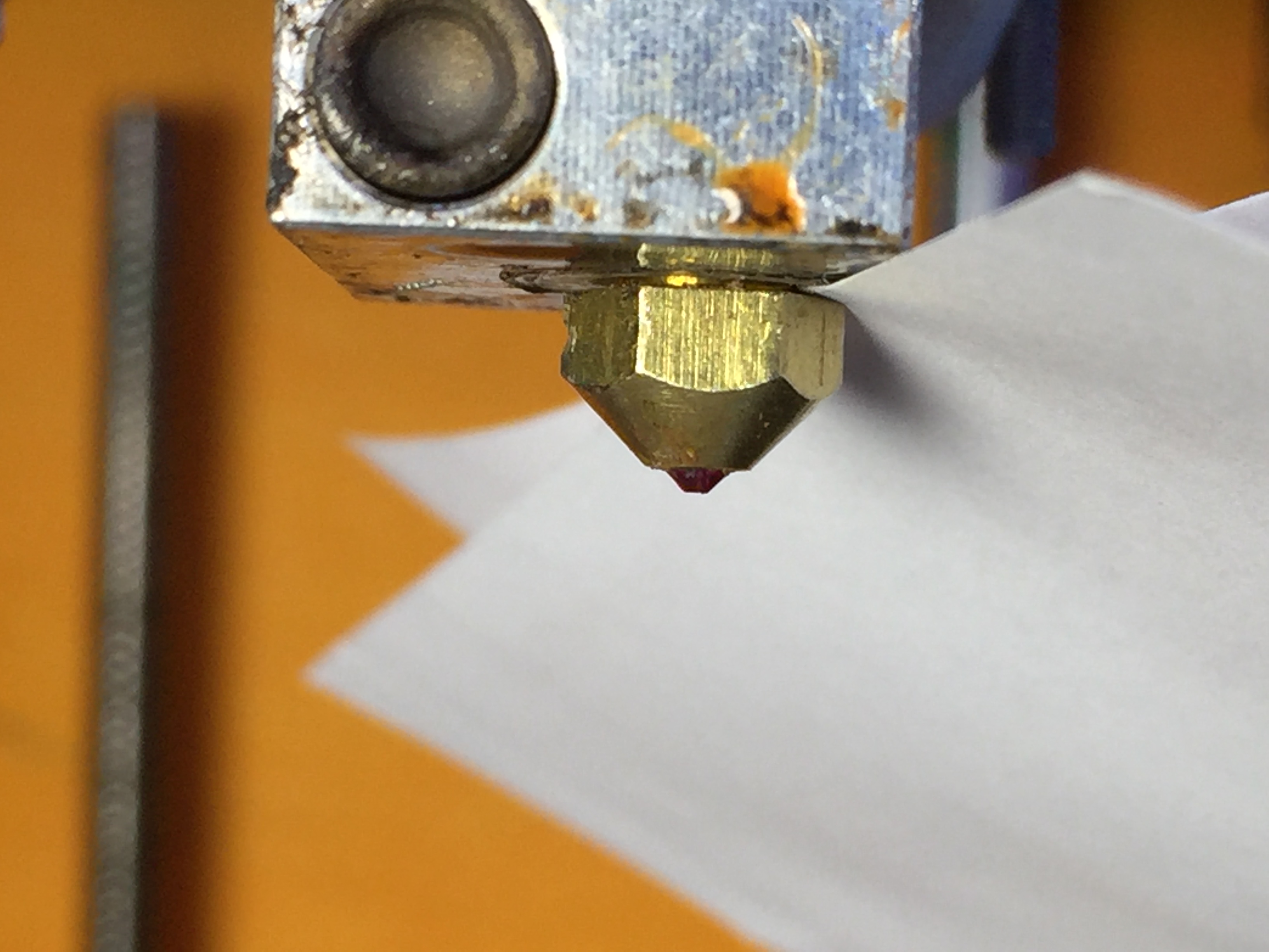

Well I made sure that brass pipe is in the block as far as it can go
It's not flush but the gap is about two pieces of paper!
That's looks perfect
You are right Titus, but as the PEEK is tight against the pipe, turning the PEEK will screw the pipe in the block, so it might be easier...
Looks very good to me as well.LePaul wrote: It's not flush but the gap is about two pieces of paper!
The problem of turning the peek it's that the flat base of the barrel brokes so easy. Or worse, it bends and leaves a gap on the upper side with the ptfe coupler leaving a internal leak (that will cause color distorsion, spots and blocks). But if you want to remove the peek the best and safest way it's to have the nozzle/barrel assembled and when cold (or 90C if you get leak) then you can unscrew the peek without damaging the barrel. I learn this the hard way by breaking 4barrels with different methods. Good my barrels cost 7€ each

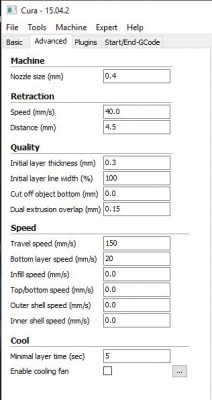

Now, for a proper XT-CF20 test....I know fans off (Advanced Tab)
What would you guys suggest for Cura settings and a good test model, perhaps something we can all try printing

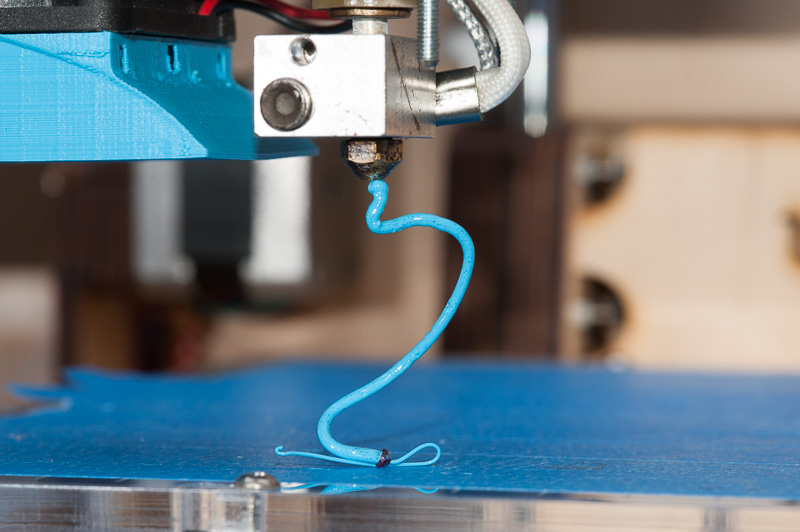

Ooops...
Don't show the ruby the competitors will dig on how it's assembled (or something like that anders said)
Yes indeed this one is on purpose low-resolution, I sent more detailed pictures by PM to Anders...
I was waiting for that to happen looking at your previous picture, something went wrong there, that is why I call these nozzles prototypes and don't sell them yetAmedee wrote:Ooops...
Currently working on the dimensions of the next version to prevent this from happening.
The nozzle Paul fitted is actually one of my home-made prototypes which might be a bit stronger in this sense.
I have had several such ruby-popping incidents with previous protptypes by the way, even figured out a method of getting the ruby clean enough to reuse it

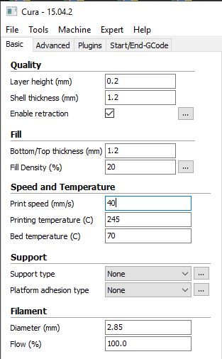

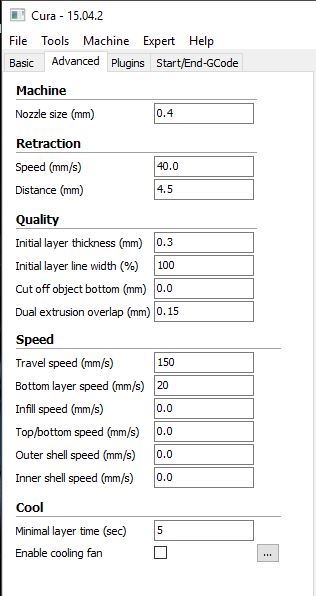

Just got home a bit ago and scrolling through the Filament thread on XT-CF20. I also looked at Neotko's fan shroud tutorial to see his settings as well. I'm not sure about two things...(1) Glue stick? and (2) Retractions?
Filament thread here viewtopic.php?f=14&t=14
I think I have the basic settings...if you think there are things I should change, please advise!
