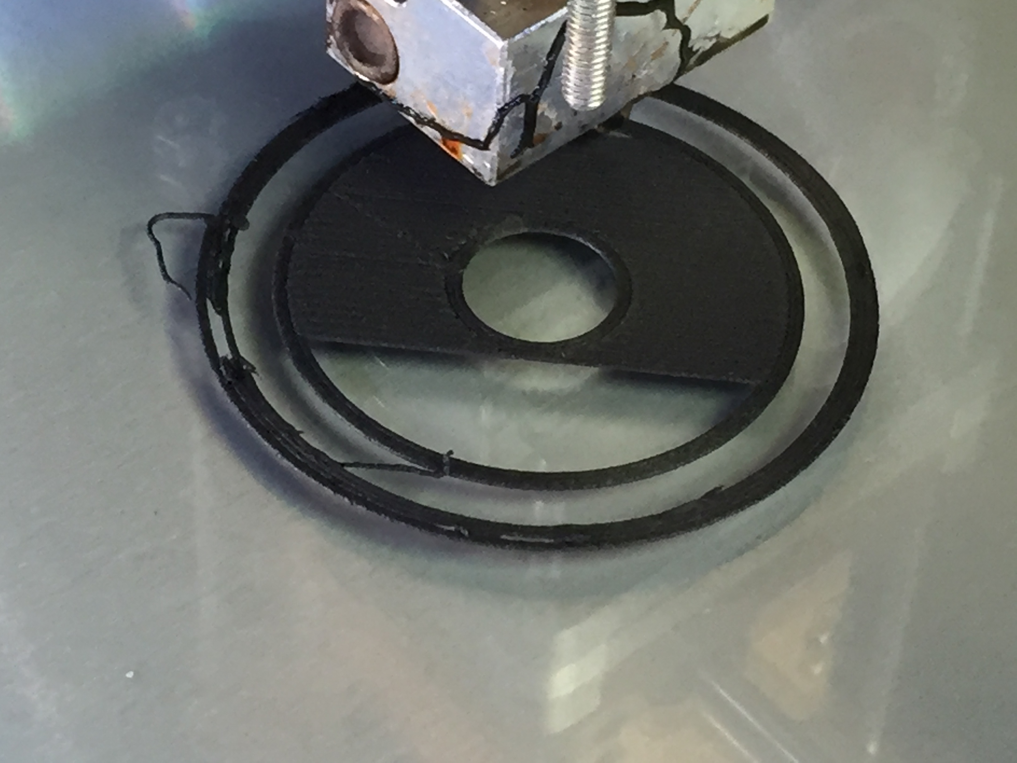

Well I had to adjust the bed height screws pretty high since my limit switch can't go higher. And wow this stuff can be messy. 256c seems to be the magic temp to stick to the build plate
Here we go!

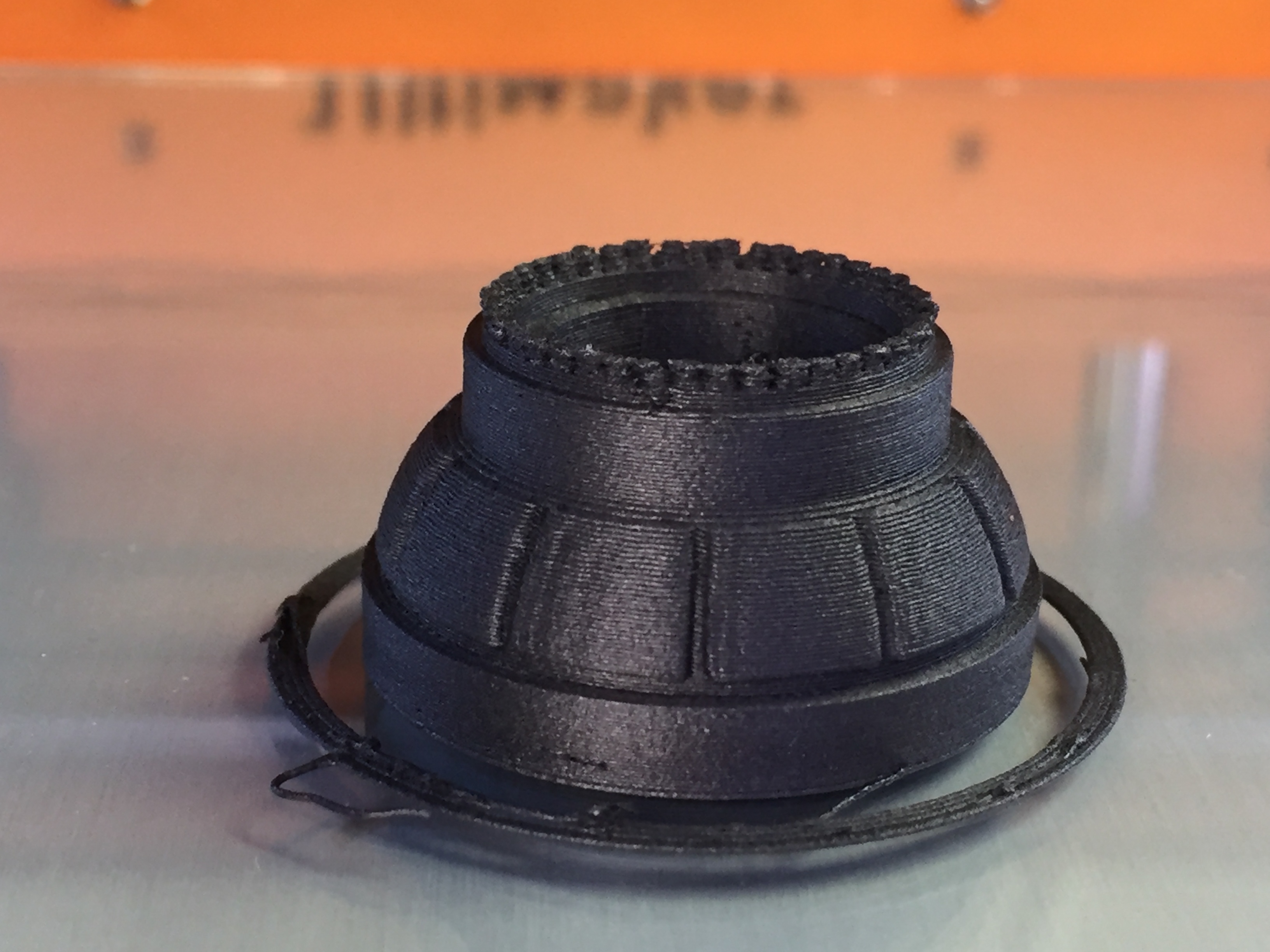

Noticing a few little blobs inside but otherwise, looking great
Good news! Printed nice

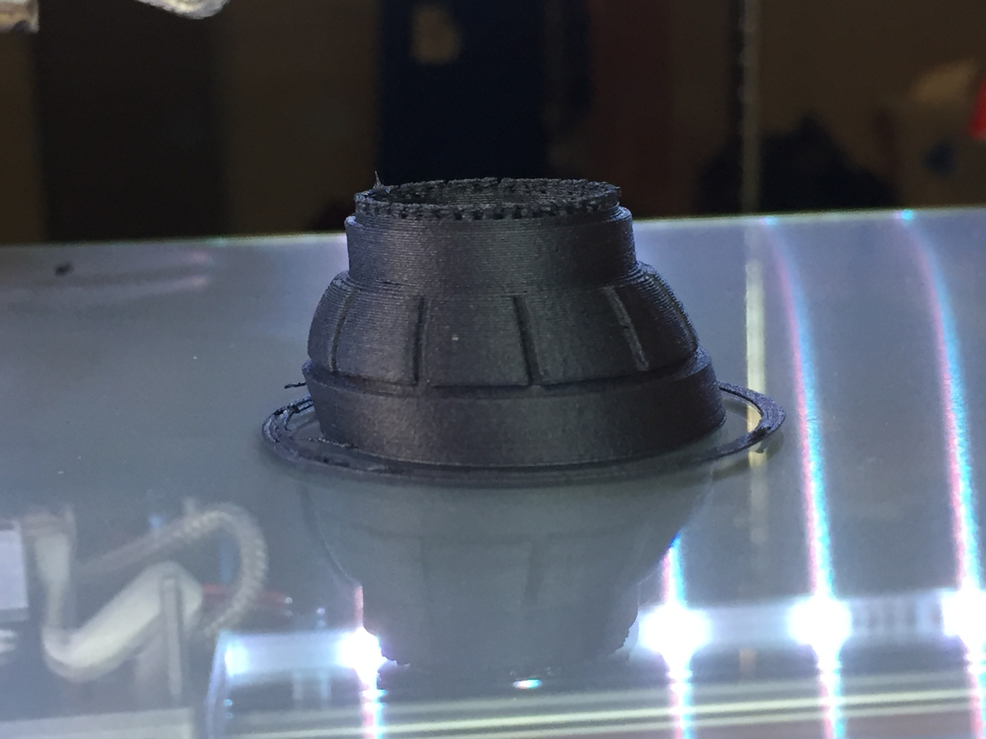

Bad news, my print is leaning backwards a bit
I wonder if the heated bed platform cover rubbing on the back wall is to blame?
View looking from right side. Here you see the angle

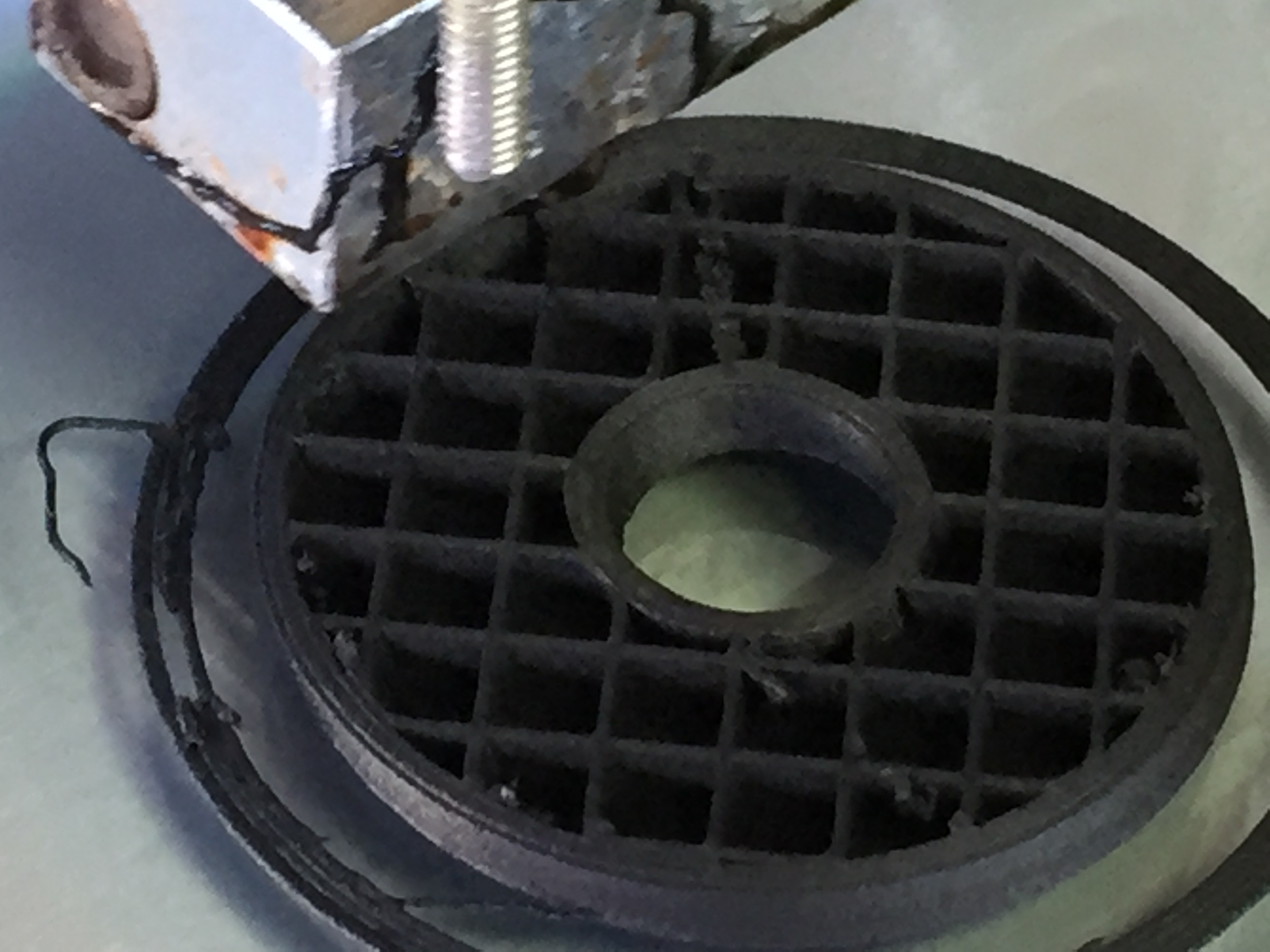

One last thing

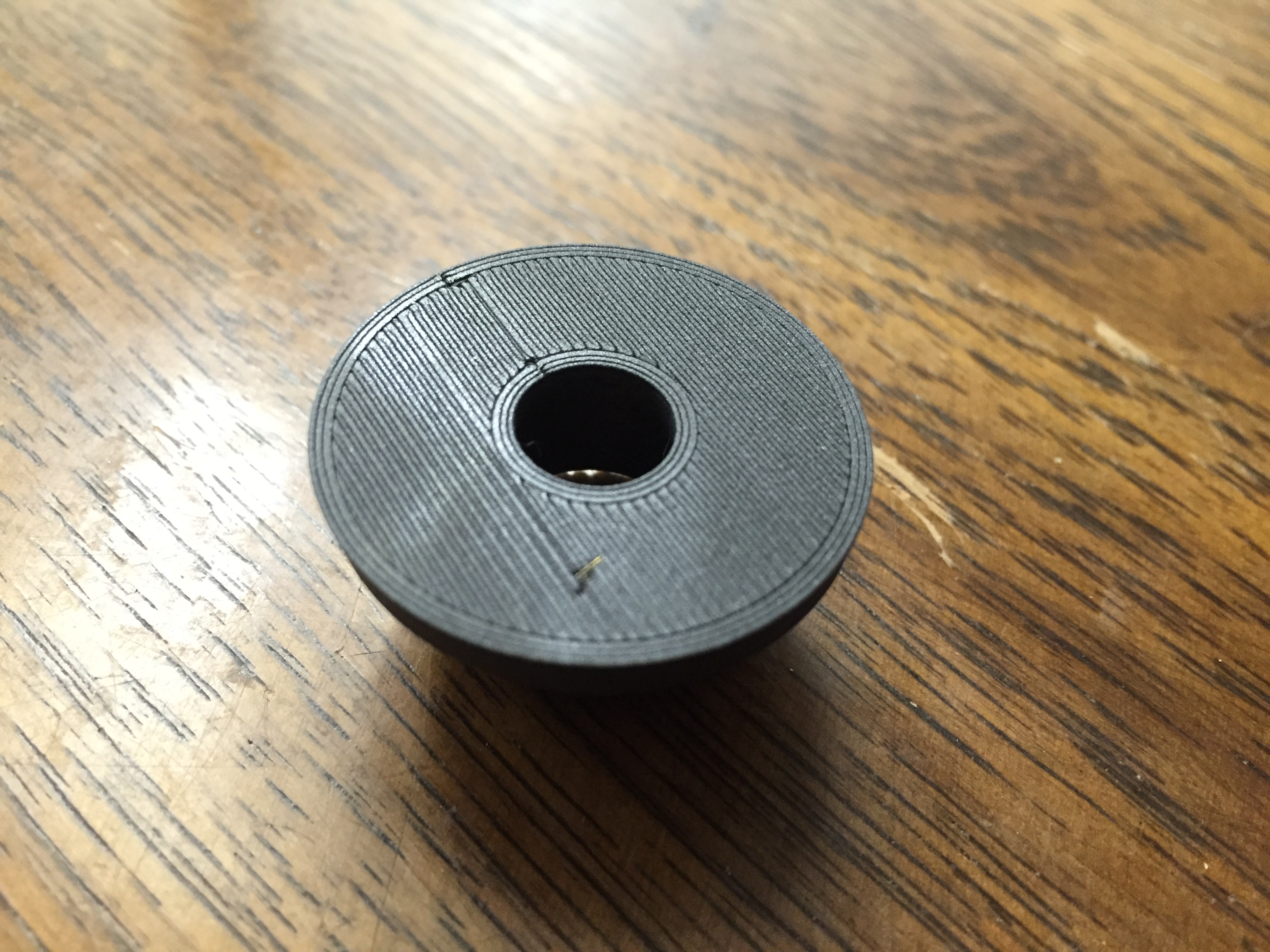

Bottom looks great!
