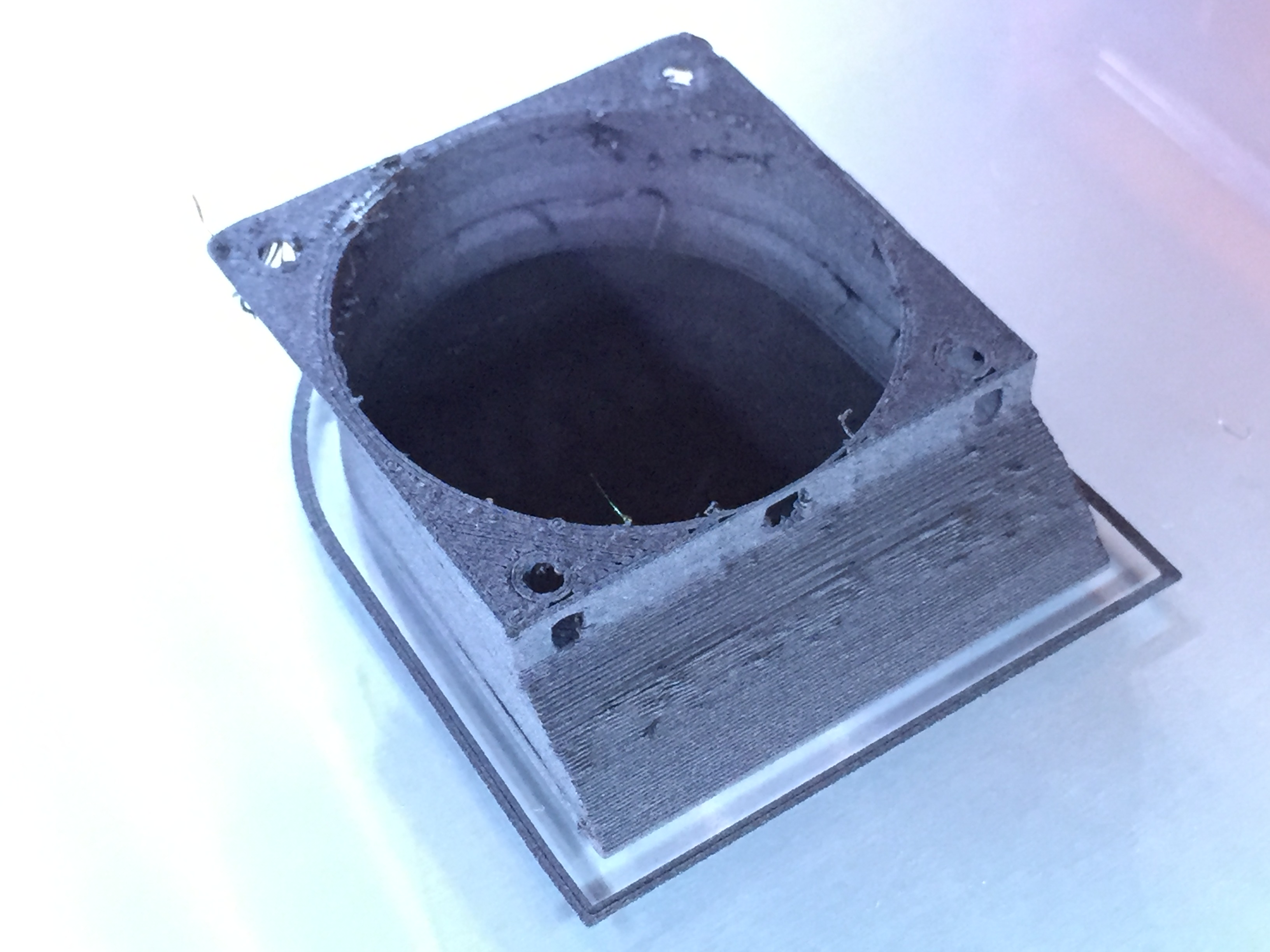

The first one, 15mm (only resize on Z of course
In PLA it prints without support, as is (flat) -- Upper corner won't be very nice, but it works; mine is here
The second one has the right size, need supports (for the front part) and preferably not in PLA as the 'nose' comes close the heater bloc.

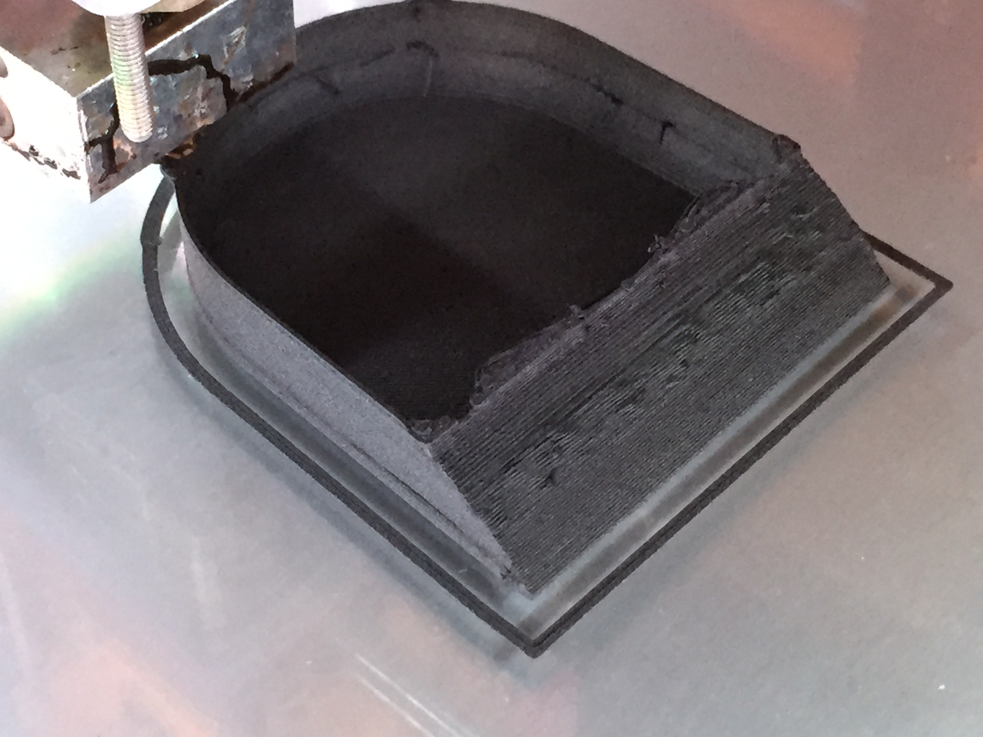

I'm hoping this comes out better than it looks right now

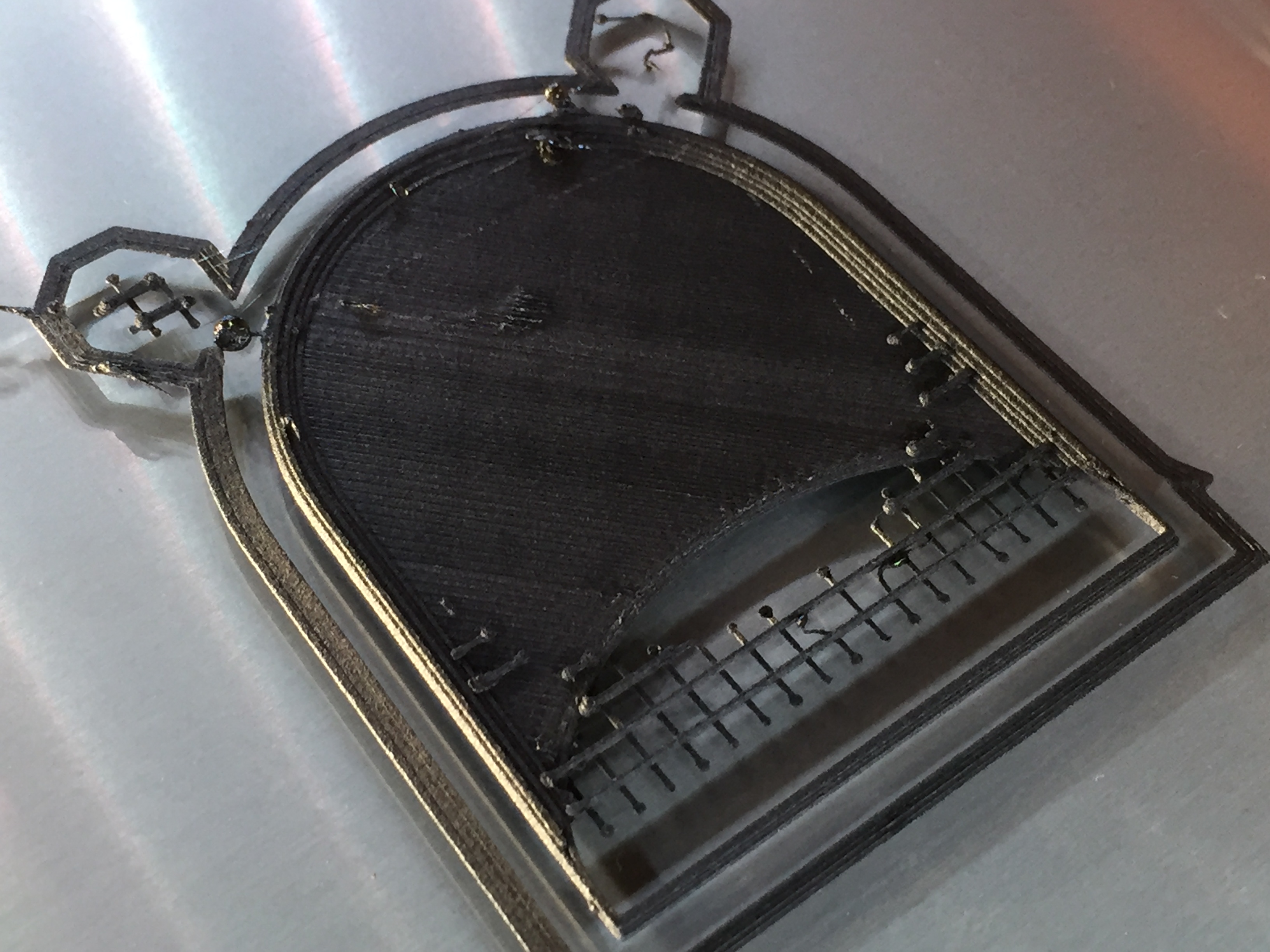

Well I tried it again with support material. That was a waste of time. I don't know if it's the retractions off or what but the support areas don't stay put and wind up being blobs.

I feel like I wasted a few hours tonight. Here's where a quit with supports that just wouldn't support anything but more blobs. As Amadee stated the first one is ugly but usable.

I don't know about cfxt but carbonfill can't bridge at all. But can do very nice 70 degrees overhangs. I posted all on the fancap info on ultimaker
Yes, I said 'PLA' and 'no support' for a reason, but you learned the hard way :p
I increasse the infill overlap to 20% (I use 25% but it makes more carbon around the nozzle) to avoid that gaps you have between the top infill and the circles of the screws.
Lepaul if you do read the post for dualfancap you might avoid all the troubles all together... The part about settings at least will give you a starting point.

What's weird is the bottom part was fine but then it started doing these retractions in the middle that caused blobs...and while what I have is usable, I'm a bit disappointed it went to crap

I did make the retraction and comb changes. And the first few layers went on really really nice.
