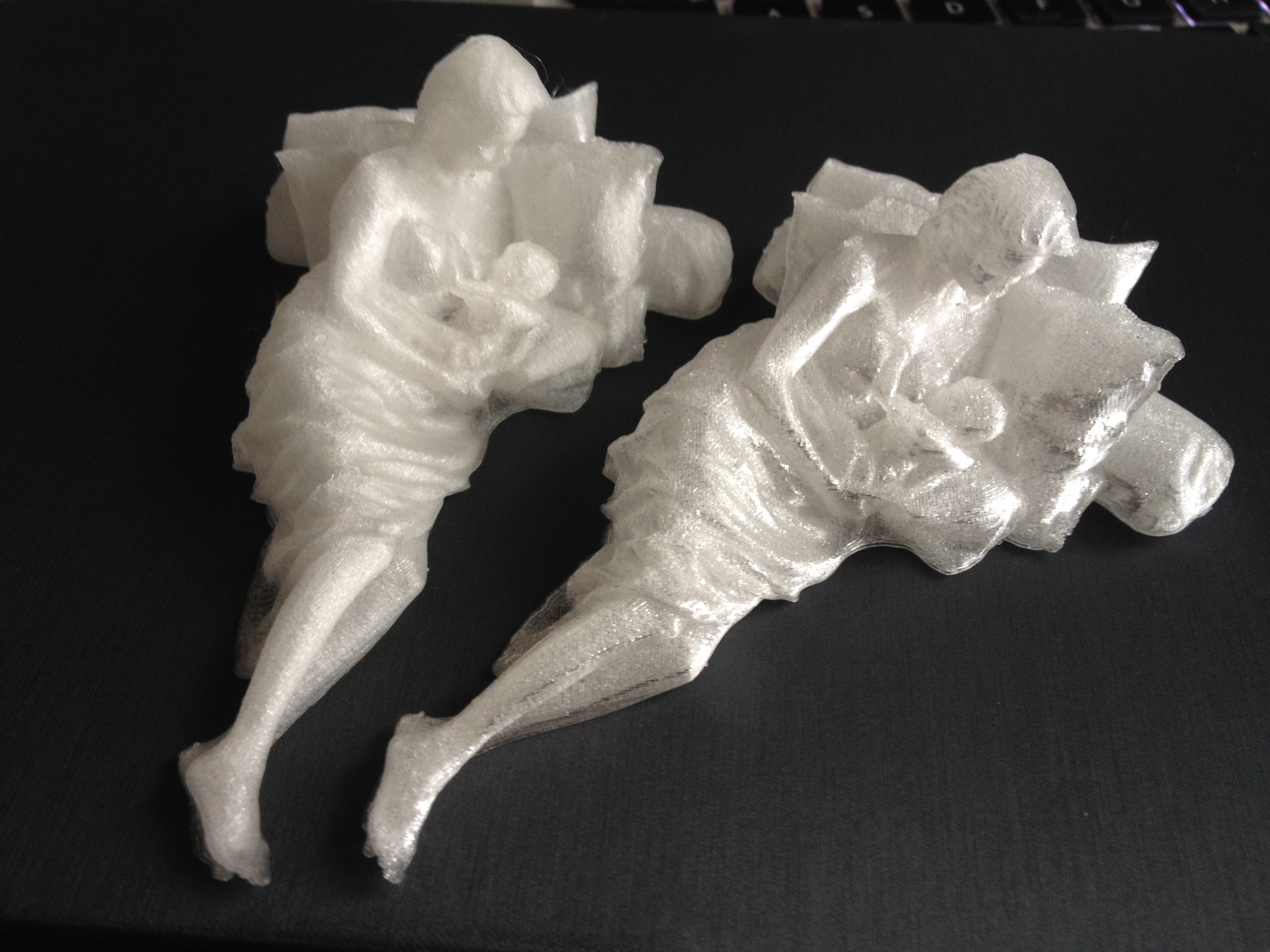

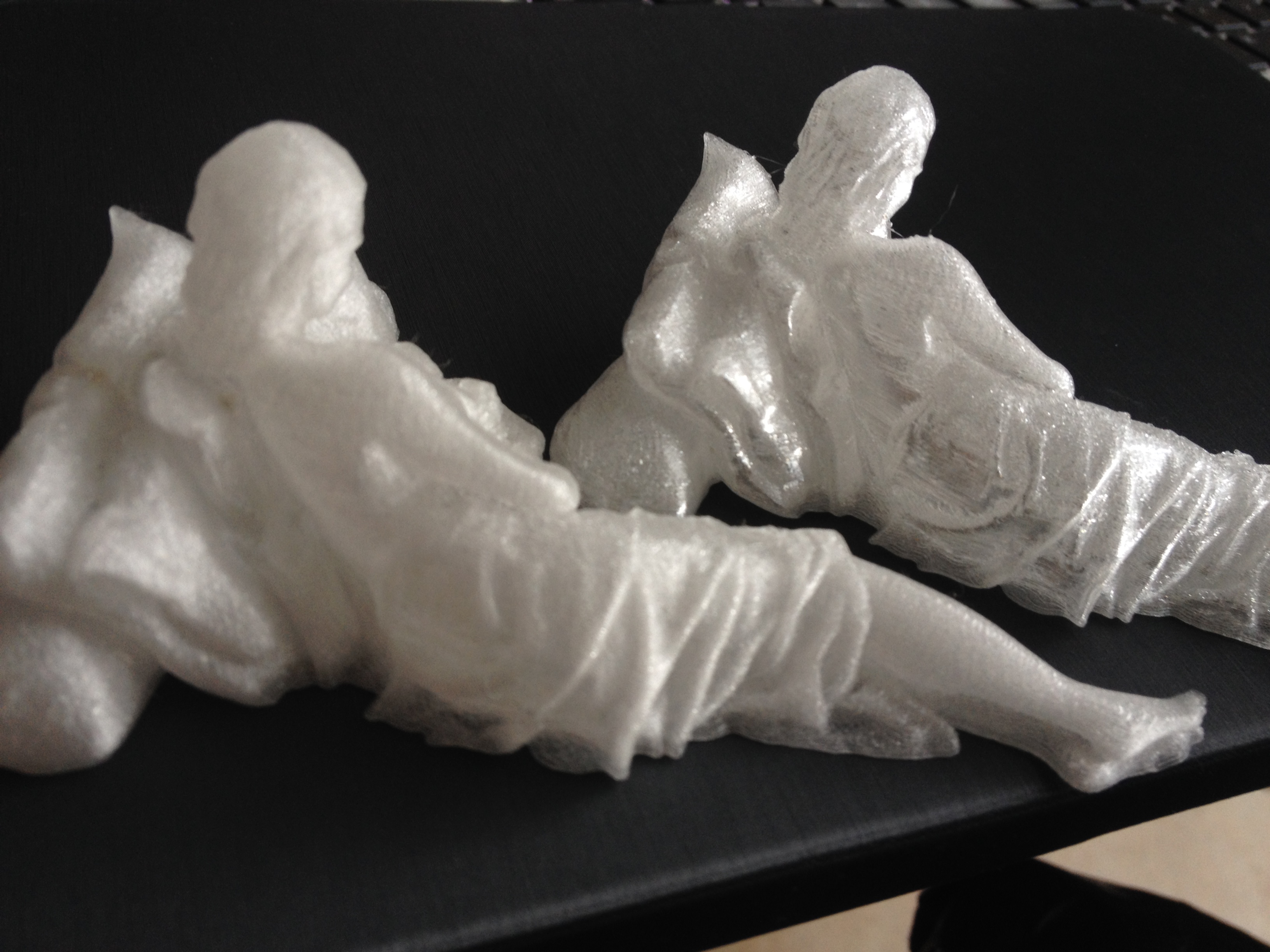

Finally had time to mount the ruby nozzle to my UM2Go, because I am using my UMO's with a 0.8 nozzle for bigger prints these days.
And there is a noticeable difference!
Printing in rPET the material is much more translucent compared to the brass nozzle and I could print cooler.....
Because of the material presets in the UM2Go I sometimes forget to change the material before, so the PET starts with the 210 degrees preset. With the brass nozzle the print would be white and start to suffer from the low temp, but the ruby nozzle would finish the print translucent with no problem..
Dialing to temp to 220 works great of coarse and the print had a more cleaner outside with less 'blobs' then before.

Thank you for the feedback, that is very interesting results indeed!PeggyB wrote:Finally had time to mount the ruby nozzle to my UM2Go, because I am using my UMO's with a 0.8 nozzle for bigger prints these days.
I might have observed this effect myself too now when I think about it, but I just was not aware of that the ruby might affect the transparency of the print.

What I think you will find is the ruby version has much more air in the layers, which means that you have lower interlayer adhesion. The air refracts the light which makes the print shinier, which is a nice effect, but mechanically poorer.PeggyB wrote:Finally had time to mount the ruby nozzle to my UM2Go, because I am using my UMO's with a 0.8 nozzle for bigger prints these days.
More air? Please explain...that's interesting

I have printed several kilos of PETG with the gorgeous ruby nozzle as well as standard 0.4mm nozzles, and with a 0.8mm nozzle. After faffing around a lot with various temps and speeds, I discovered by watching the nozzle when printing that if uneven - essentially underextruded - lines were drawn, such as after a long retract, when the next lines were drawn over them they looked quite different than layers with better adhesion, i.e. properly drawn lines.LePaul wrote:More air? Please explain...that's interesting
So I set things up to exaggerate the problem, such as using the new coasting feature, and this appears to confirm my theory. The refractive properties of PETG exaggerate this effect, but it can be seen in hot nylon (such as Taulman Bridge) as well. Air of course has quite a different refractive index than PETG. So when you trap it inside the plastic, you get that silvery sheen effect. PETG has an incredible property in that when you have your lines being drawn very flat on top, i.e. well squished down, the layers fuse into a solid. I think it's because PETG retains heat far longer than other more common plastics. So when the next line gets drawn, the layer below fuses really well.
Having smashed quite a few pieces in the name of.....OK, it was fun....I discovered that the broken pieces had shattered as if they had been injected. The broken surface did not look like it was printed out of layers. There were no layers to be seen. It's quite bizarre, but probably something that contributes towards the incredible strength of PETG.
