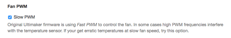

I have to check the Ulticontroller for the option Amadee mentioned
Re: Fan shroud upgrade
Post by Amedee »
LePaul wrote:I'll check the slow fan option in firmware first
I did get that version from your site
This one (From the experimental branch)
Slow fan
Slow fan

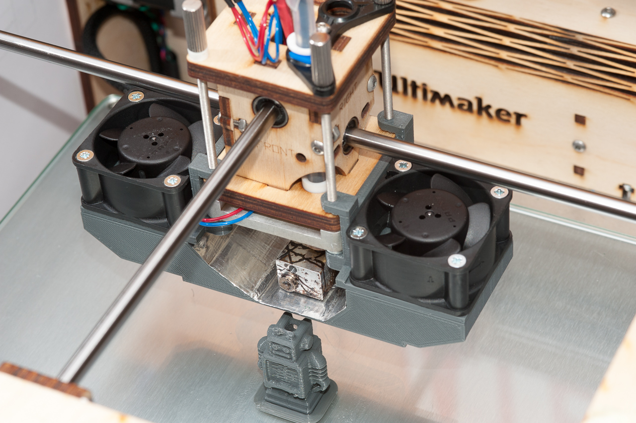

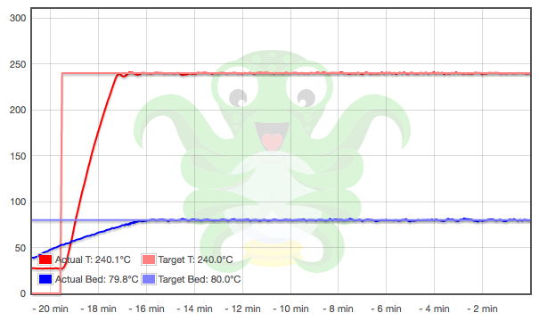

Running my first dual-fan print...
The nice thing is that when the fan kicked in, the temperature did not move at all!
Temp
Temp

The check how impacts on the hotend get the z near at 2mm. It will move. With the new design based on my um2 fancap it will move much less, I get a 2-3 seconds of 3-4C degress lost on um2.
Ofc I mean when hitting fullfan from 0 to 255 at 2mm. And um2hotend ises 35W so umo+ should compensate faster.

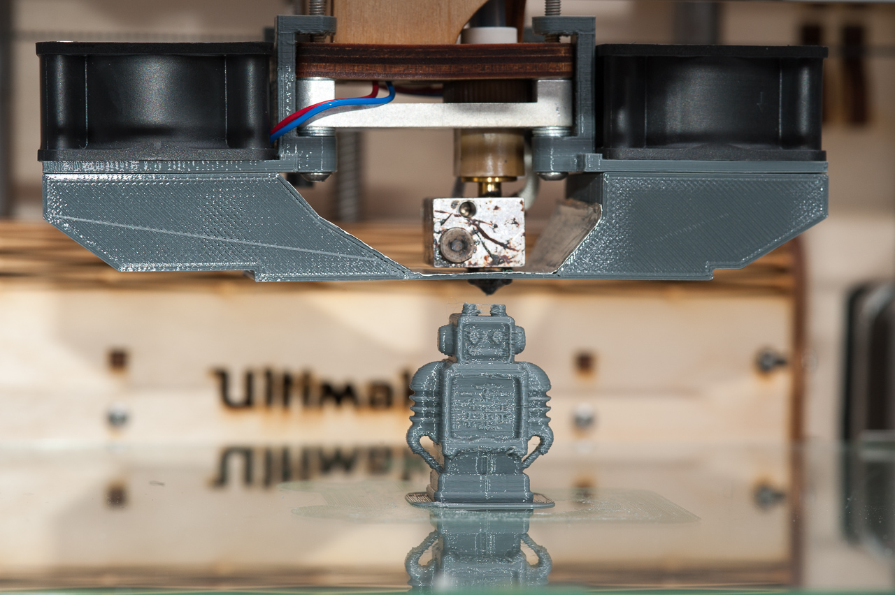

And here is the verdict:
First print
First print
Far from perfect, but quite good for a first try.
It is nGen, 240°C, 0.15mm layers.
The layer bonding is excellent, I can reduce a bit the temperature, that will improve the print.
Also this is an E3D nozzle with many print hours (including a bit of XT-CF).
The nGen shroud survived the first print, so that seems to be good as well.
For the fans I eventually used countersunk screws, that way I am sure It won't touch anything (I know the ISO screws would be OK as well, but I was out of stock ;) )

Looks great. I did my um2 fancap on ngen and I must say I hate the filament. It prints ok but it's like it has way too much flow (at 240C too), first time I get string on a print but ofc like any filament it need's tuning on the settings. Apart of that I dislike the filament because it can't be filled since it goes weird like abs but on the good side it can be cut with an exacto like if it was butter. Anyway used my free 10metter sample on the fancap and I won't be buying more of that stuff anytime soon. I'm more interested on the PLA-Tec filaments that go up to 120C and they are really 100% eco friendly. I got a weird asma attack when filing the ngen so my lungs didn't like the ngen too, I got to use a mask to finish the cleaning...
One more thing... I see your nozzle touches the hotend. I really don't know what's the best, but e3d recommends that the nozzle doesn't touch their hotend, I really really have no idea what's best. But On my 2 umo+ hotend I got better print quality (less blobs on retracts) when the screw part it's the one that limits how further the barrel goes in, like the hotend tutorial that was on wiki..

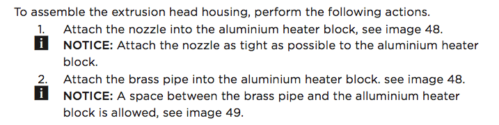

Re. the nozzle, the UMO+ assembly manual says:
UMO+
UMO+
But I agree with you, it is better to have the brass pipe deeper in the block. I did that on my UMO, but I haven't change it on my UMO+, I'll do it when I get the ruby nozzle.
