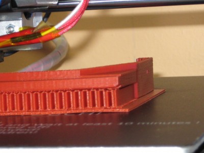

The image provided could happen in other ways.
I have had a similar experience when accidentally set the slicer to 3mm when I had 1.75mm filament.

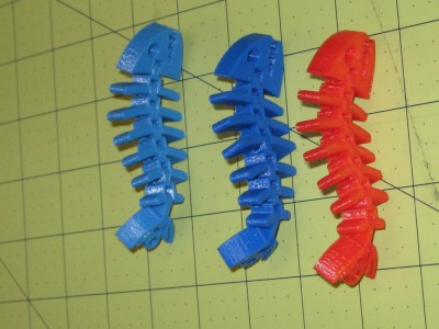

Which one is 3D Printed in ABS
Abs

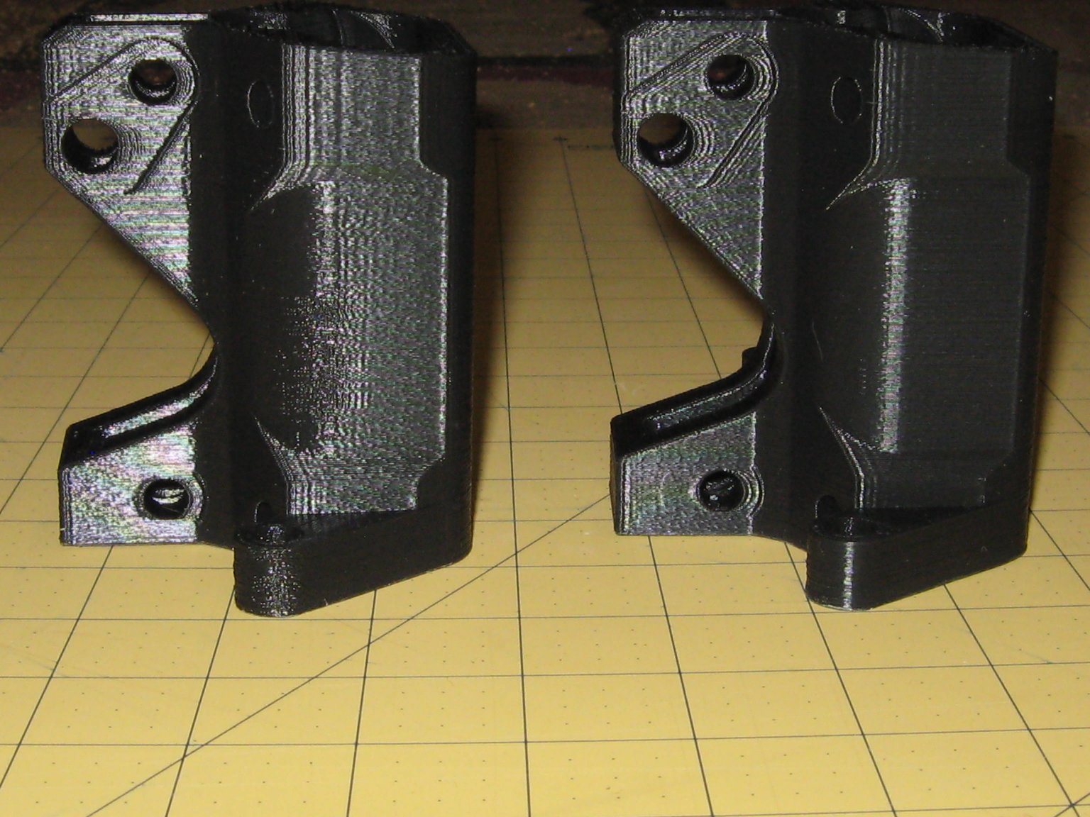

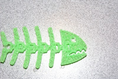

Octolapse vs SD card print Octolapse failed my Print quality
Octolapse has a fuzzy finish
These are all printed with s-curves and Junction Deviation for a smoother finish with faster print.
And Still I could make them smoother by increasing outer wall thickness.

At a guess I would go for the far left print.
Its amazing the difference printing from an SD card, I wouldn't have thought it would have been that noticeable! just go's to show the old tried and tested applications work the best.

It was the center Skeleton Fish. As in the images name.
It really floored me.
The only model that was fuzzy was when I used Octoprint - Octolapse to record tame lapse.
