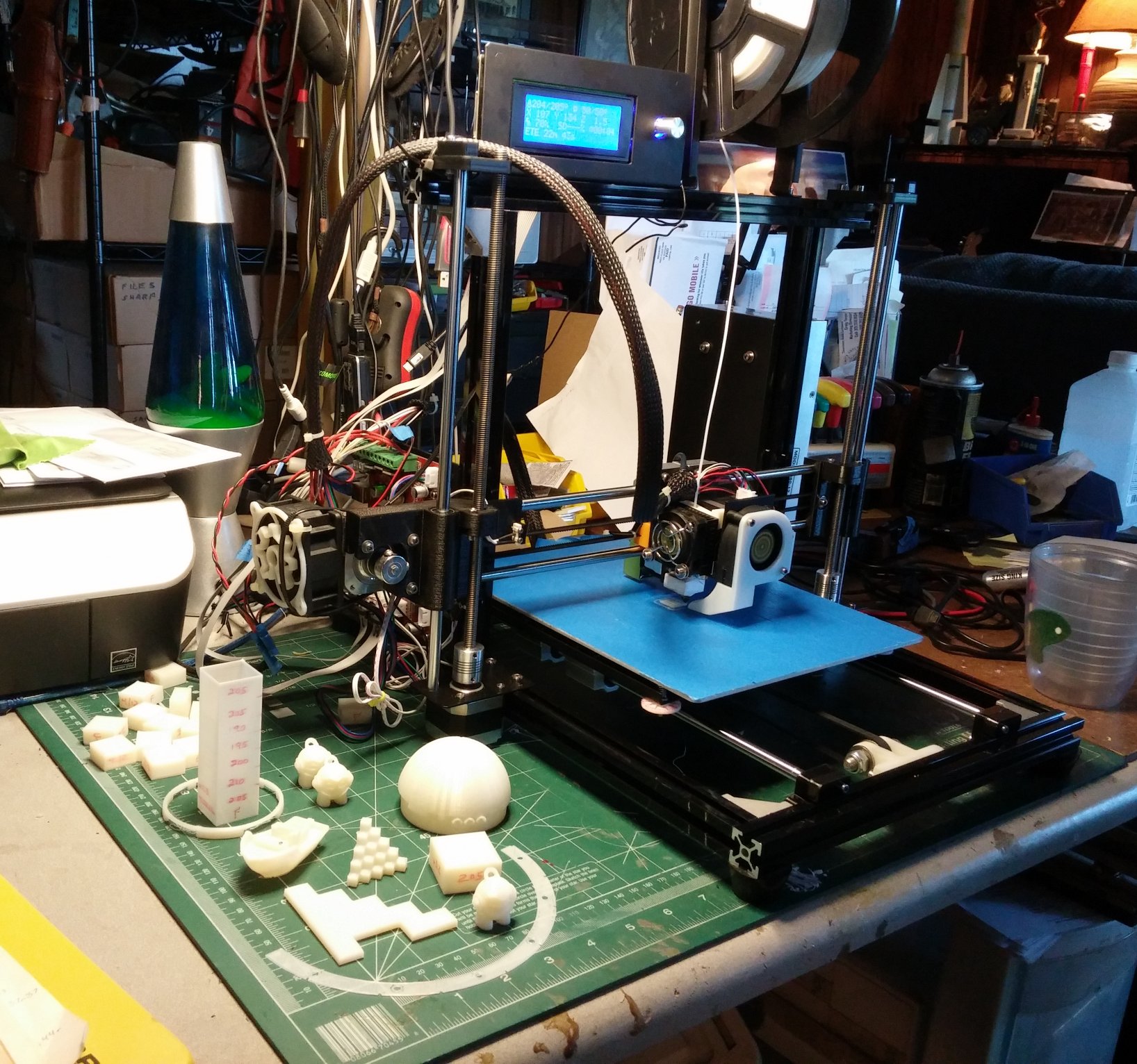

That's supposed to be a 20mm cube, before I aborted the print. I get the same results in both Cura and Slic3r, and it's pretty much the same on both RC4 and RC5.
It seems to extrude just fine, so I don't think I've got a blockage. Any idea where I should start with this?

I think the steps per mm on the z axis are wrong. Nothing a M92 can't fix.

Dim3nsioneer wrote:I think the steps per mm on the z axis are wrong. Nothing a M92 can't fix.
Agreed, extrusion looks OK it has to be the Z-steps. Paste your configuration file EEPROM settings. Here is mine, however I have stock 8mm x 1.25mm stainless (straight) z-axis threaded rods.

I found out that you can extract the default EEPROM values using Repetier Host program and having it load the EEPROM data so you can record it pror to re-flashing the board. I _think_ it works with EEPROM not enabled.
Source code/firmware version *should* not cause that, as mentioned definitely looks like z-steps in your Configuration.h file. What kind of z-axis screws are you using? Do you have 8mm x 1.25m pitch z-axis rods or lead screws? On-line calculators are available, I just don't have them at the time.
Again, extrusion looks like it's working, however have you calibrated yet?:
http://richrap.blogspot.ch/2012/01/slic ... s-and.html
also:
http://reprap.org/wiki/Triffid_Hunter's ... tion_Guide
And check out the latest Configuration.h file in this thread.
Don't forget to write your values to EEPROM when you get done.

I managed to work out that my steps per mm on the z-axis should be 400 and so far this is looking perfect. Yeah... So I need to learn how to calibrate my 3D printer... :D
When I get some time this week I'll take a look through the two links you posted, Chip.
Many thanks for all the help!
No problem glad to be of help. Remember, set your speeds low BEFORE calibration for now. If you do not, you will wind up starting calibration all over again, trust me:
- Feed rate X,Y (non-printing moves) max 120mm/sec
- Printing feed rate X,Y (print speed) max 60mm/sec
- Accelerations, default max to what I show in Configuration.h
Just read the calibration guide and after printing calibration objects you should see print improvement, if not re-calibrate and bore yourself printing out 20mm test cubes for a while. I scale them 200% to check bottom and top infill and print quality. Good luck.
Cheers,
