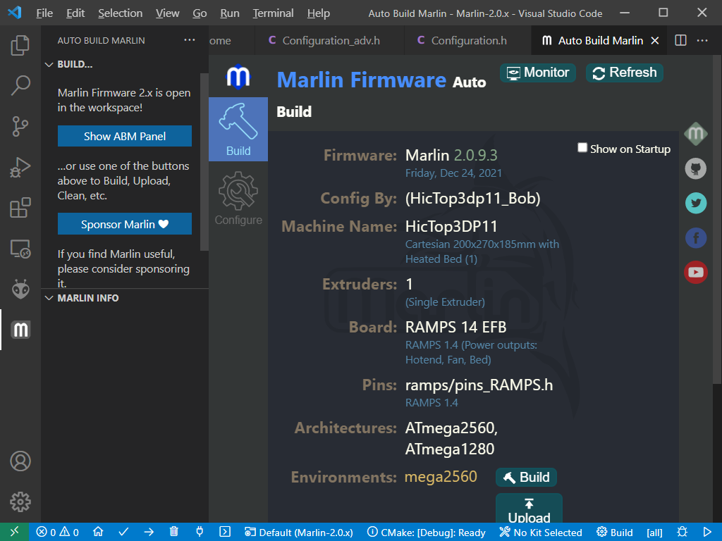

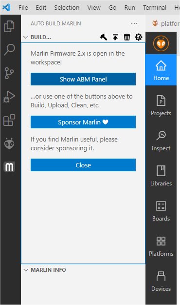

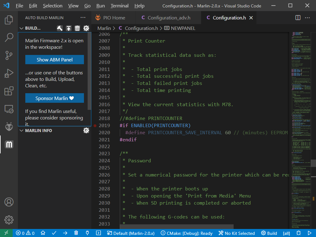

Re: HicTop 3dp-11 installing a BLTouch as a NewBe
If your firmware is not working after you compiled an flashed it to your 3D Printer then lets look elsewhere.
You are using Visual Studio Code > PlatformIO > Marlin Auto Build to compile does your screen look like these.
Click Marlin file to compile
Click Show ABM Panel
Verify the information below then
Click Build
Click Build

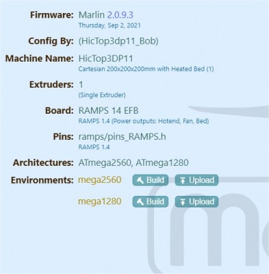

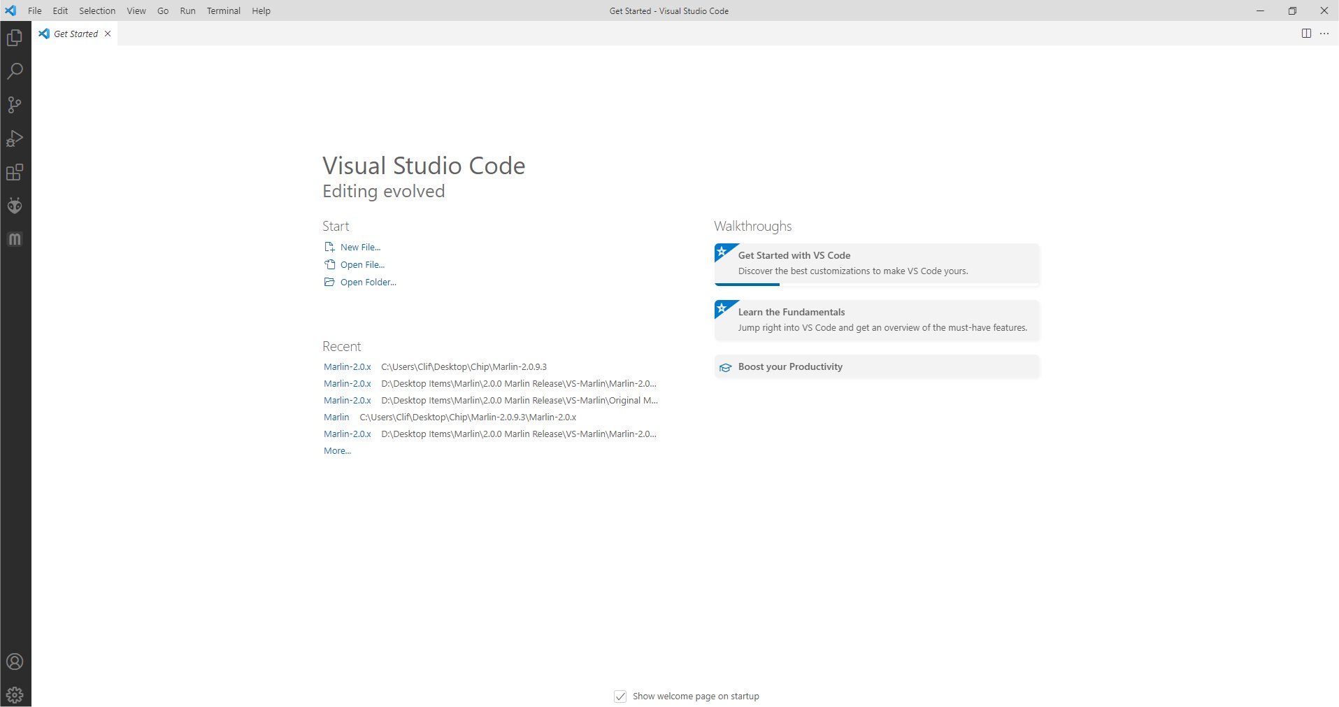

Here are my VS Screens:
As inquired previously I do get a warning on compiling. Here is the warning I get on compiling. Could that be a problem?
Marlin\src\inc\Warnings.cpp:554:4: warning: #warning "Disabled CONFIGURATION_EMBEDDING because the target usually has less flash storage. Define FORCE_CONFIG_EMBED to override." [-Wcpp]
I know i must be missing something, and I am continuing to look. Any additional help would be appreciated.

Will load on my Spare MPK_V1
I believe this is the same as your controller correct.
Then I will do a much as possible to verify its functionality
Setup your configuration_adv.h and Configuration.h files compiles.
Give me some time for testing.
