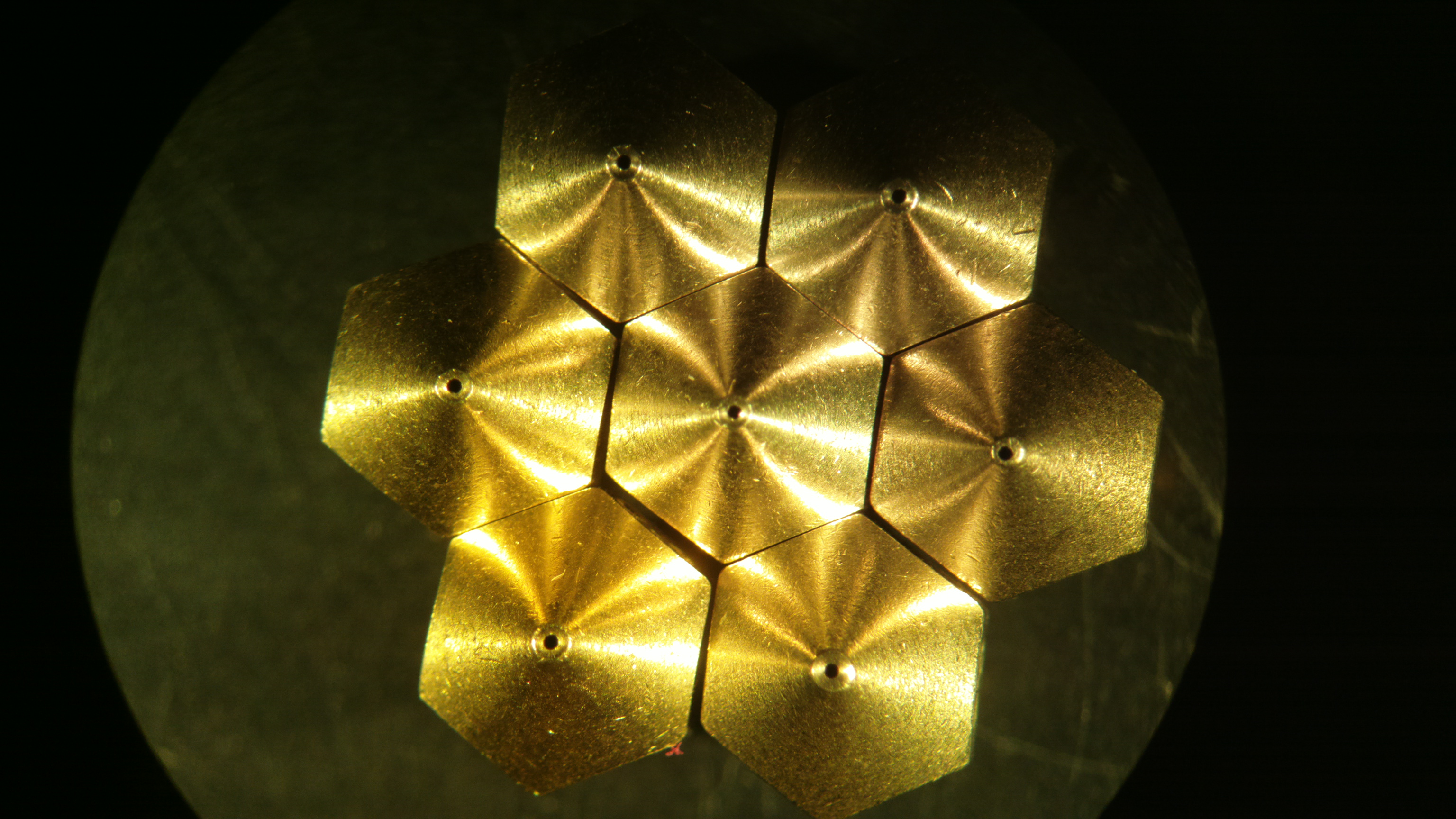

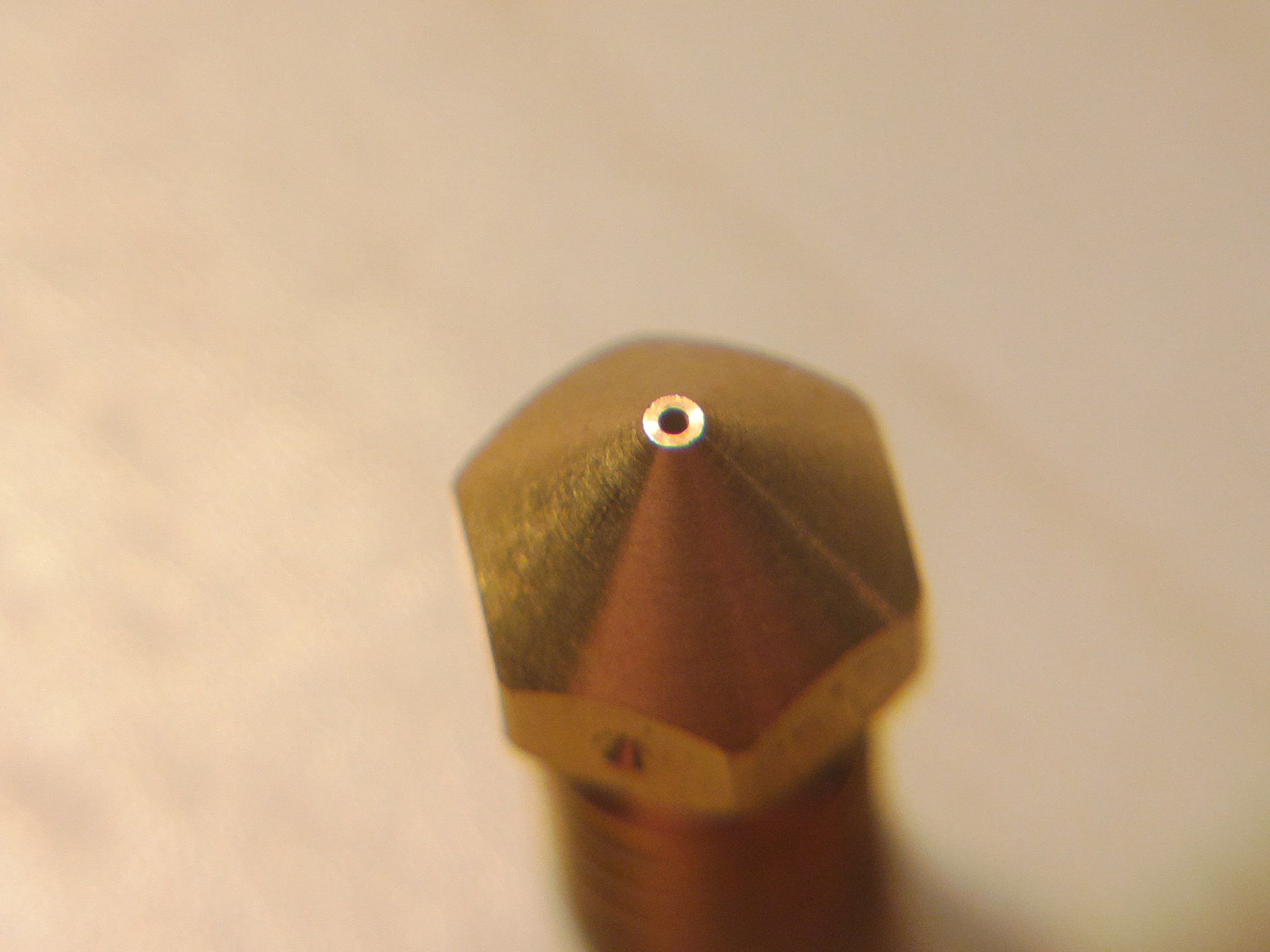

Regarding printing quality, the ruby tends to print slightly better.
Some materials appears to benefit more than others from the ruby though and how much difference there is of course depends very much on the condition of your reference brass nozzle.
Some of the early brass nozzles were really bad, we eventually had to change manufacturer to solve the quality issues.
Old manufacturer:
New manufacturer:
