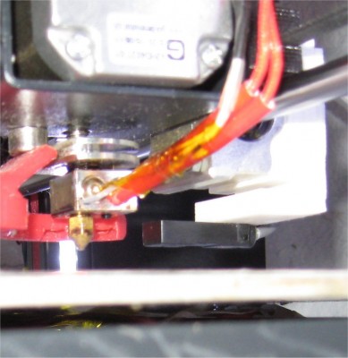

Using the mount from thingiverse, attached to the linier bearing. It does not work as good adjustable mount as I would like. I have it set at a 3mm difference from the nozzle. When I get the BLTouch working, I plan on doing my own design.

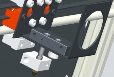

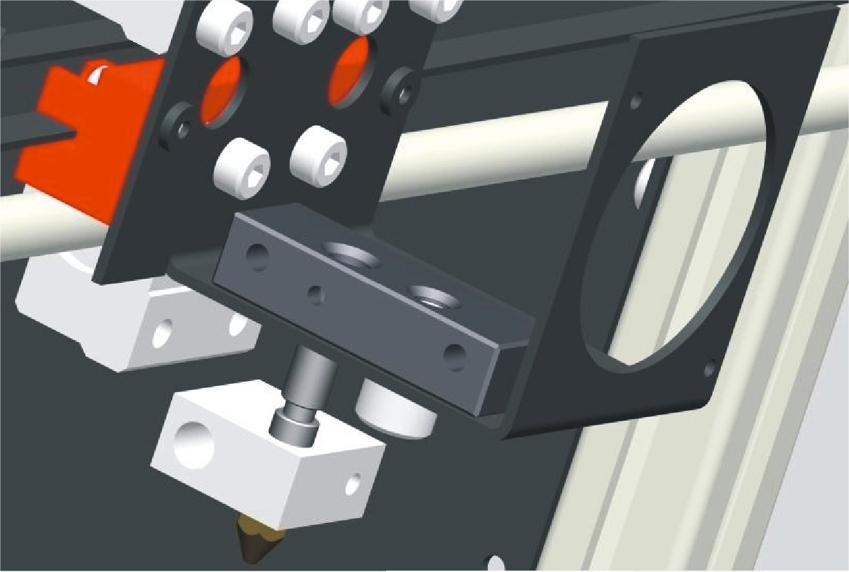

The Image Below shows the perfect location to mount a 3D / BL Tough on the stepper motor mount Aluminum hotend upper chamber.
Currently using New 3D Printer as my test Printer. May redesign using dual 10mm front fans duct to cool properly.
Will merely add a divider between parts cooling and throat cooling ducts.
I believe the Front Fan an duct should cool more than enough
