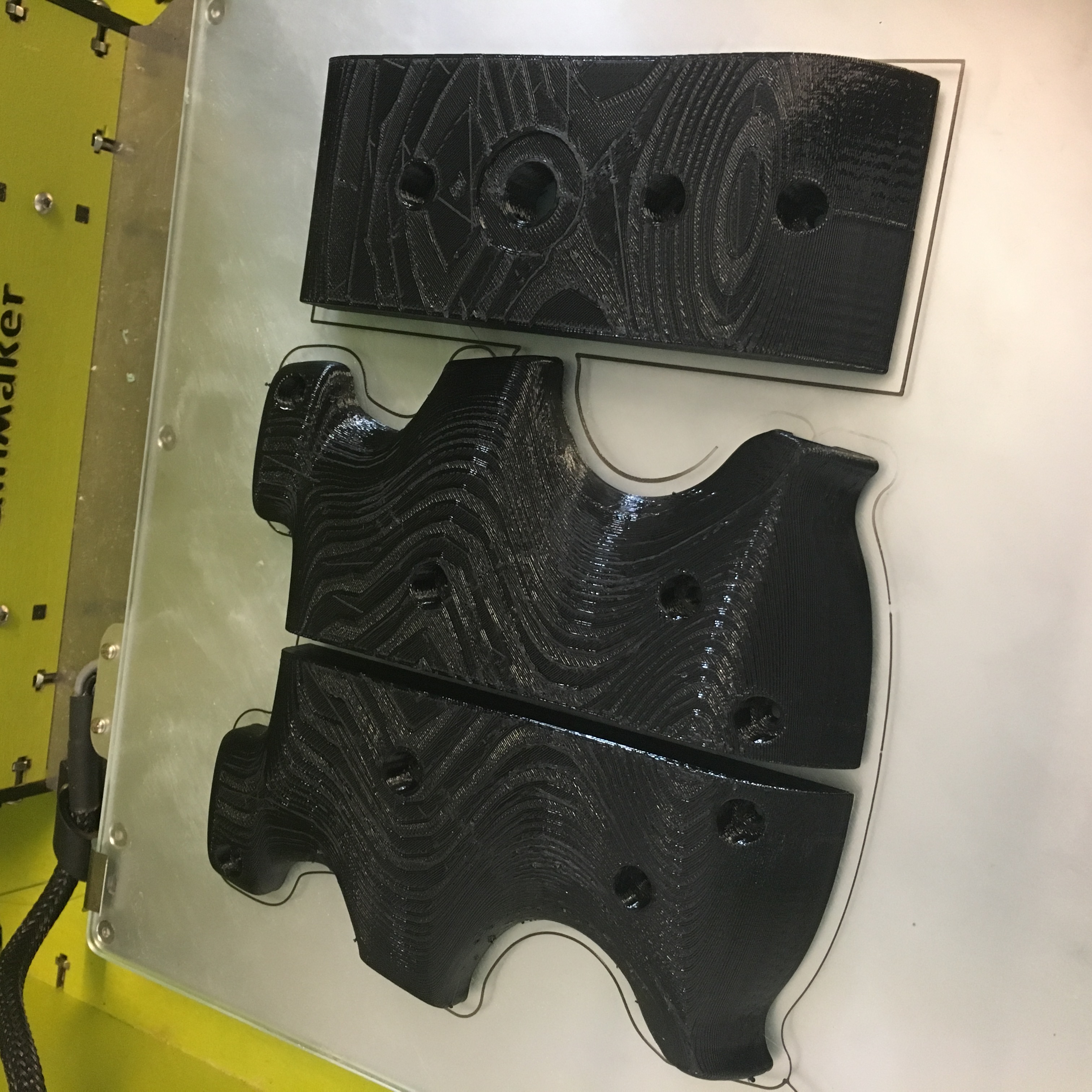

jonnybischof wrote:The F1 Steering Wheel...
First parts printed...using Colorfabb XT...layer height 0.2...first time I'm trying this filament.
The parts looks good and the hole for the rod is not too big, I think the play is ok.
Since the wheel is quite curvy on top it could benefit from lower layer heights...or ideally that you could print the top layers with different height. But for this application it will be good enough after some light sanding :)
I will try to summarize all I'm doing when printing/assembling once it's finished.

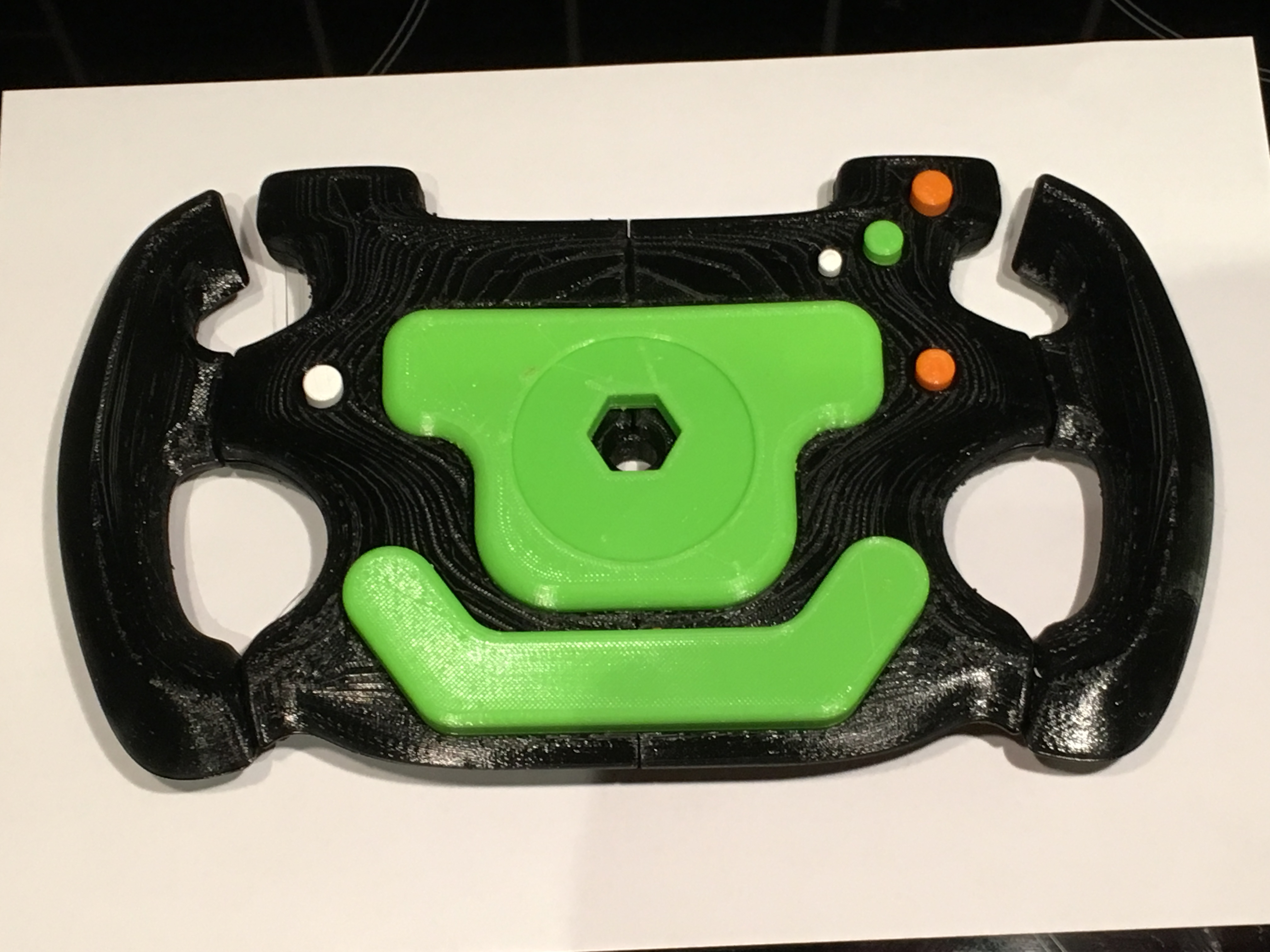

All but the logo pice printed and assembled for test...will sand and glue it all together for the final assembly.

Post by jonnybischof »
That steering wheel is looking good! I like the color choice.
