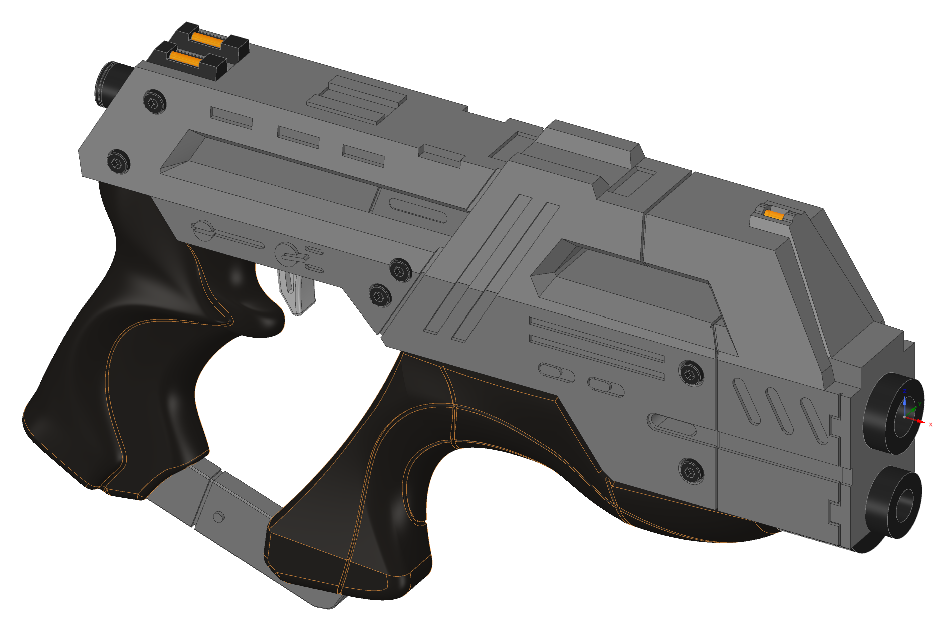

Got me a new project
Jess, the original creator of that particular design (Mass Effect Carnifex Pistol by Jessthemullet) was so kind to give me the step files so I can work on the thing myself.
Already added those iron sights with glow tubes (read: transparent orange filament bits) which should work pretty well. I adopted the Trijicon style which lets light enter the tubes from the top - making them brighter in direct sunlight. No actual night-sights since tritium-tubes are a bit hard to come by
Needs moar work to improve the assembly (Already put some M4 screws in place) and some bits here and there, but with Jess' files I could really start off on the right foot
(bottom parts look off since they are already sliced in half)
