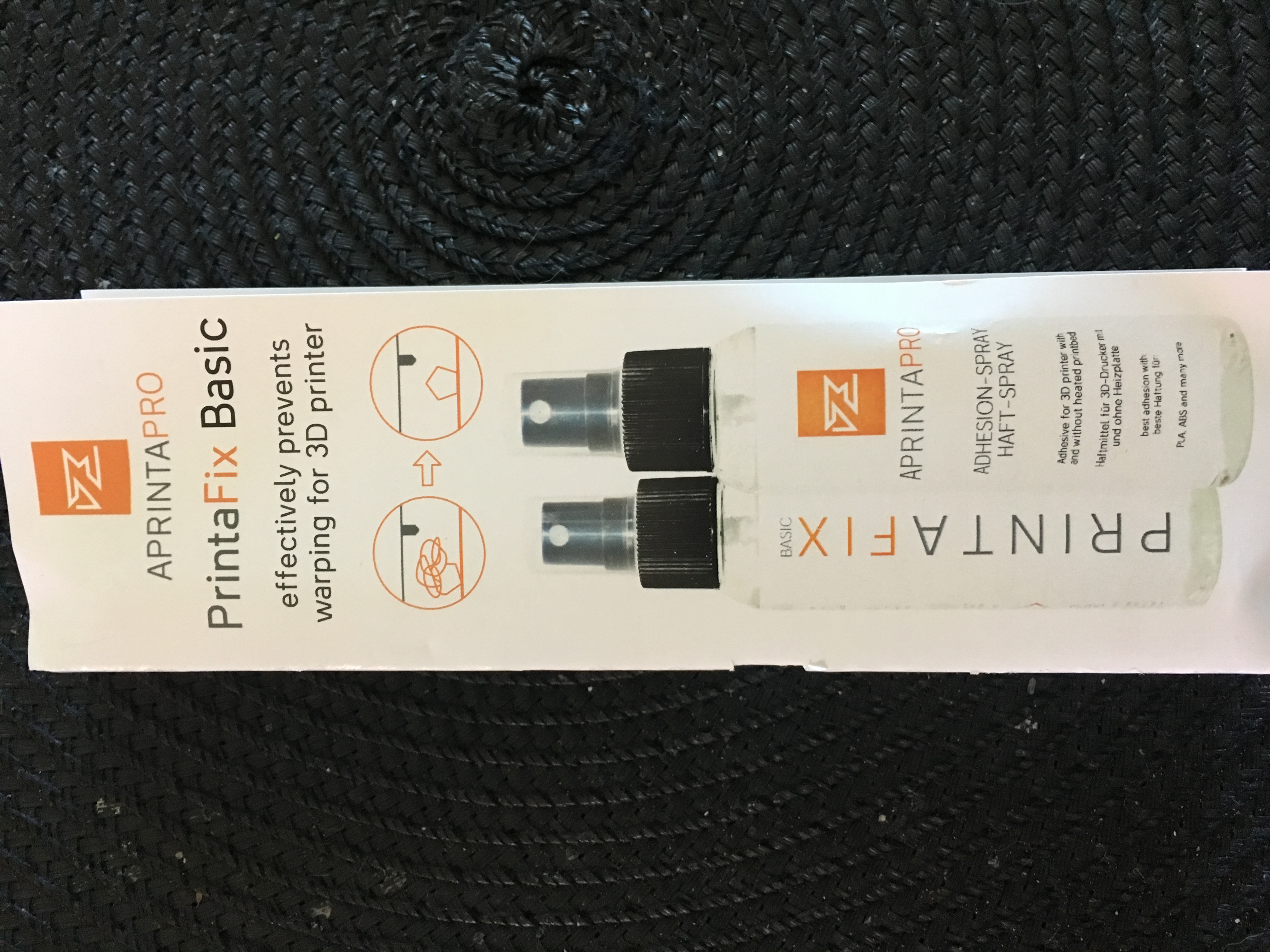

Received a gift with my belt-order that arrived today. Wish they would have sent something useful instead
PrintaFix is good, I use it when hairspray just won't hold!
It also works well on the printed too

I just don't like the idea to spray that stuff into the printer. Not at all... Most of it goes right into the linear systems. And I wouldn't wanna have to remove the build plate for every print (and spray it outside of the printer). Guess I'm happy that I switched over to my trusty PEI build plate. Everything sticks to it with no glue or spray or anything. And most materials come off by themselves when the buildplate has cooled down.
