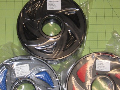

So 1 week ago I ordered 3 Rolls of ABS and to my surprise today they kind of arrived. (Picture below)
You will note that out of an order of 3 rolls of filament only Red and Blue are ABS the Black was actually the most important for my needs.
And you will note in the picture this one roll of filament that I needed the most is not ABS it is PLA now this is just my luck!

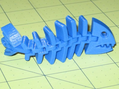

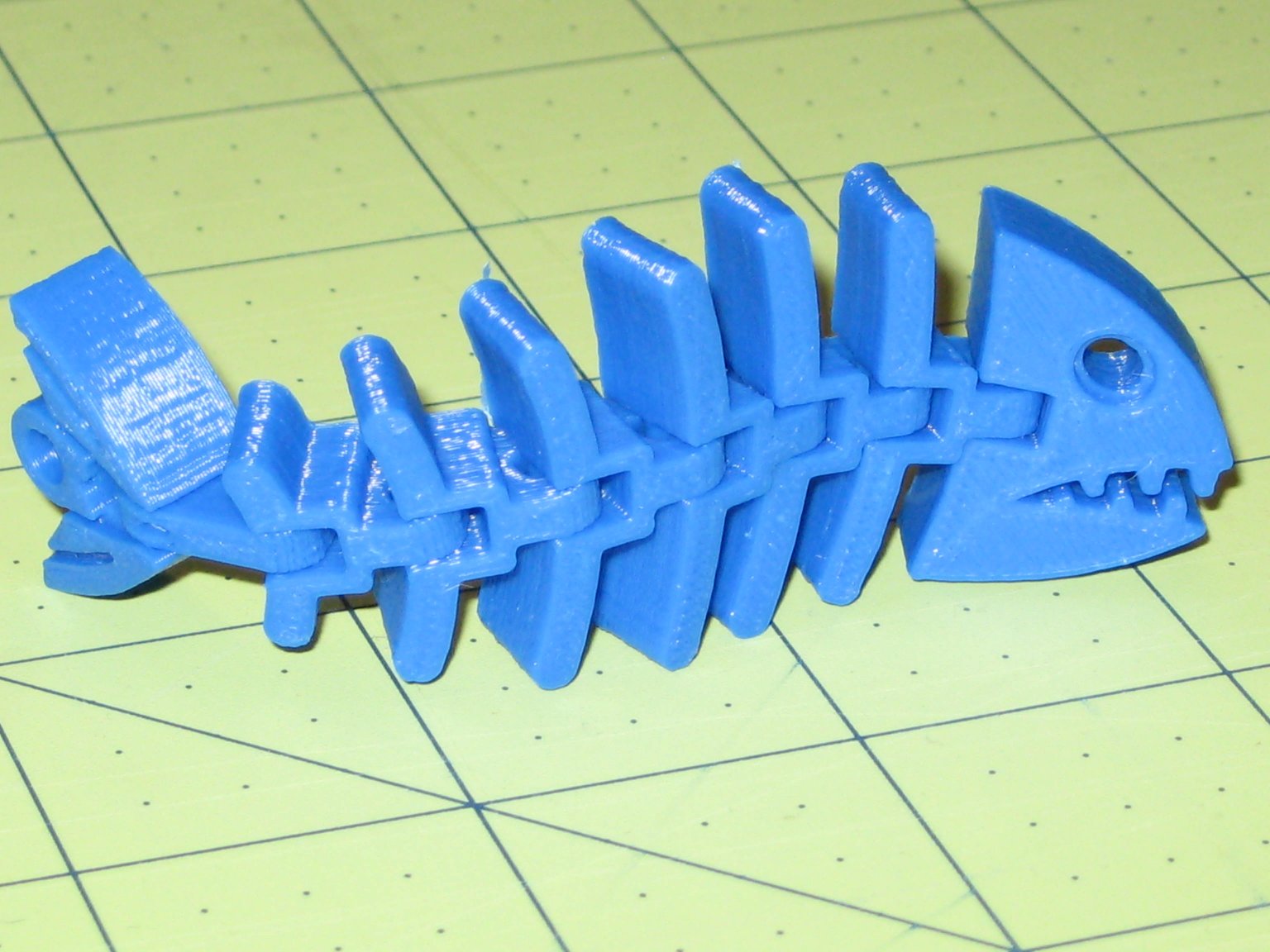

Well I wanted the first ABS print to be an average test, So I selected the Fossil Fish Key ring.
With tight corners, bridging a quick print time this was my selection for the first test print.
Setting the nozzle temperature to 130C the bed temperature to 96C fan speed to 58% started my first ABS Print.
Total print time 55 minutes. (Note this was with adjusting Speeds while watching the Print quality to My normal PLA print speed)

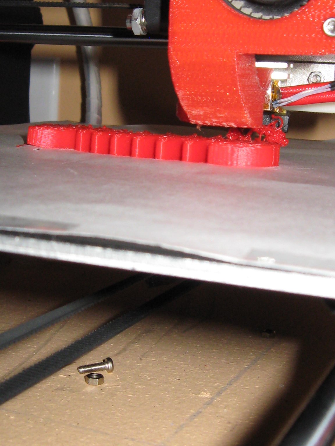

Spoke too soon Print Failure due to loose Y-Axis Belt carrier screws.'
The Y-Axis carriage moved forward dropping the hardware seen in the Photo. After that the Printing was over nothing but air.
Though what printed up to this occurrence would have been a excellent 1st Print in ABS for my 3DP11 12v 3D Printer.

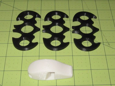

The Image of the 3 Bat-o-Rangs and the whistle all in ABS printed at 230C lowest Temperature on the ABS filament Roll (230-260C).
Same as the First ABS Print however the ABS on that roll temperature was 210-240C. All part are as they came off the bed no cleanup.
As I was in a hurry the printed item were a little to high so all did not lay perfectly flat on the bed, they all experienced a little edge curving about 2 layer worth in total warp .56mm.
Not to bad for a really fast Z-Axis Height adjustment, on a bed surface material I rarely use to print on.
With all the experience I have had printing with Tape it has became a lot easier to setup with the build surface.
Changing from ABS back to PLA was so easy. From What I have heard was worried!
After printing with ABS while still hot I preheated again to ABS temp Inserted the PLA pushing until all ABS was removed from the PTFE throat.
Then I was ready for my Next Print Project in PLA, it printed as if never used ABS in 3D Printer. Saw no clogging or print irregularities on PLA Models..
