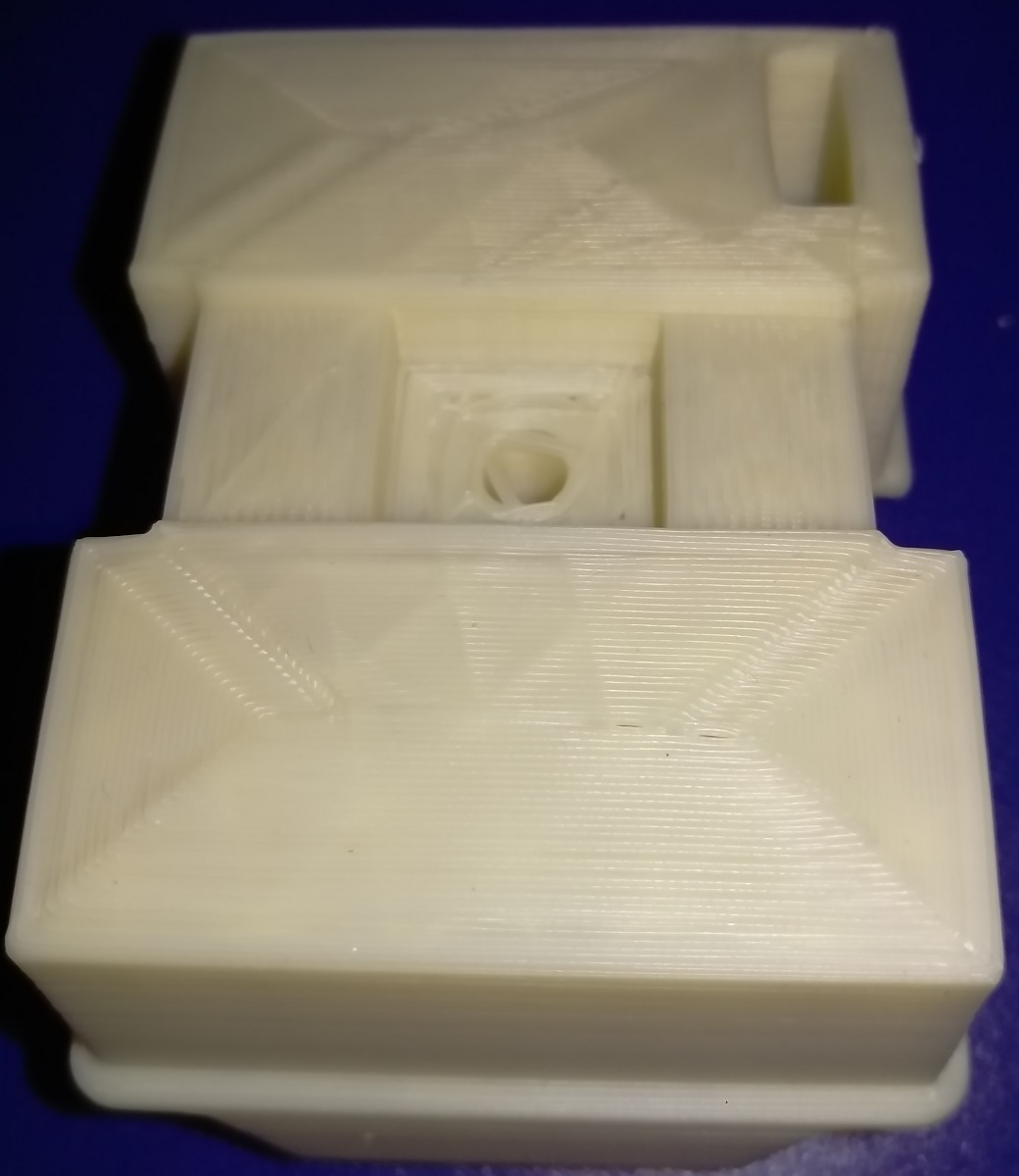

Hi,
I just joined this excellent forum and need help with the Cura settings and parameters.Here is the info:
Printer------Ender3 with 1.75mm 0.4mm Nozzle
Filament---ApolloX ASA 1.75mm (https://www.formfutura.com/shop/product ... tegory=116)
Nozzle temp--245 deg C
Bed temp--100 deg C
Slicer used--Cura and printed using brim option
My problems:

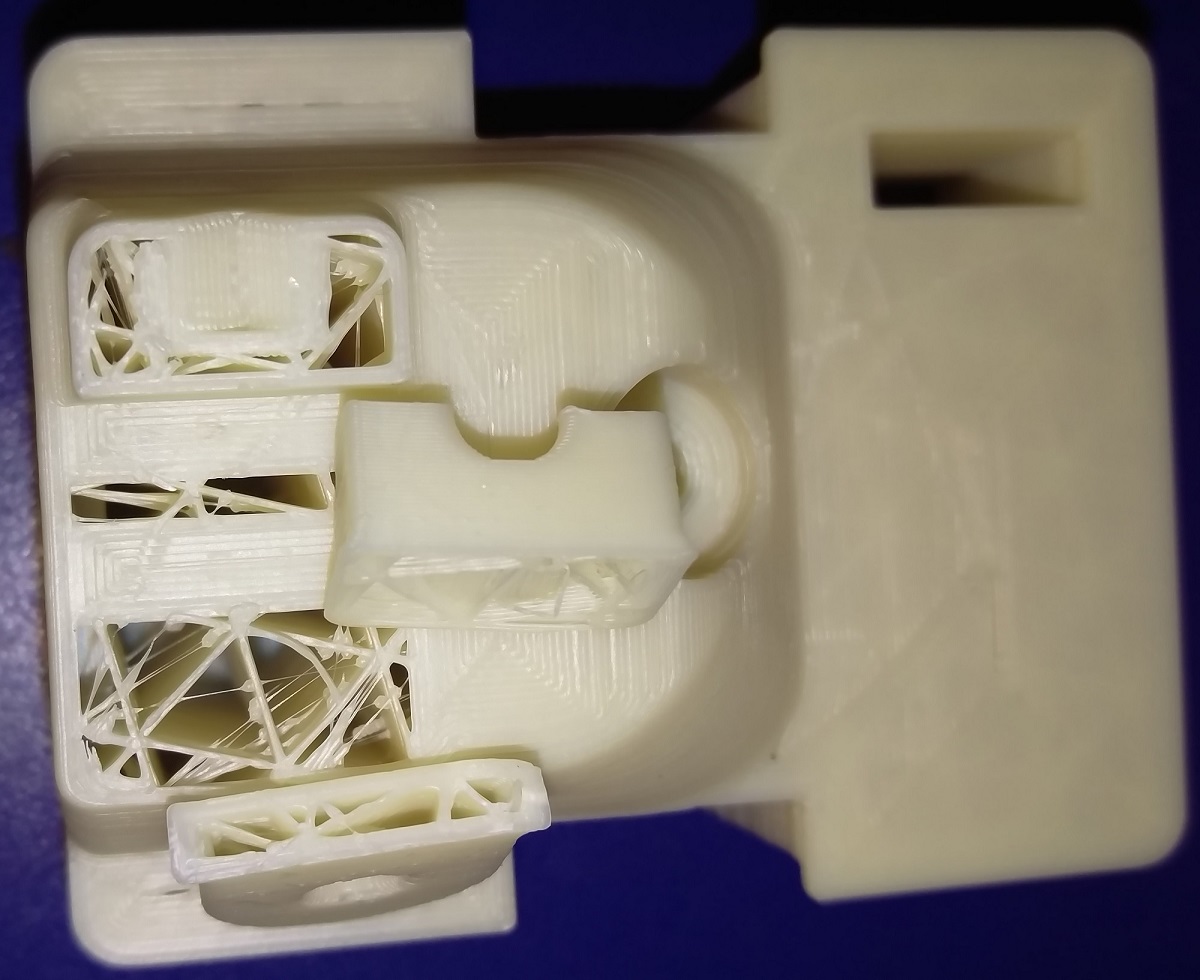

1)Part rigidity.Its top section is breaking easily as the wall section is thin.I want to make just the top section solid so that its more rigid (rigidity needed only on the top section where the grooves are).I am attaching the stl file and the pic of my printed part.You can see the top section broke with very little force.
2)Top and bottom layers are too thin.
3)Bottom layer finish is not good.But i found that surface finish of the brim is excellent.Its so smooth.
Please help.Thanks.

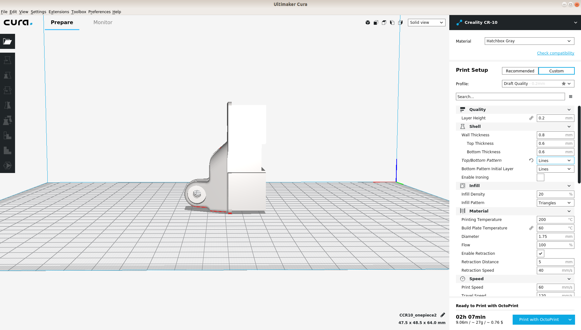

Looking at the images, it appears you are using a fairly recent Cura release, 3.4 or newer. The default (for what ever horrid reason) is for it to print top and bottom layers in concentric circles, which needs a lot of improvement (as you can see by the minute gaps in your surface layer. I would switch back to lines for top/bottom surface (you will need to enable Top/Bottom Pattern in the settngs - see photo). The other thing I'd do is flip the model on end for improved strength (see photo). You'll have to print on a raft, but that should be ok, just take a little more time to clean up.

Thanks a lot GrueMaster and LePaul for your reply and suggestion.It makes sense.I liked your idea of flipping the model to get stronger part on the top(where the hinge is).Yes i am using the latest Cura version.I will try to print it again as you suggested.
But last night i tried to print it with enclosure(enclosure temp 36 deg C) and got better results than my first try without enclosure.I found that part got warped from the bottom but top of my part was absolutely flat.I heated my bed to 105 deg.Could it be due to the bed being too hot?I have attached the pic of my part where it shows warpage on the bottom.
Hopefully i will get better results by changing the top/bottom layer pattern to lines and by flipping the model.Thanks
