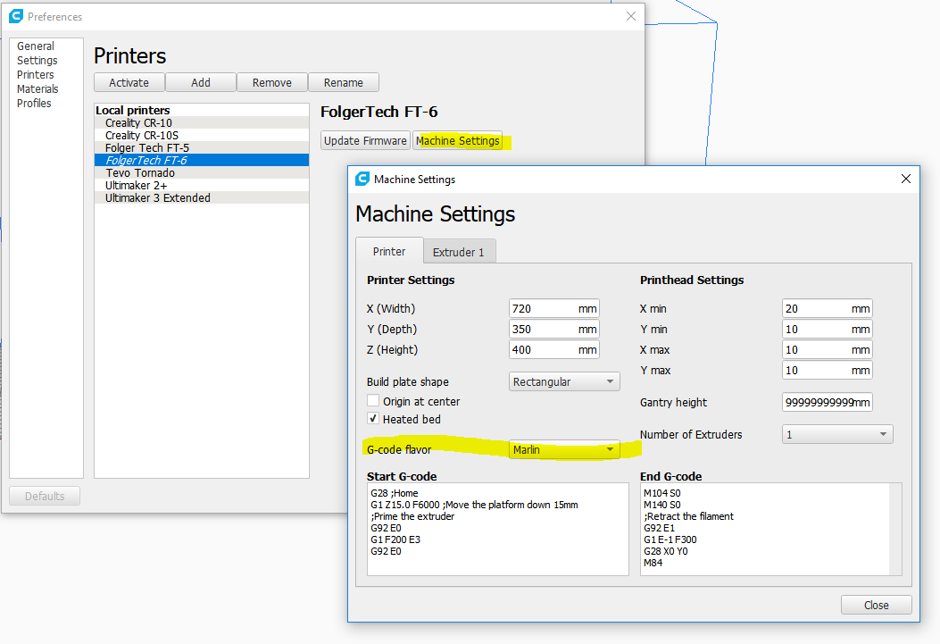

If you are using Cura 4.0, there is a printer profile specifically for your printer under 'other'. It includes start and finish gcode, which includes autohome (G28). Double check in machine settings that you have start and stop gcode set.

Make sure you have G code set to Marlin and you have stuff in the Start gcode
Re: Cocoon Create Profile for Cura V4
Yep it is on Marlin but a listing of someones START GCODE would be handy to copy or modify.
I guess there is more in your Start GCODE than what is showing on the photo?
