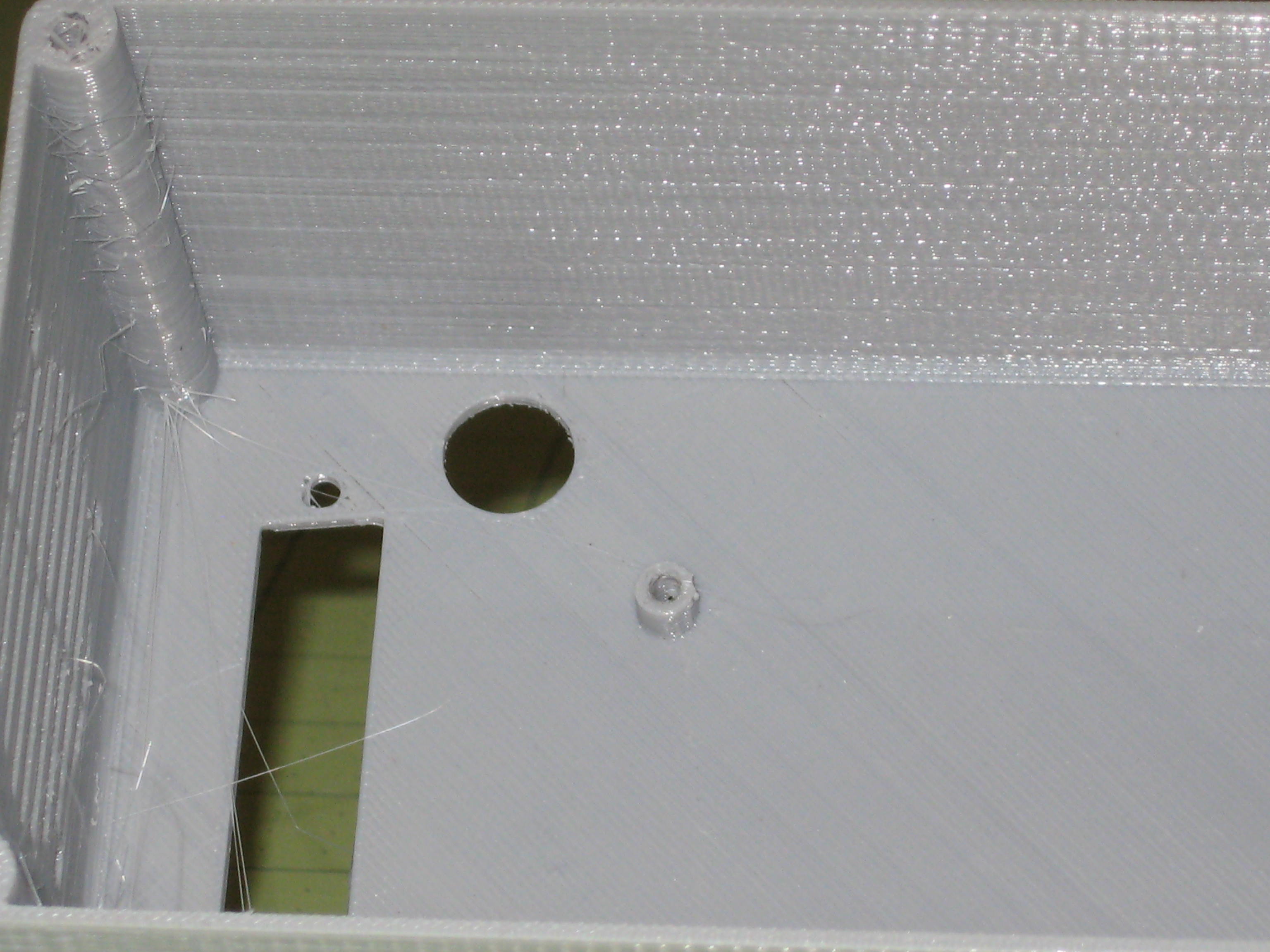

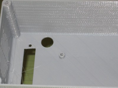

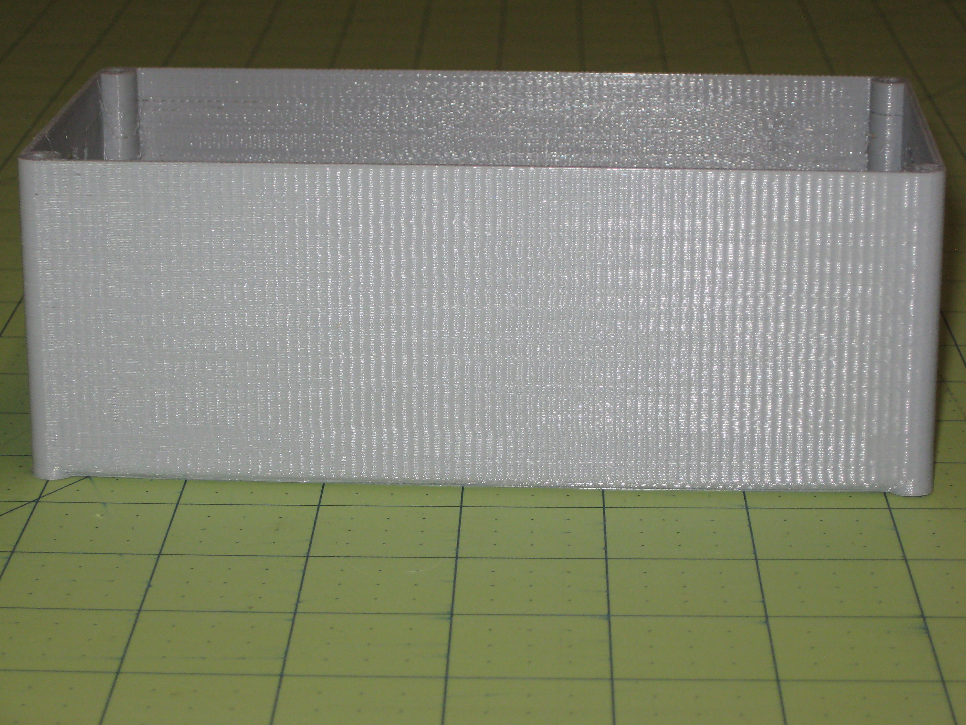

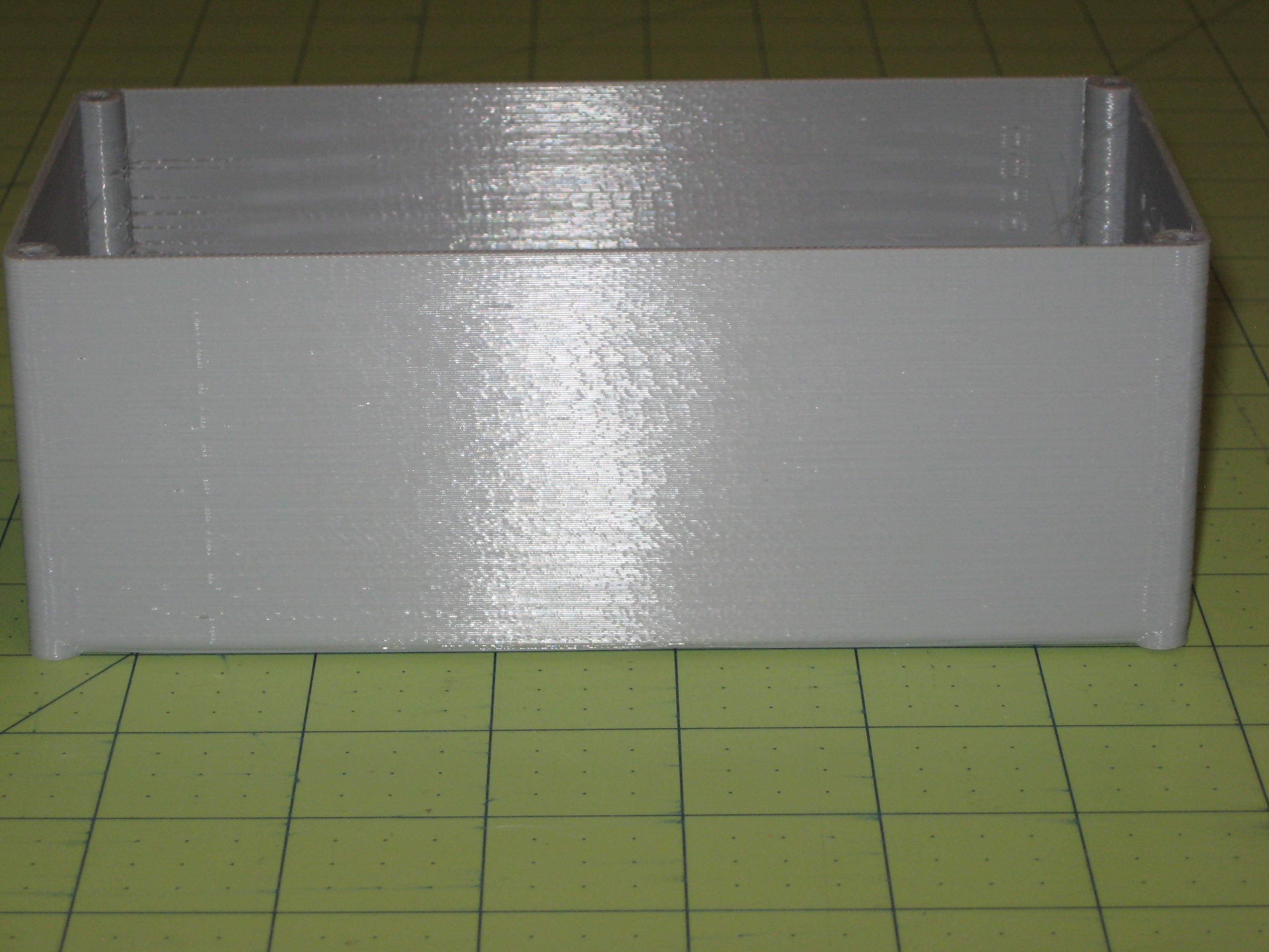

Today I pushed my Hictop 3DP12 - 3D Printer to the Ultimate test level.
Printing at layer height of 0.31 with a print speed of 12.4mm^3 per second.
Inside has stringing and under extrusion lines. Most likely because of Z-Hop, incorrect Hot-end temp and flow %.
The back wall has Artifacting from infill. Will fix by increasing the wall line count to decrease infill overlap.
The front wall has a distinctive start location.
Over all not a bad print, for the speed increase.
Any suggestion would be welcome.
