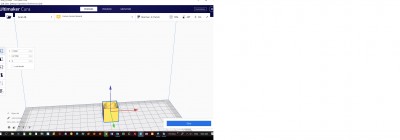

Good Day I have attached the ZIP file and I have also included a picture in CuraRoberts_Clif wrote: ↑April 21st, 2020, 4:40 pm7-Zip is a free program you can select the files to zip then attach them.

What does it look like in Cura if you select preview from the menu above the part.
Re: Printing as a solid when it should have an open top
I tried it looks like a solid.

I loaded this in Cura 4.5 and messed around a bit. Initially when sliced, it had infill throughout, including the cylinder, so yes it is printing as a solid. When I dropped infill to 0%, the layers look ok until 101 where it starts covering the top.
Definitely a Sketchup issue. I had similar issues the first time I created something in OpenSCAD (which uses a scripting language to define objects).
Good luck.
