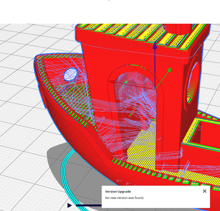

BUT this is prebuilt stringing created inside of the actual G-Code/Slice itself.
I have tried default settings, reset the entire program and it still adds these to any model I put into the program. Any one know the solution to getting rid of it is?

Can you screen shot the Legend? It looks like travel moves?
Re: Cure Slicing in prebuilt strings
Yup, i'm a fool and very tired. It was just travel moves so it must be my retraction settings... i've printed like 12 different benchy's now trying to figure out if it was... I guess I have to just play with it more.
