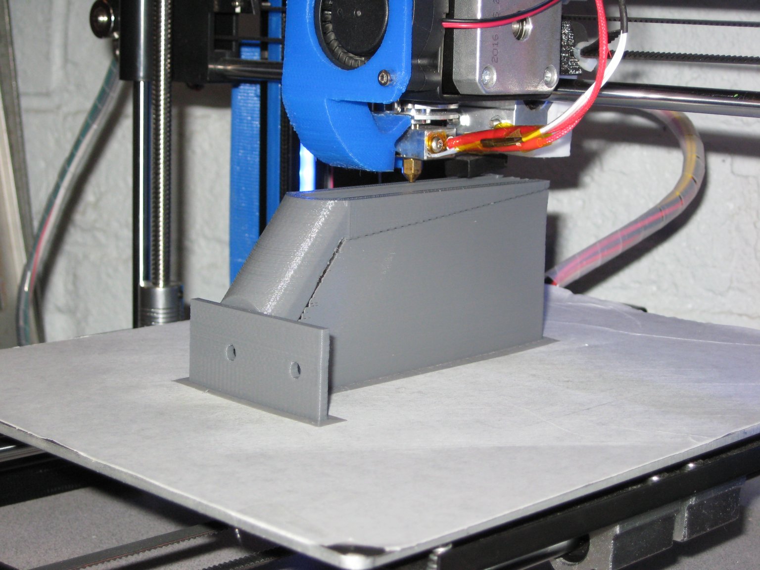

Start with the hot-end a fraction higher above build plate.
I use a Vinyl transfer paper tape on the build plate, Sure it sticks but with a little water the paper tape washes off quickly.
Sample image on black Chinese build surface
