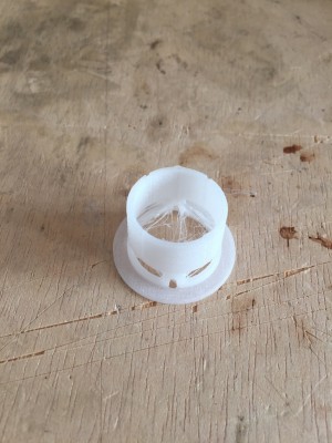

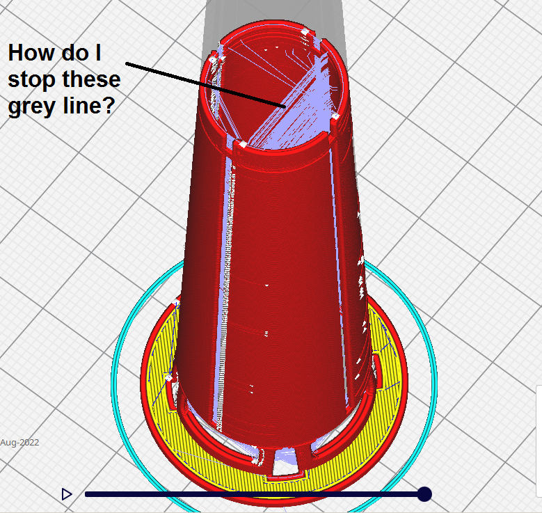

I'm using Cura 4.11 and I need to stop this stringing.
What are the setting should use so the head doesn't to into the centre of the part as shown, I have tried various thing and this is the best I can come up with: Thanks

Yeah if this was PLA I would say it could be temp or retraction distance
But with TPU, that largely goes out since you rarely have much retraction with TPU

I can't have any stringing on the inside as it will be a long tapered tube that fits over something. It will be impossible to remove any internal stringing.
That's why I want to eliminate any internal travel of the nozzle.

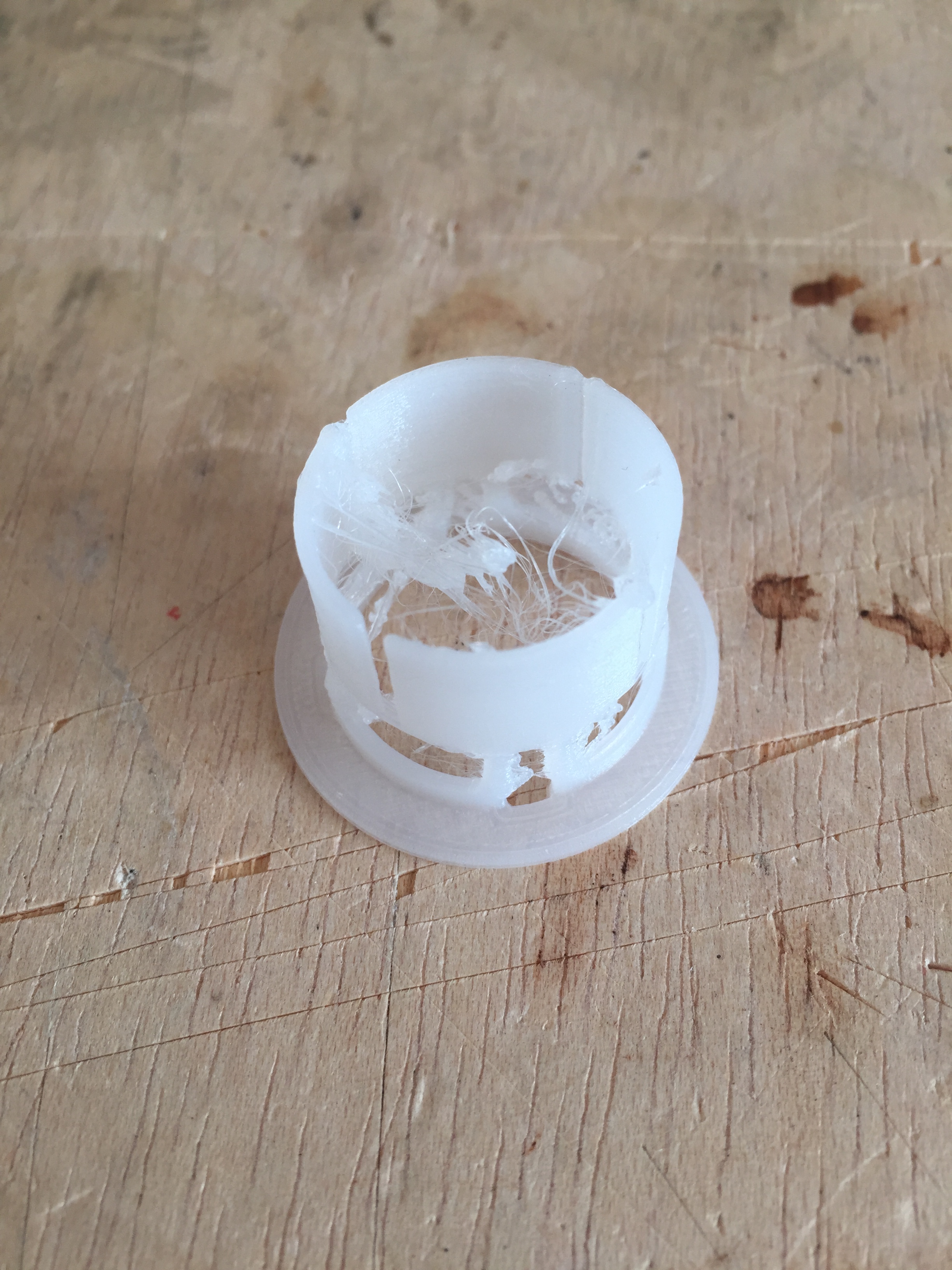

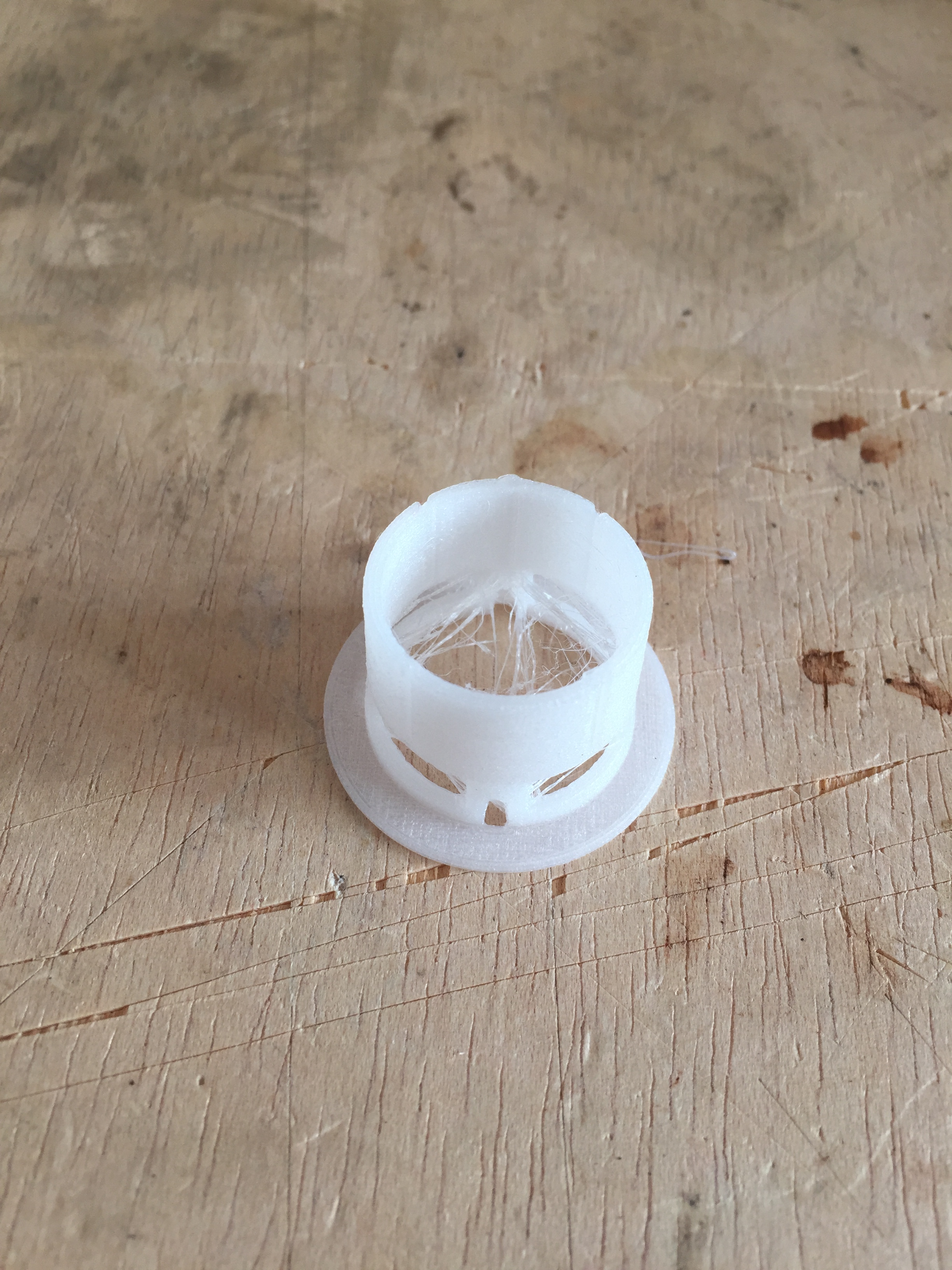

Thanks, the STL file is about. I've been trying different things, like retraction setting, I did 10 towers, 2 failed.
I put a post on the Cura Community Forum, but haven't got an answer yet.
I don't have a complete Prusa profile as I don't have everything set up.
Here is the Cura profile if it's any help. I have also played with the test part, I put a 0.4mm wall on the inside to stop the nozzle from going into the centre. It worked.
The small amount of stringing at the bottom is easy to remove.
I just need to cut the slots after printing.
I don't know how it will work out on the full part, it's 180mm tall. Lez
