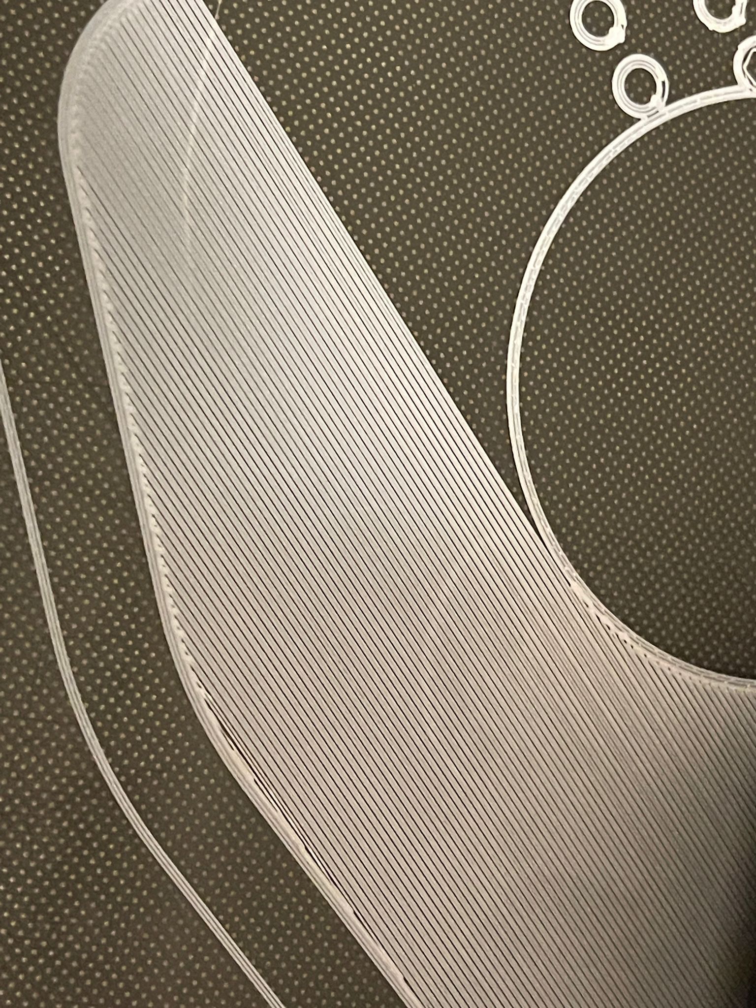

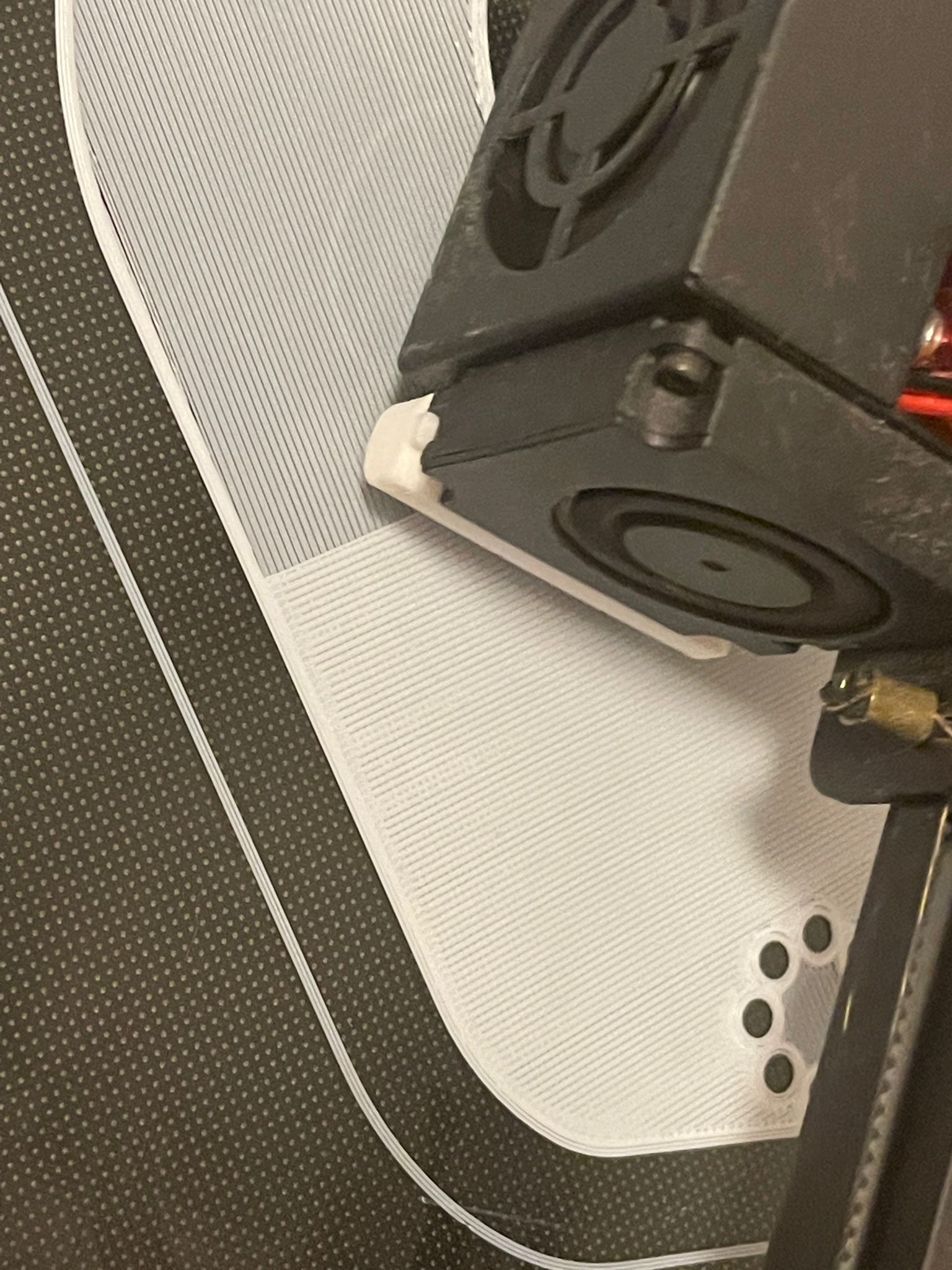

I am using an Ender-5 and Cura 5. I never really had problems with my prints, but recently I have gaps in all of them in the x-y direction. Even in between of the walls are gaps now. Does anyone have an Idea how to fix it? The outer Dimensions of the parts are spot on so I dont want to increase the flow rate. And its not just the first layer.

It could be a value applied to the Cura Overlap.
Post your Cura profile

Ok so what do you recommend changing?
Here are the printer Settings.

Re: Cura gaps in prints
Try changing these
Line Width 0.45 mm
Wall Line Width 0.45 mm
Outer Wall Line Width 0.45 mm
Inner Wall(s) Line Width 0.45 mm
Top/Bottom Line Width 0.45 mm
Infill Line Width 0.45 mm
Skirt/Brim Line Width 0.45 mm
Support Line Width 0.45 mm
Line Width 0.45 mm
Based on the skirt line, your z offset looks good
You've already calculated your slicer flow settings?
https://teachingtechyt.github.io/calibration.html#flow
