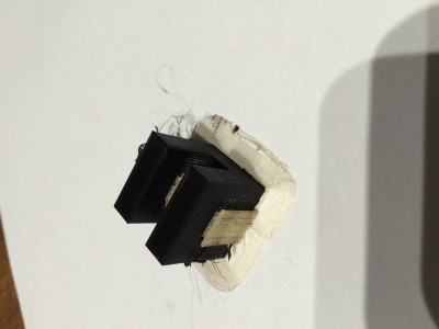

Here very short my findings:

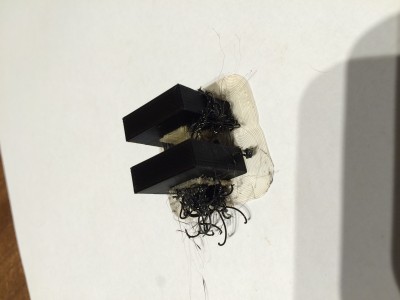

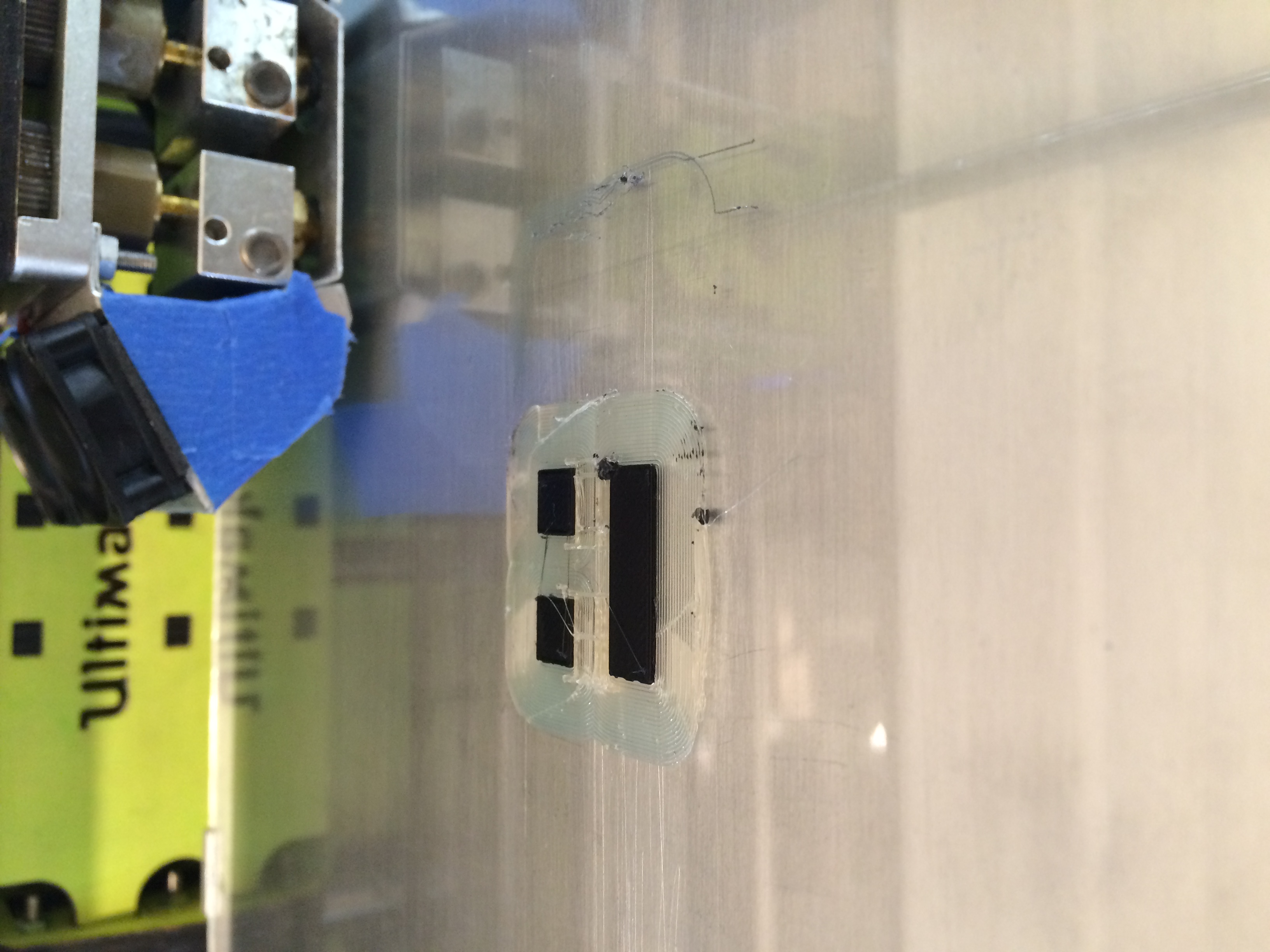

The "Support Interface" feature of Cura is very usefull and result in a clean (supported) surface of the printed part. The PVA was easy to print and has been completely solved in water without any issues.

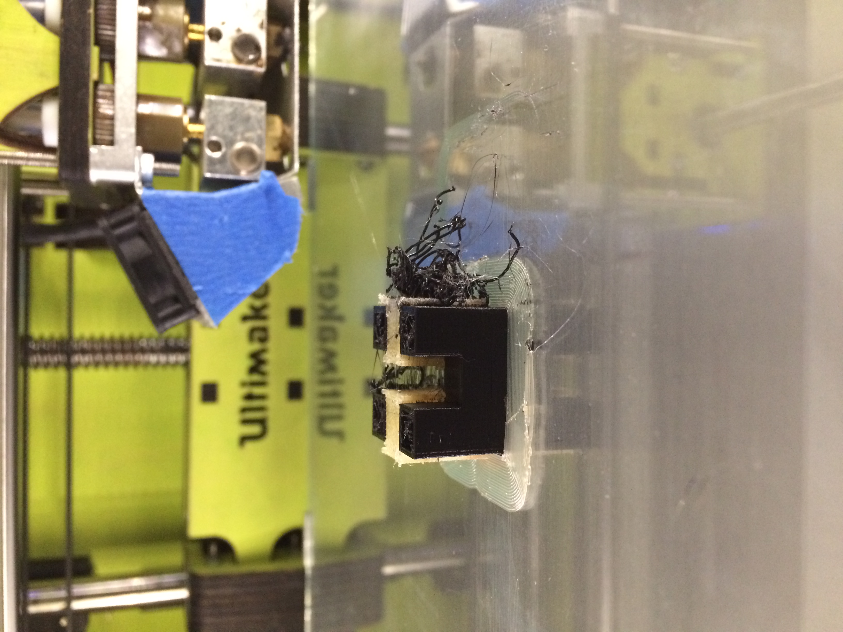

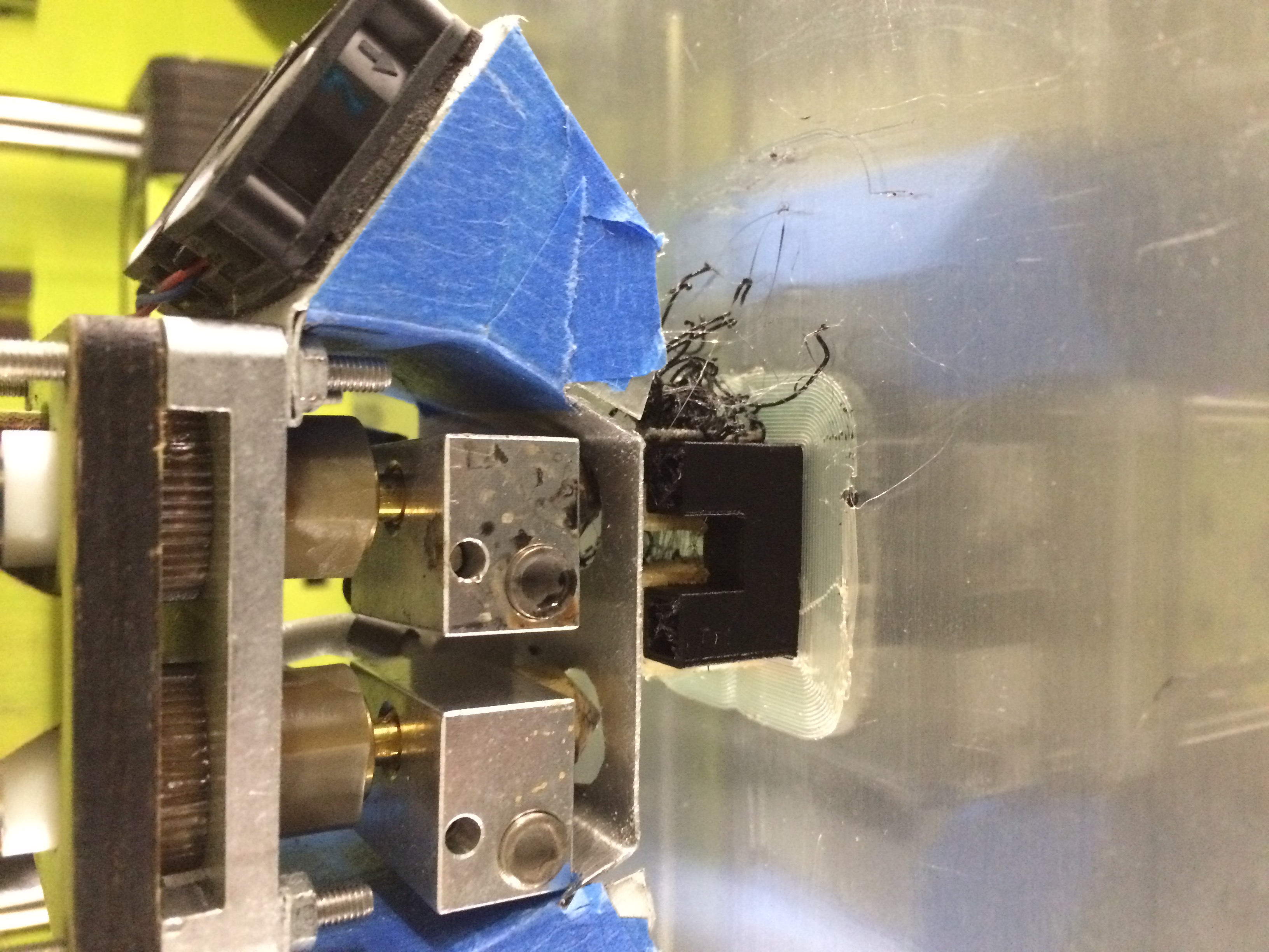

I found only one hurdle with the new Cura 2.4.

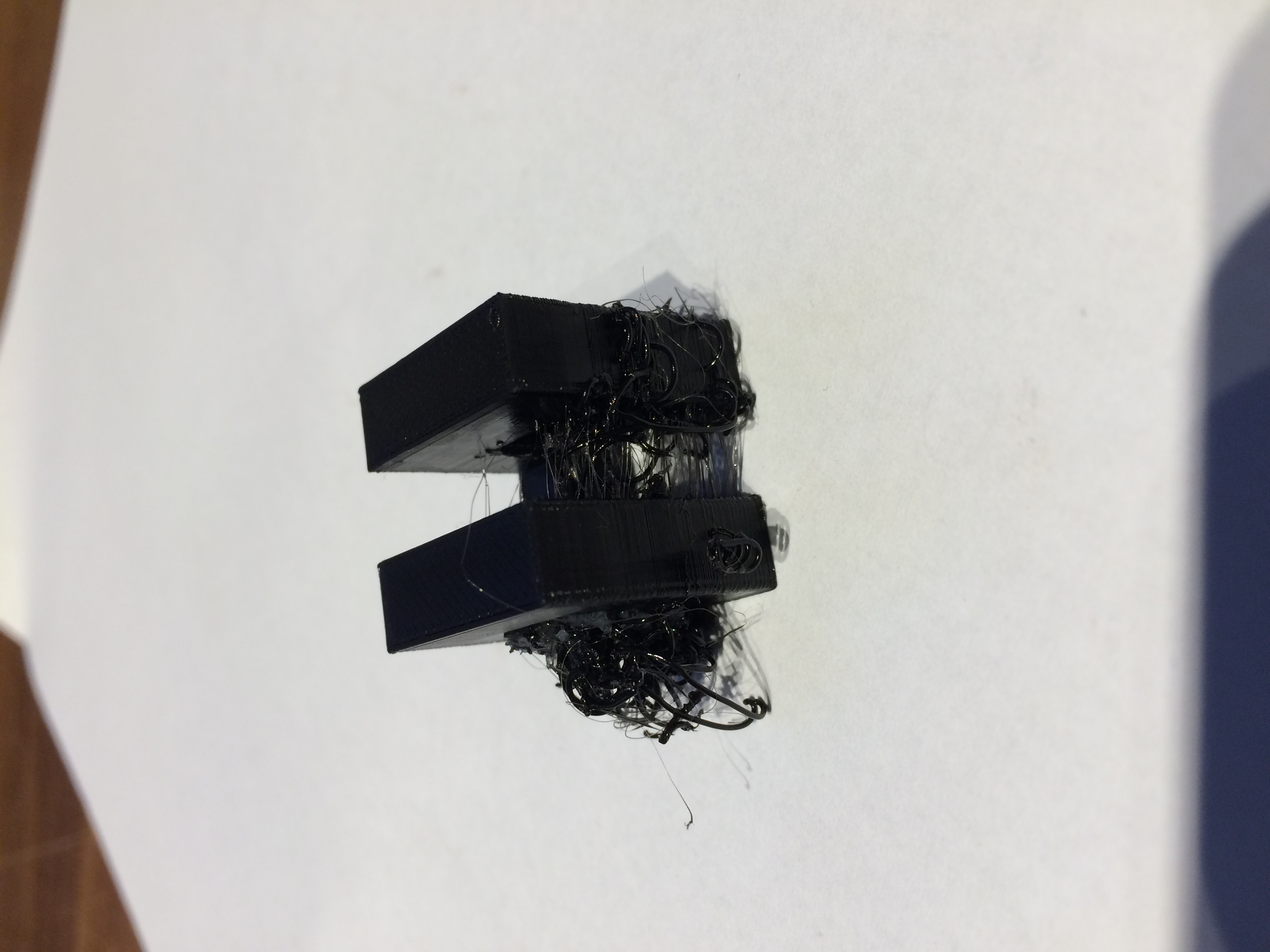

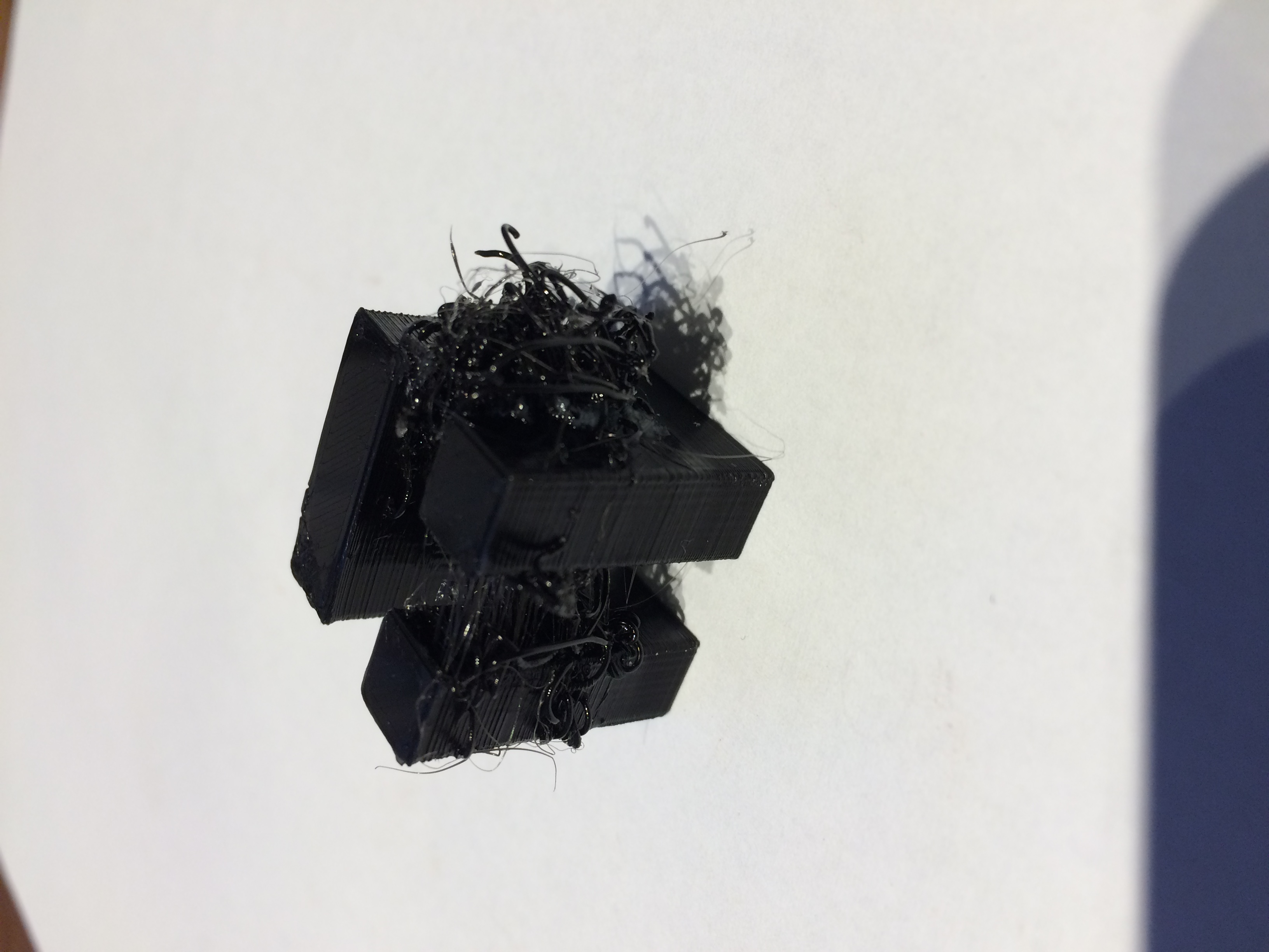

There are now settings for "initial printing temperature" and "final printing temperature" (beside the "print temperature" and "standby temperatue") which are automatically calculated. Because of this new temperature settings, my nozzle never reached the standby temp and the PVA got a bit brown... Further this enabled also oozing of the black PLA/PHA so I had to clean the sides a bit as you can see in the pictures. The PVA never oozed.
Here a few parameters:
Print temperature PLA/PHA 208, standby 170
Print temp. PVA 195, standby 170
Layer hight 0.1
Build Plate temp. 55
Print speed 60
Z-Hop on, 1mm
suport surface thickness 0.5
support horizontal expansion 1.2
