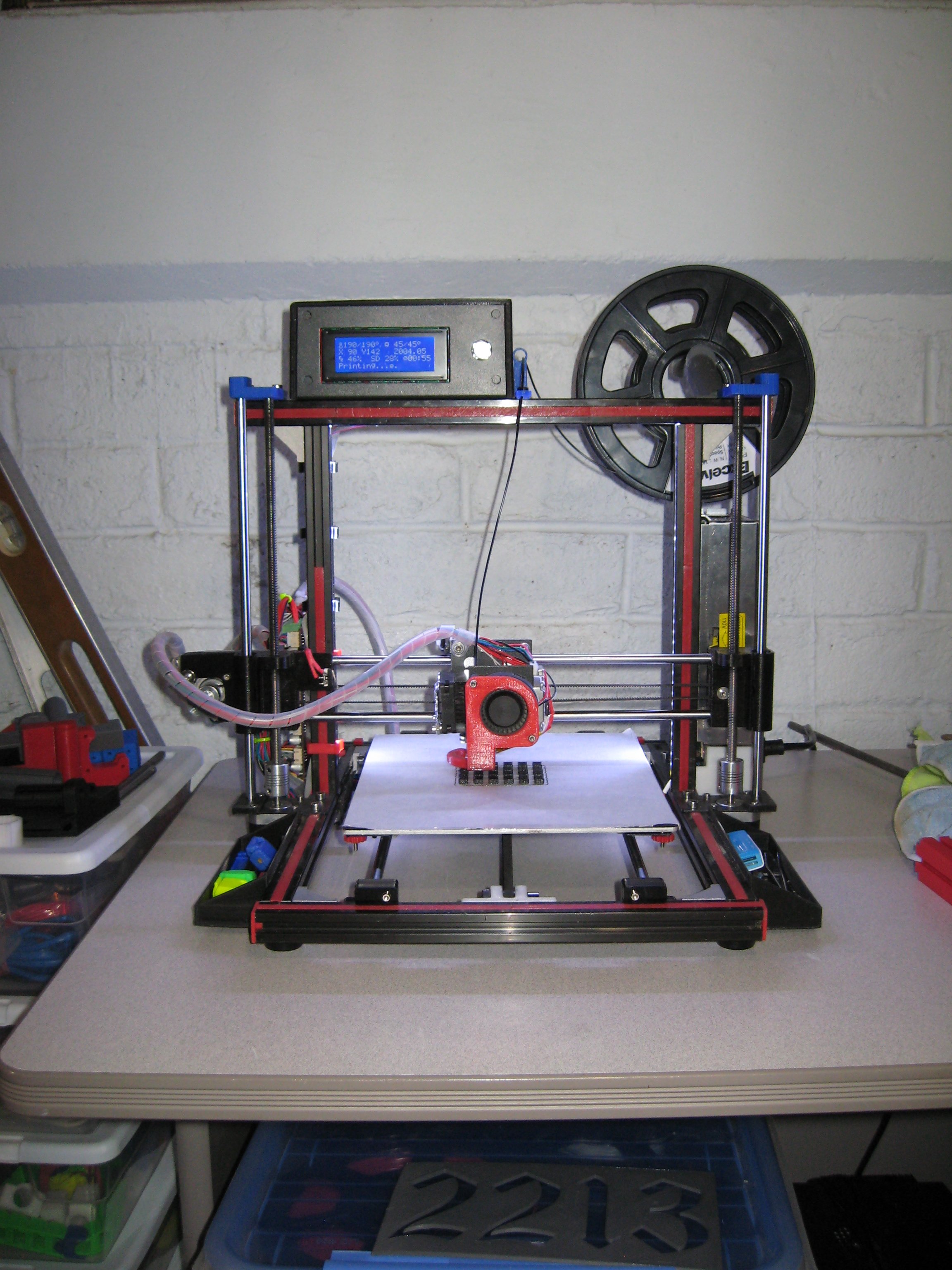

I'm new to 3D printing. I got my Hictop Prusa I3 for Christmas. It took me a day to assemble and a couple of days of false starts and stops to get printing. I thought I would offer some advise for other newbies

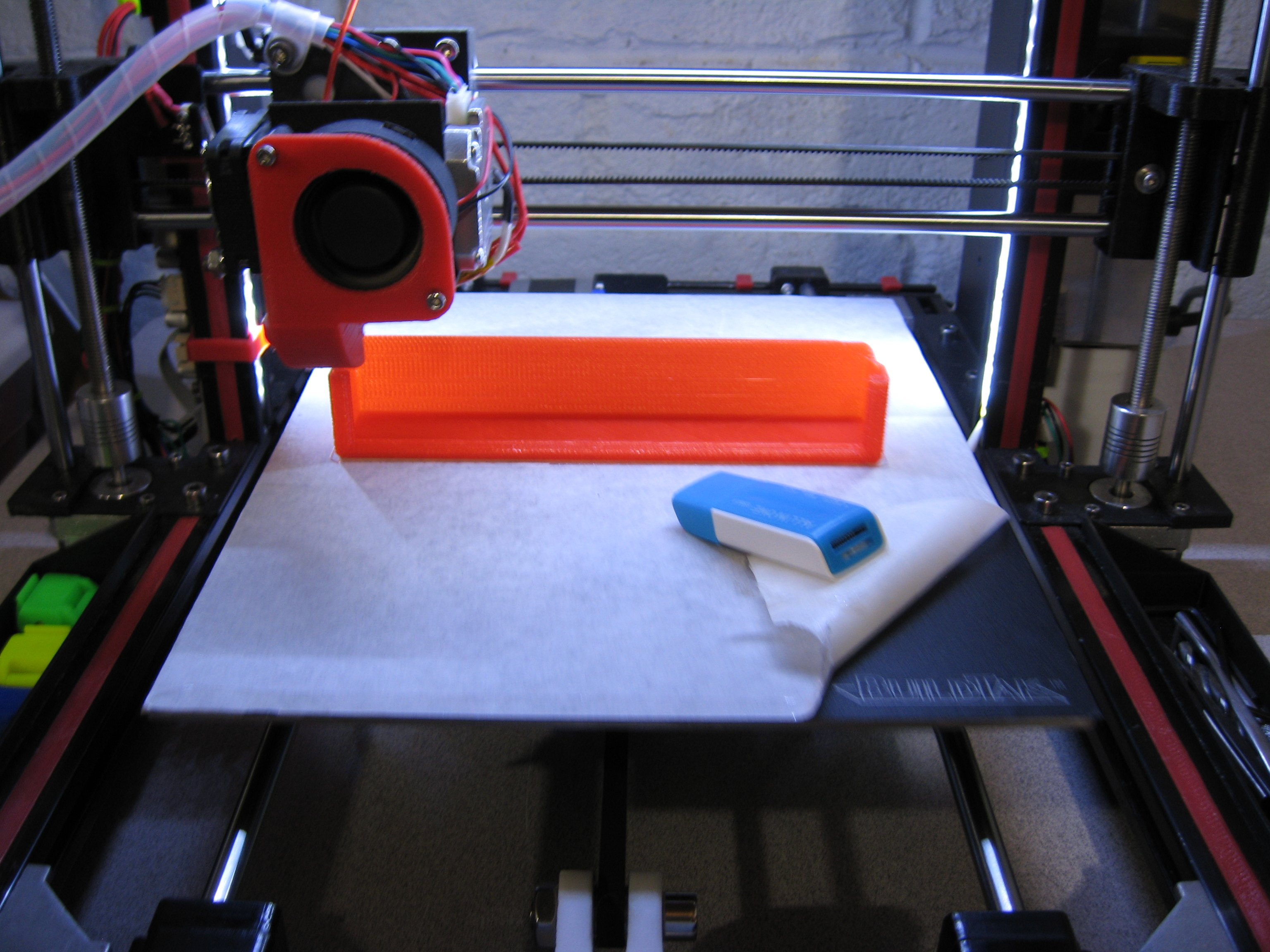

I Print PLA at 196-200 with a bed temp of 50-60, and start at a speed of 40-50.
Once the base is complete changing the print speed to 70 - 86 for the rest of the print.
I have printed some non-complicated shapes at 76 like the display case shown from beginning to end.
however the complex shapes will start at a slower speed of about 40-50 then change to 76.
I purchased a BuildTak for my bed, thou more often than not I have used medium tack vinyl transfer paper over the bed.
A little prep in needed before using the transfer paper as PLA will not stick without sanding, Clean the BuildTak bed with alcohol allow to dry.
Apply the Transfer paper and sand with a 100 grit sand paper and wipe the dust off then print, when the paper tears simply replace.
I have had to tape the transfer paper to the Front and back edge, only after applying the BuildTak to the Bed on the bare aluminum bed it stuck.
*** Note sanding with a quick scuff across the transfer paper should take no more that 15 seconds.
