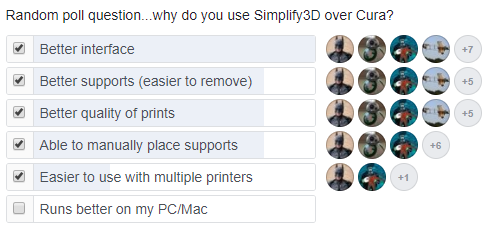

I posted a small poll on the Creality CR-10 Droid Builders Facebook group yesterday, letting it run for 24 hours. It's a busy area and I figure we could get a few results..... here they are.
Random poll question...why do you use Simplify3D over Cura?

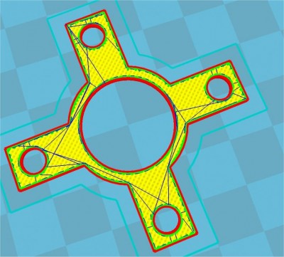

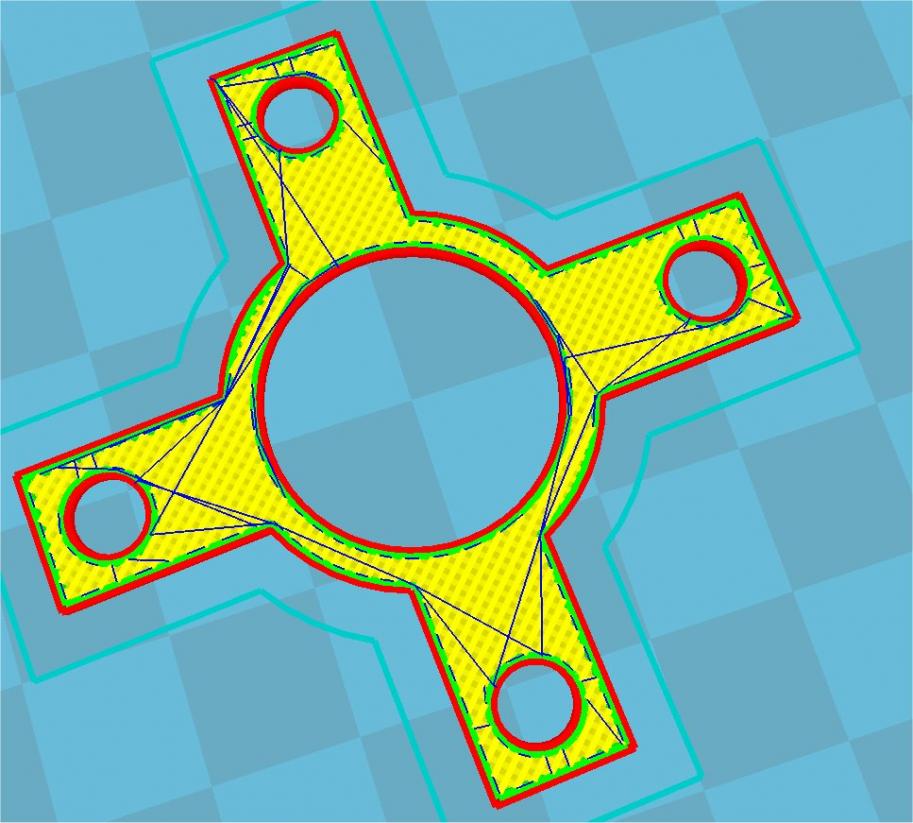

This is Sliced with Cura 15.04.6

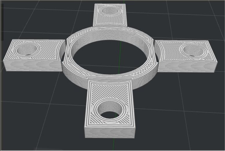

This is sliced with idealMaker (you can see the ears are not connected to the tube)
Post results Is model flawed? Was Simply3D being misrepresented?

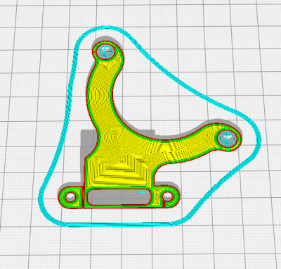

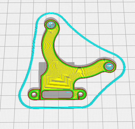

Here it is...the section on the left just falls off (yet you would expect the mount tab on the right to have the obvious issue)

Re: Cura vs Simplify3D Facebook Poll....
I took a look at your Model and see it was poorly assembled from many pieces.
I took note that the left hand ear is not connected even before slicing you can see space between the left hand ear and the scoop of the model.
I took the liberty of property connecting both ears, though noticed that the scoop is also in need of some repair work thou not as dire.
New Model
Reduced Height Fan Bracket.stl
(90.61 KiB) Downloaded 1086 times

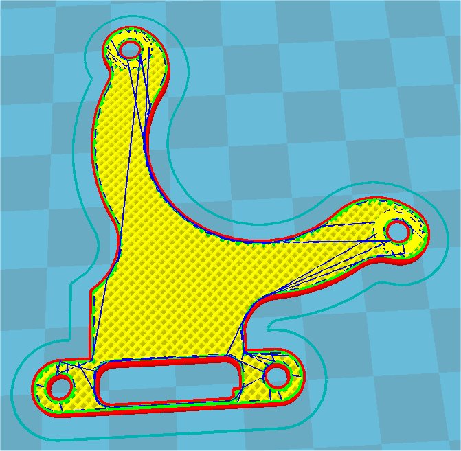

Cura Sliced
Thinking about it that Is most likely what is wrong with the Tube model with 8 ears.

So, as promised, I looked at your tube w/ 8 ears in Blender, and yes the ears are separated by a zero face. Like one was imported and copied, then slid into place by hand w/o merging the edges. Older Cura will handle this, to a fault. I have a few models where it 'helpfully' fixed the mesh, thus sealing a push reset button or making a print-in-place hinge solid. Newer Cura has more control (to some degree).
