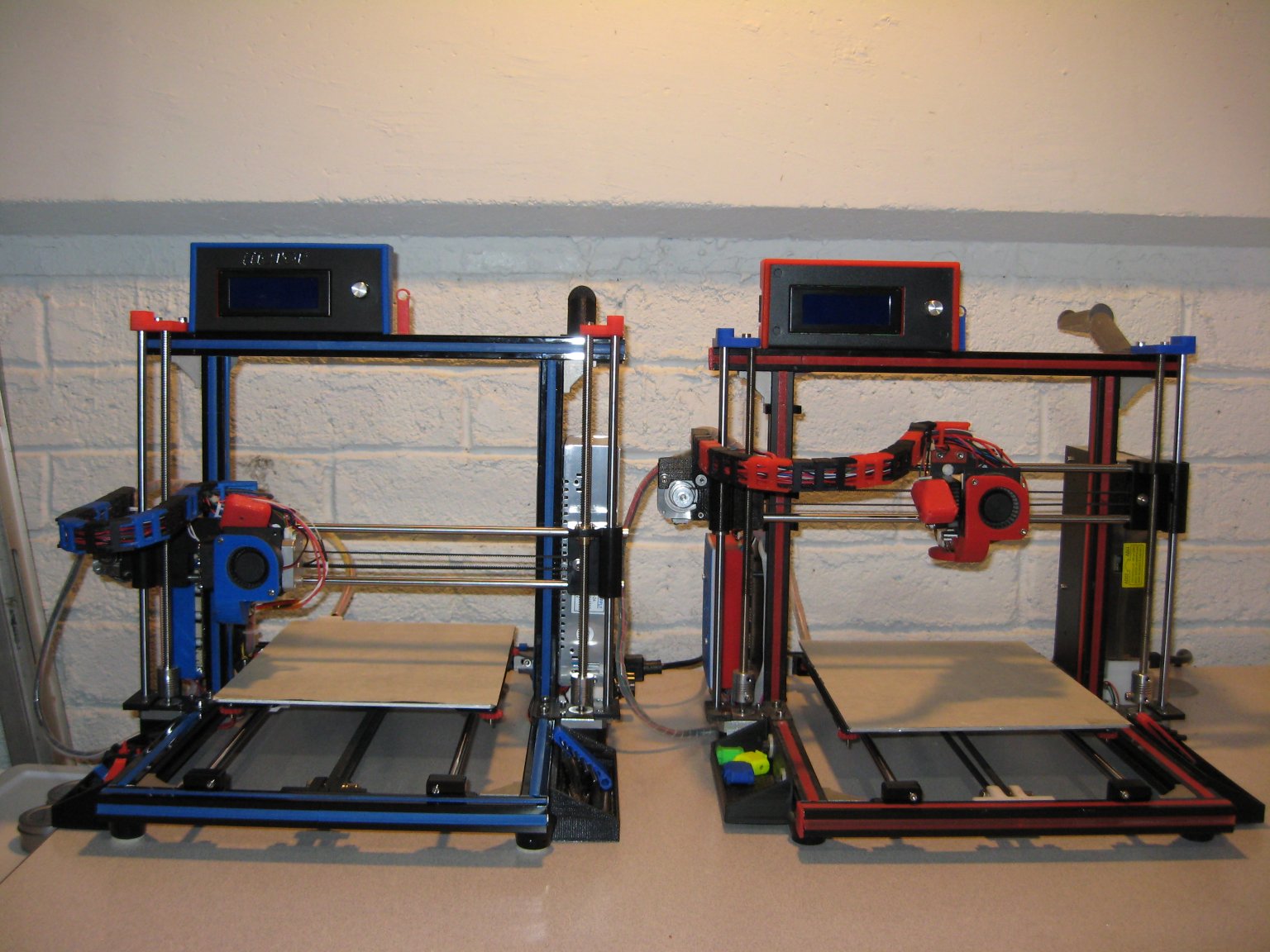

Meet the Twins
Need help have all marlin 1.1.X setup for the Twins, all you have to change is the filament run-out sensor and setup for your Z-Axis Sensor.

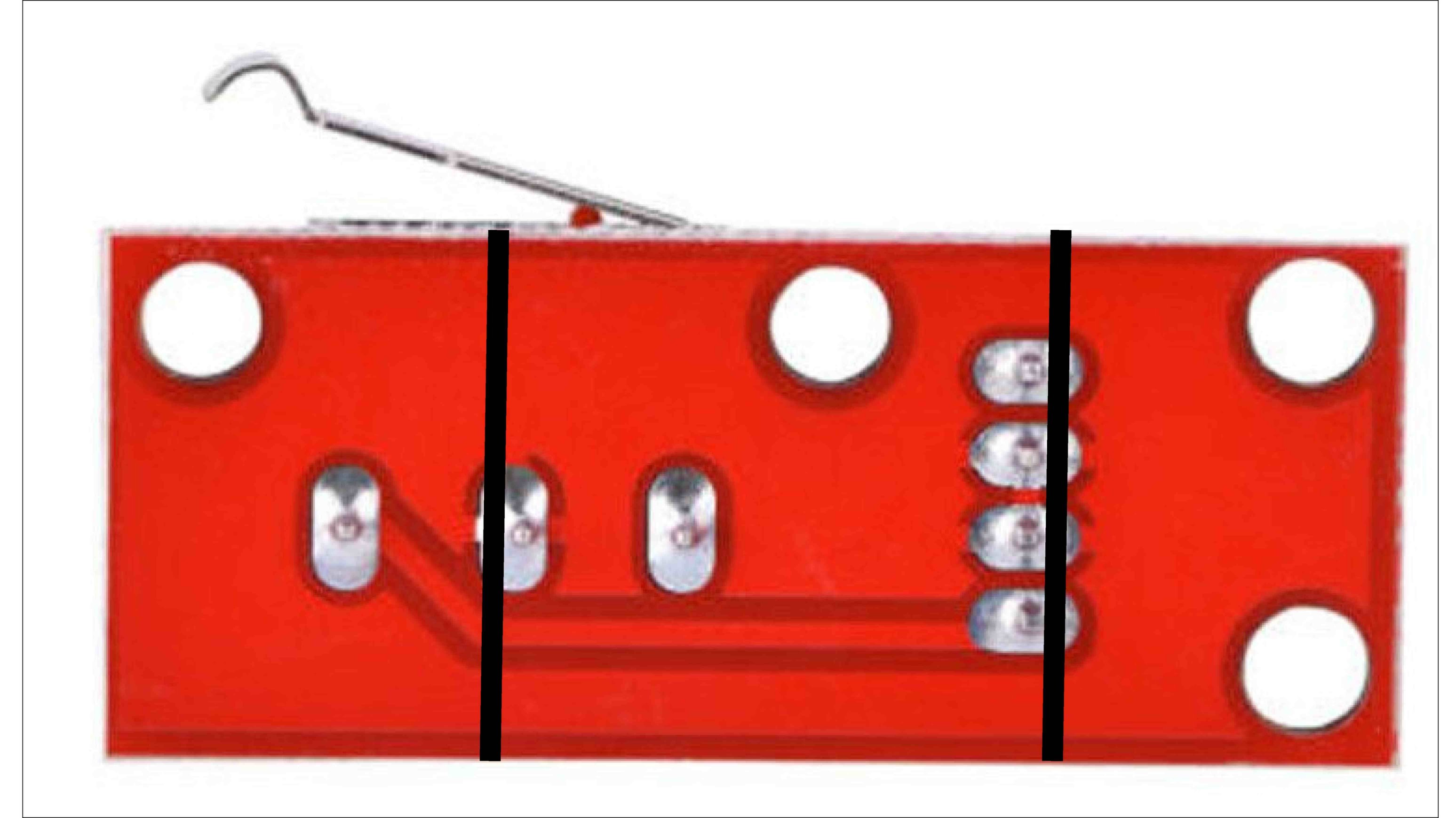

However cannot find that I have ever let my design out. So Here we go.
I use a end-stop switch that is cut down to save space.
I desolder the Switch, and cut alone the lines. Being careful not cut thru the Connector.
Position the switch shown in image 1, Trim the top and bottom switch terminal off leaving enough terminal to solder onto. (Cut mine a the 90 leaving 2mm of lead, do not trim the center lead, it will return the the original solder hole)
Re-solder the switch center connection. Run a wire from the top and bottom to the switch across to the top and bottom of the connector.
Top to top bottom to bottom. As shown in image 1.

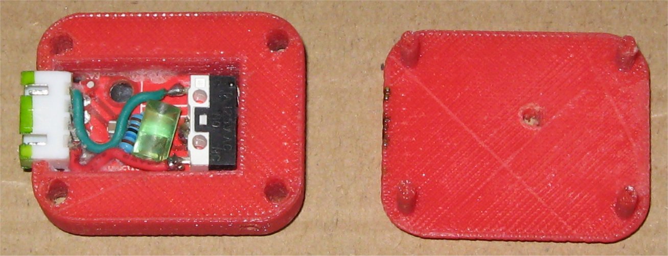

This is all you have to do outside Assemble Step. However I wanted a lighted Filament run-out sensor.
Solder a 1K ohm resistor the the unused switch hole, solder an led to the resistor trimming the led as short as possible observe polarity.
And Finish be soldering the led the the bottom of the switch as shown in image 1.
Box measurements 16mm X 30mm X 37mm
Assemble Step
Print the Run-out sensor box. Fit an glue the board into position. Making sure the switch operates correctly.
Glue the board into place with a couple drops of superglue.
And yes I could have used the original resistor and led board piece. Did not think when making the first ones.
Assemble the box insert filament, Plug in and mark led position. Open the box and drill a hole for the led to shine thru.
Assemble Step

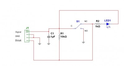

Have switches with two wires standard Hictop like yours. I used this generic lighted end-stop switch to build a lighted Filament run-out Sensor.
lit when filament present and signal to ground. Filament out Signal to 5v, led extinguished. If I designed the circuit the LED would have connected to NC with a 1.6k resistor on the vertical 5v line ("making signal to 5v thru a 1.6K resistor").
