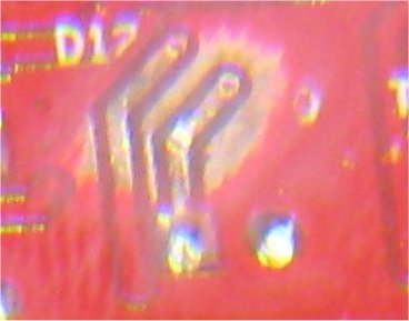

Have you taken any measurement from the Z-Axis connector to see it any of the pins are open or shorted.
I found one of my controllers had a open trace (shown above), I soldered the broken trace

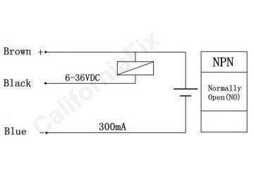

Sorry, I am using the Uxcell LJ18A3-8-Z/BX 3-Wire DC6-36V 300mA NPN NO 8mm Inductive Proximity Sensor Switch.

Have you measured the voltage level output from the proximity sensor. (Between the Black and Blue wires.)
And just to verify your wiring below
Brown wire is source Vcc
Black is signal
and Blue is ground
Black is signal
and Blue is ground
