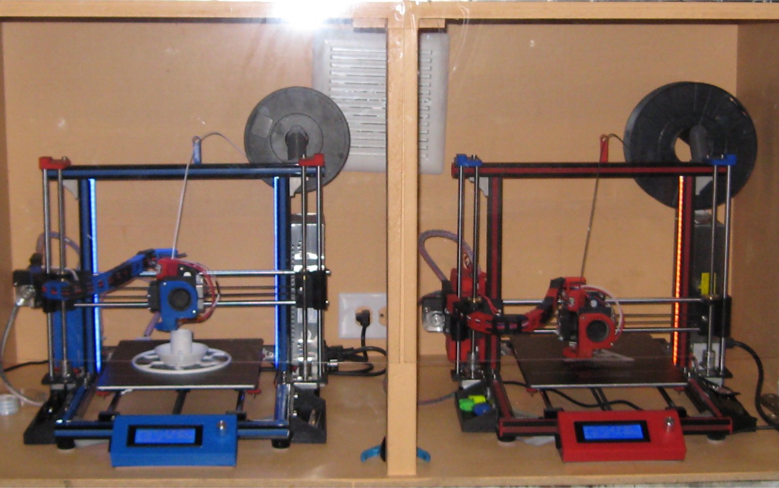

Post by Roberts_Clif » April 22nd, 2018, 4:50 pm
Meet the twins!!!
3DP12 & 3DP11
Blu & Red

Post by Roberts_Clif » April 22nd, 2018, 8:19 pm
Mr SNG wrote:
P.S Like the twins....Those cabinets are a great idea too. Did you purchase and fit the cable chains or did they come with the machines?
It is actually One Cabinet I built with room for both 3D Printers. With a speed controlled bathroom fan that I use to give the case a Negative air flow to vent fumes outside no faster no slower. I can easily maintain a constant 90F internal temp with no drafts.
Every thing was 3D Printed on my 3D Printer, I found models on many different web Sites that give them away Free.
I did however Design some myself with Fusion 360 Free and Thinker Cad
