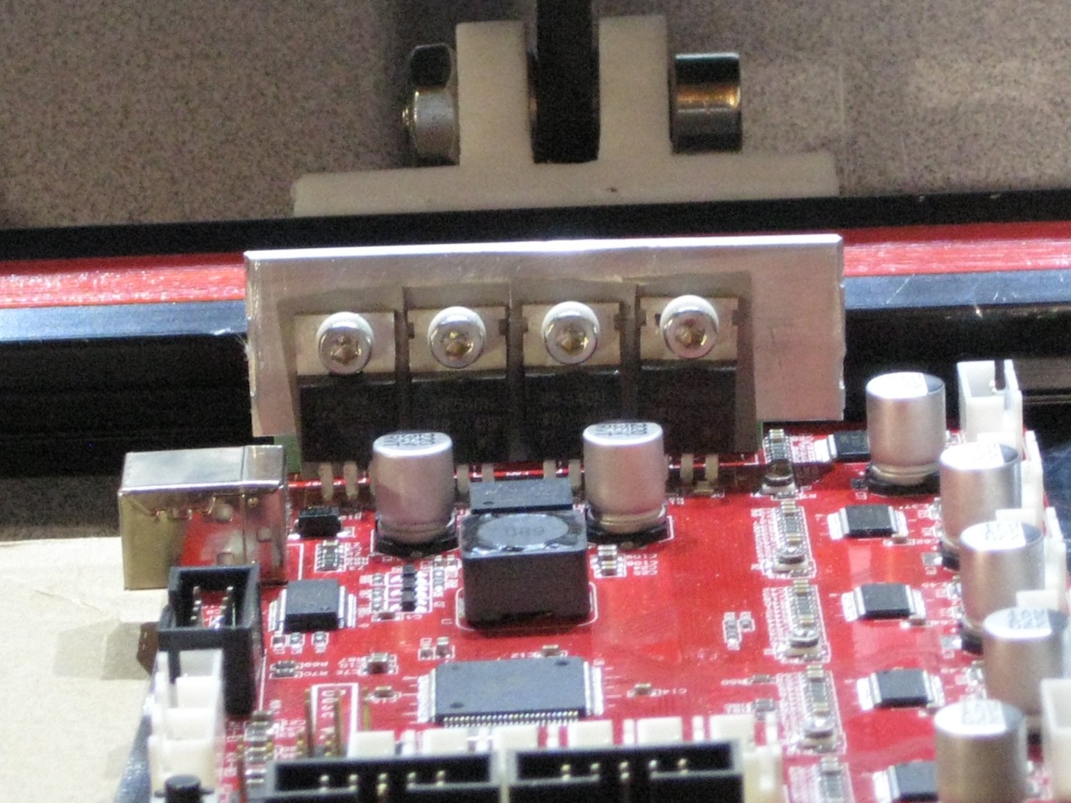

Why not Replace Q4 - the IRF540N N-Channel Mosfet only 3 pins and cost $4.80 for 10 pcs.
While you are at it add a Heat-sink and thermo insulator pads to the Mosfets, like I did, including a 60mm fan to cool.
All that is required is solder wick, solder, and a 27 watt isolated soldering iron and the replacement parts. And the Heat sinks ideal is optional.
