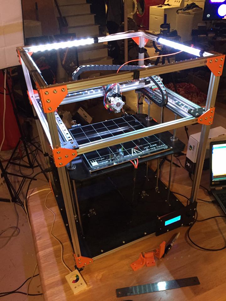

But I did manage to attach the old IKEA LED light strips I had used on the Ultimaker Original on the FT-5

Some progress and disappointment....
We have the print head homing correctly now. No changes were made but for whatever reason.....divine intervention from the Lord?...homing is working.
With the shorter Aero print head, I have had to adjust the z upwards a bit
And then the problems began...binding on the Z
With some great assistance from other builders, we started debugging (James and Clyde spent time with me during my Facebook live session, offering some good ideas)
Problem 1 - Bed springs are very, very weak. I run into instances where, when leveling the bed, one corner will not level since the screw is out all the way and the sprint was too weak to provide upward force. Need to find suitable replacement
Problem 2 - I was very diligent during the frame assembly to make sure everything was square. Of course, anything relying on T-Nuts can do it's own thing! But the binding is a bit maddening. All the set screws for the z and chrome rods have been loosened at the top. I've been using a digital caliper to even out the bed, measuring at the z-rod (between the collar and brass segment)....then trying to home, over and over...one side binds. Ahhh
Problem 3 - Melamine. I suspect the bed is warping a bit. We're also in the midst of a very humid stretch of weather. There's a dehumidifier running 24/7 nearby....but regardless, I think an aluminum bed would work better.
