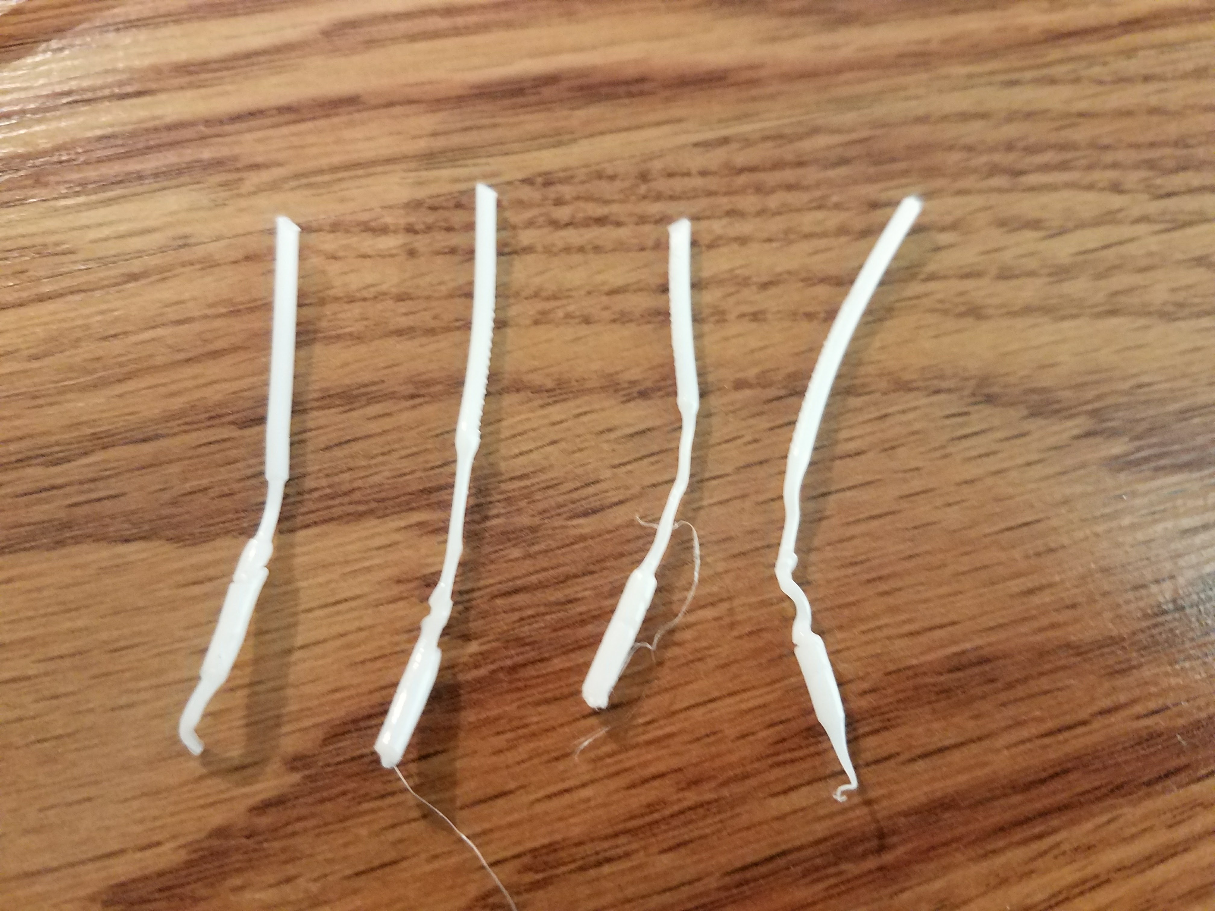

Hey guys,
My Hictop 3DP12 i3 Prusa was working great for several months, and I've enjoyed it. Just for a week now, it continues to jam after 10-30 minutes into a print. The nozzle will clog, nothing will come out, and the machine will go on without pushing any filament out. I've looked through many forums and tried all their suggestions, but none have worked so far. I have replaced the jet fan, throat, and nozzle. I have re-leveled the bed and raised the auto-leveler to avoid the nozzle dragging. I have cleaned out the extruder gear. Still no help. If I pull the filament out after it jams, snip the end, then feed it back in, it will work well again for another 10-30 minutes before clogging again. The interesting thing is that the clogged end always looks the same, 2 normal diameter sections separated by a long thin section (see the attached picture) Could use some help ASAP as I have a delivery to make for this. Thanks in advance!

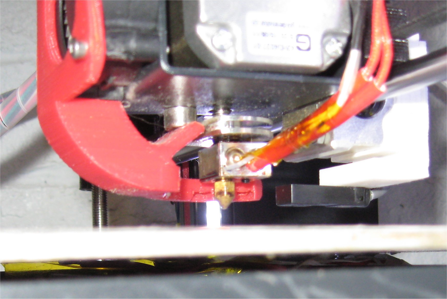

Hello I have a solution that has been proven My me.
I took one of these heat sinks Cut it in Half between the Fins, making 2 half height Heat sinks.
As Shown.
Remake of Hictop Part cooling Duct
Modified because extruder leaking filament, could not easyily be remove with full circle around Nozzle.
New Hictop extruder duct.stl
(196.96 KiB) Downloaded 856 times
