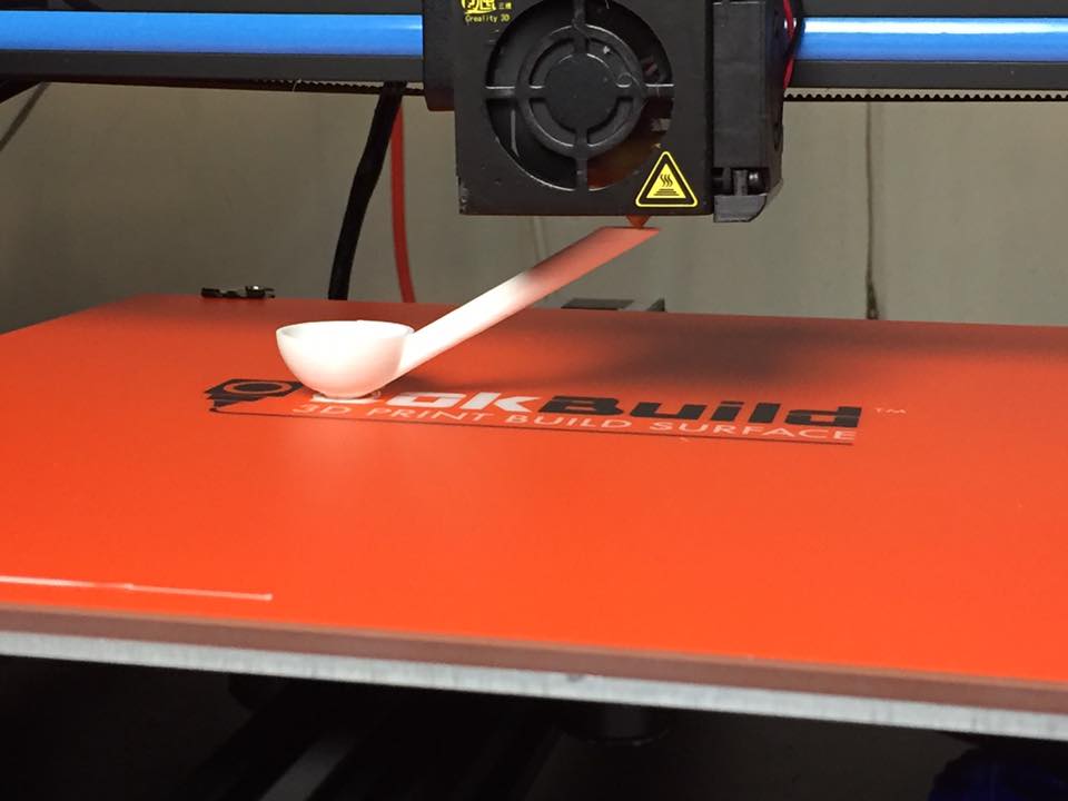

Did a test print of a spoon, not much print area to hold it, without supports....but it did it.
