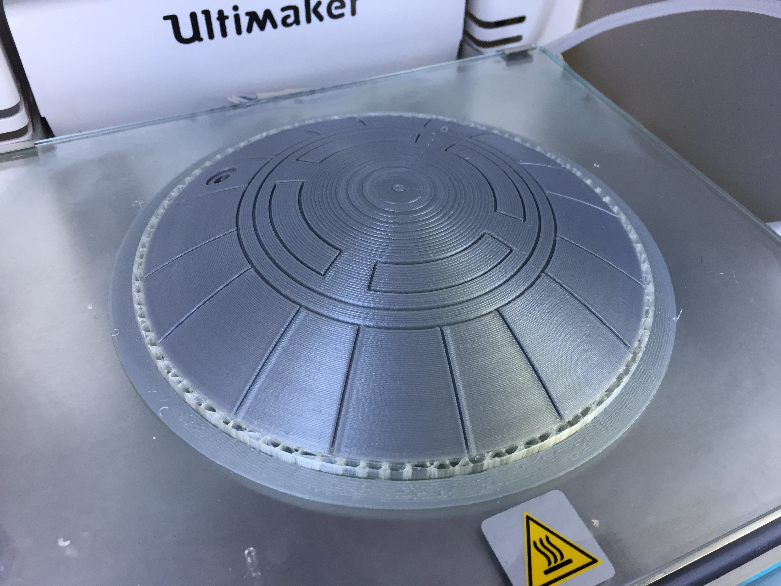

I gave the Ultimaker 3 a 21 hour print last night and it went very very well
BB-8's top dome piece. It has to be very thin and my previous attempt on the Ultimaker 2 didn't go as well. Complicated by the massive amount of support it requires
Here's how it came out
It's still soaking in a bowl of water...that's a lot of PVA support!
