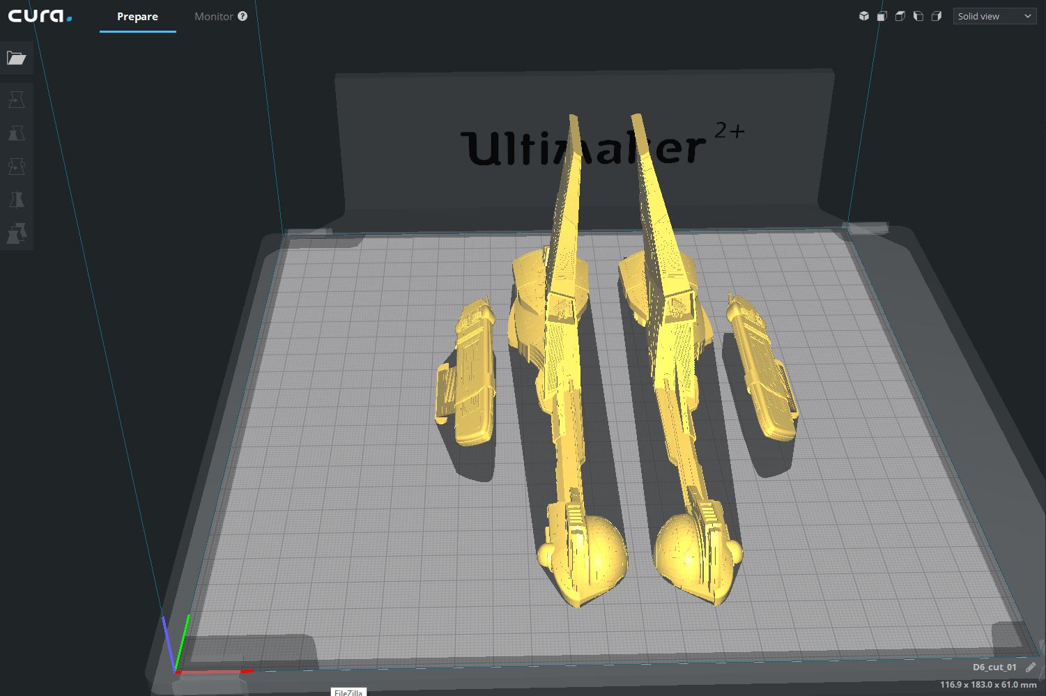

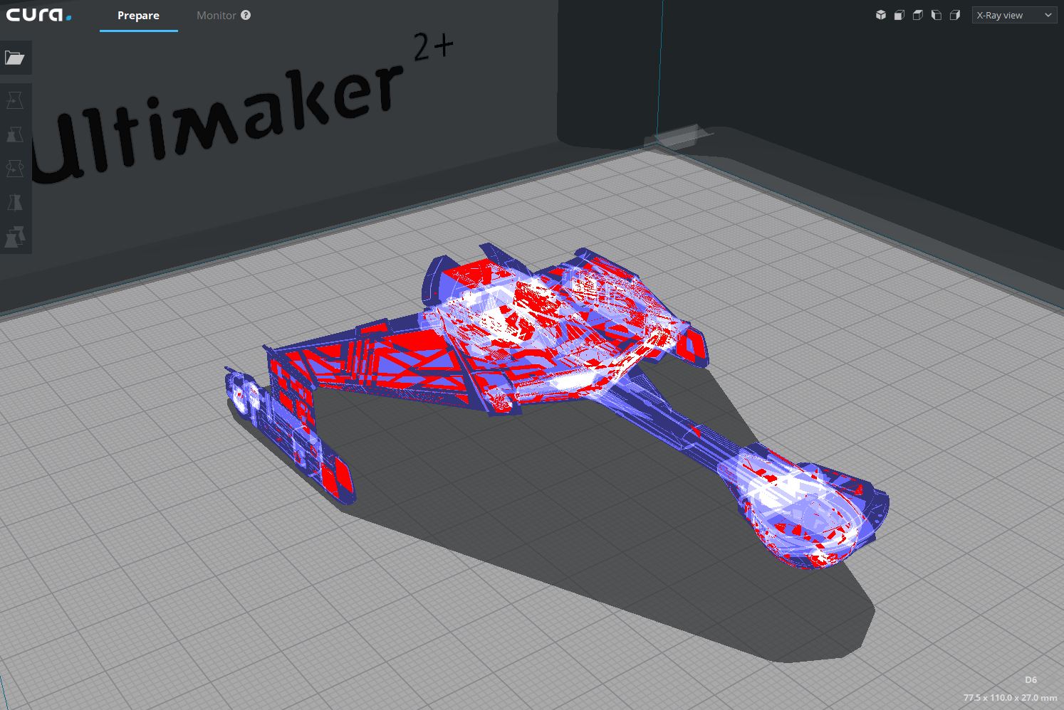

This is a Klingon D6 spaceship. I found a STL on thingiverse but the file is very bad according CURA 3.1 X-ray view.
If someone ask me, I do that...
