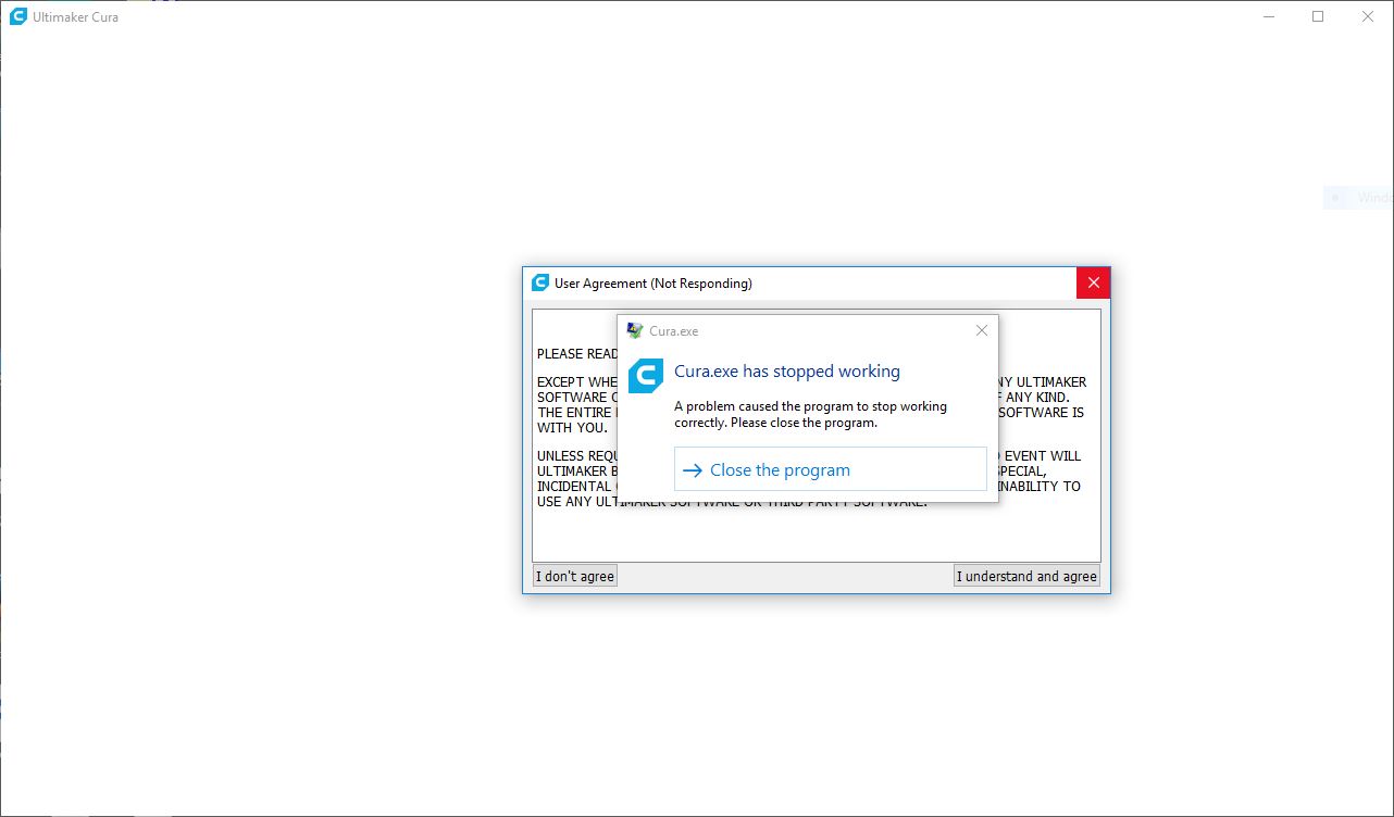

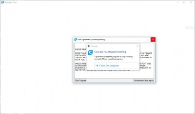

Hi all,
after sticking with Cura 15.4 all the time, I thought I give Cura 3.x a try. I installed it (without having it uninstall my old 15.4) but it fails immediately on the first start even before I had a chance to accept the T&Cs:
Is there a way to find out why it fails?

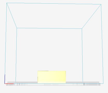

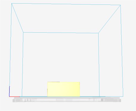

However Cura 3.2.1 still has a little bug, If I have a STL file loaded and Click on Reload all models.
the translucent carrage moves into the Print area

Intel Core i5, Windows 10 64bit, Intel HD GRapics 4000 which should support OpenGL 4.0, so it should at least start!
Is there no logfile or other way to find out why it doesn't start?

I only have a file fdmprinter in %AppData%\Local\cura\3.2\cache\definitions\3.2.1. No logfiles there. Do I need to start it with a special option to create the log?
