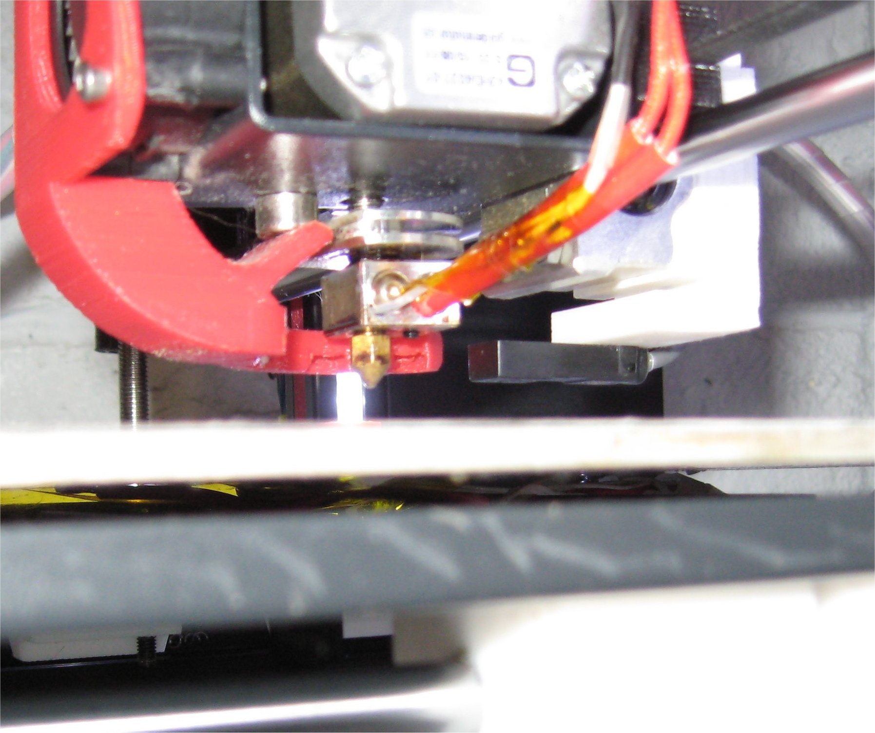

The extruder is mounted to the carriage by two long hex bolts passing through a fan grille, washers, fan, spacers, heatsink, the block on the carriage through which the nozzle is secured, and finally the screws draw into the body of the extruder. But, when tightened fully, the whole assembly seems to float by 1mm to and fro. Is this by design?

Thanks for your reply, I had read through most of the forum posts but in the end I found an answer to my question in about the fifth YouTube video I watched, KackaWeek found the same issue and added extra washers.
I solved some other build problems, the two Z-axis threaded rods were slightly bowed, but after rolling each of them on a flat surface to spot exactly where they were bowing up and them using gentle force I was able to straighten each of them using fingers and thumbs. The Z-axis linear guides were also able to move upwards enough to slip out of the stepper mounting, so I put a small amount of plasticene under each of the clamps, and did the same where I saw the Y-axis rods could also move slightly.
I then found that setting the extruder nozzle so that the top of the threaded portion was flush with the mounting block meant the turbo fan outlet was lower than the nozzle. I tried lowering the nozzle in the block but that made it a bit wobbly. After filing the holes and raising it as much as I dared it still didn't fully clear the work so I took the shroud off and ran without it just to get something happening.

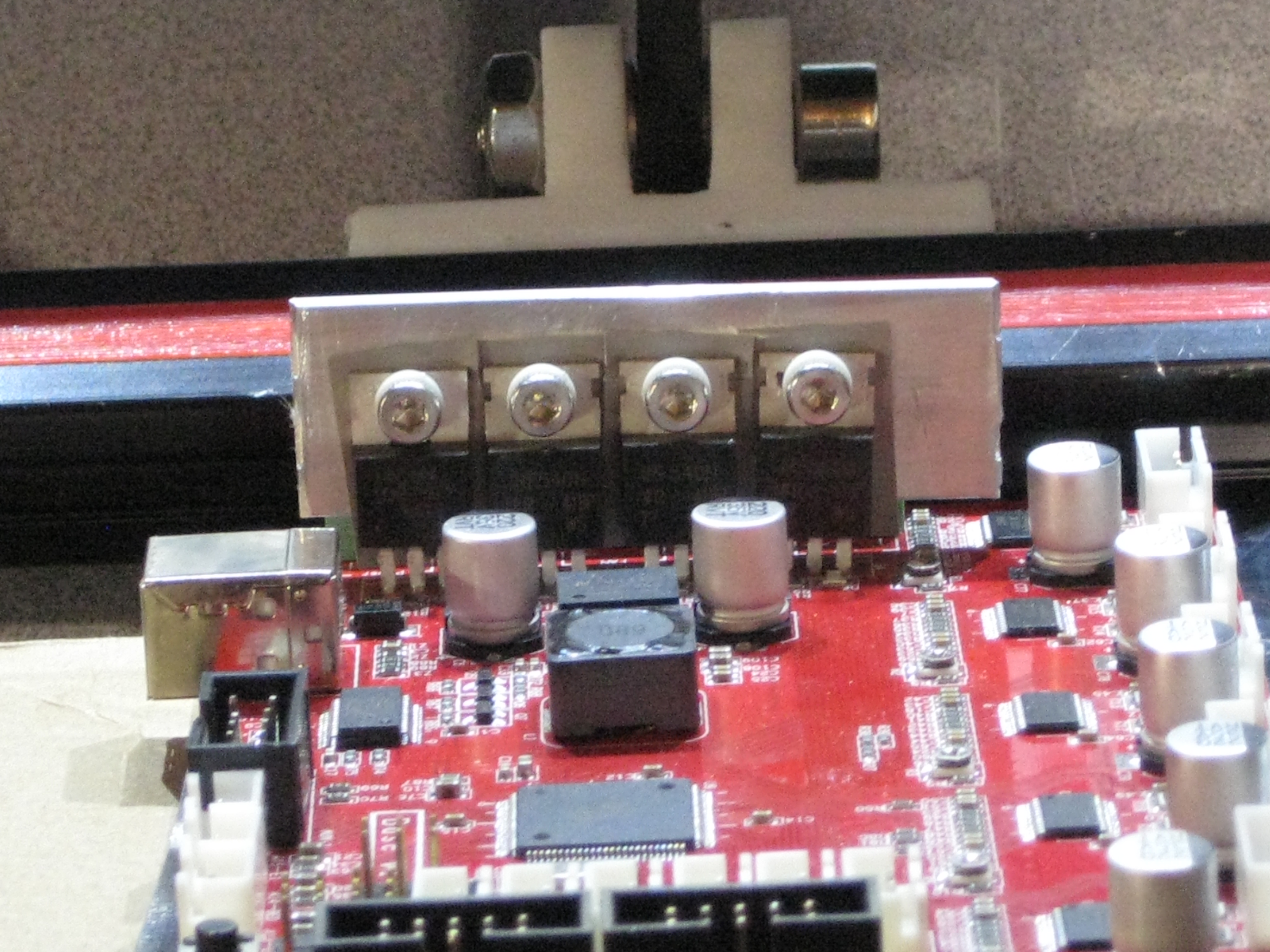

I have added heat sink to the Mosfet I a single aluminum bar with insulators across all, and a fan to keep the components cool.
I added heat sinks to all the stepper drivers and set the stepper current to .695 on all except Z-Axis 1.396 on my 12 volt Printer
and set the stepper current to .420 on all except Z-Axis .710 on my 24 volt Printer.
Modded a Duct parts fan And added a Heat sink to the throat Changed my Proximity sensor to low profile, with a thumb screw adjustable mount.

The Mosfets drive the heaters and beds, I assume? I was checking them during the test runs and they didn't feel as warm to the finger as the stepper chips did.
