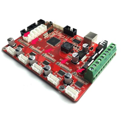

The voltage is measured from the trim-pots metal top adjustment.
I have placed a red arrow pointing at the pot adjustments below.
They are labeled R1, R2, R3, R5 and R6 on Base V1.3, MPK_V1 and MPX.3.
R1 is X
R2 is Y
R3 is Z : Double stepper higher V-Ref
R5 is E0
R6 is E1

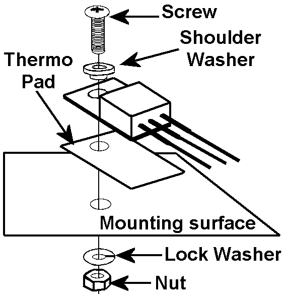

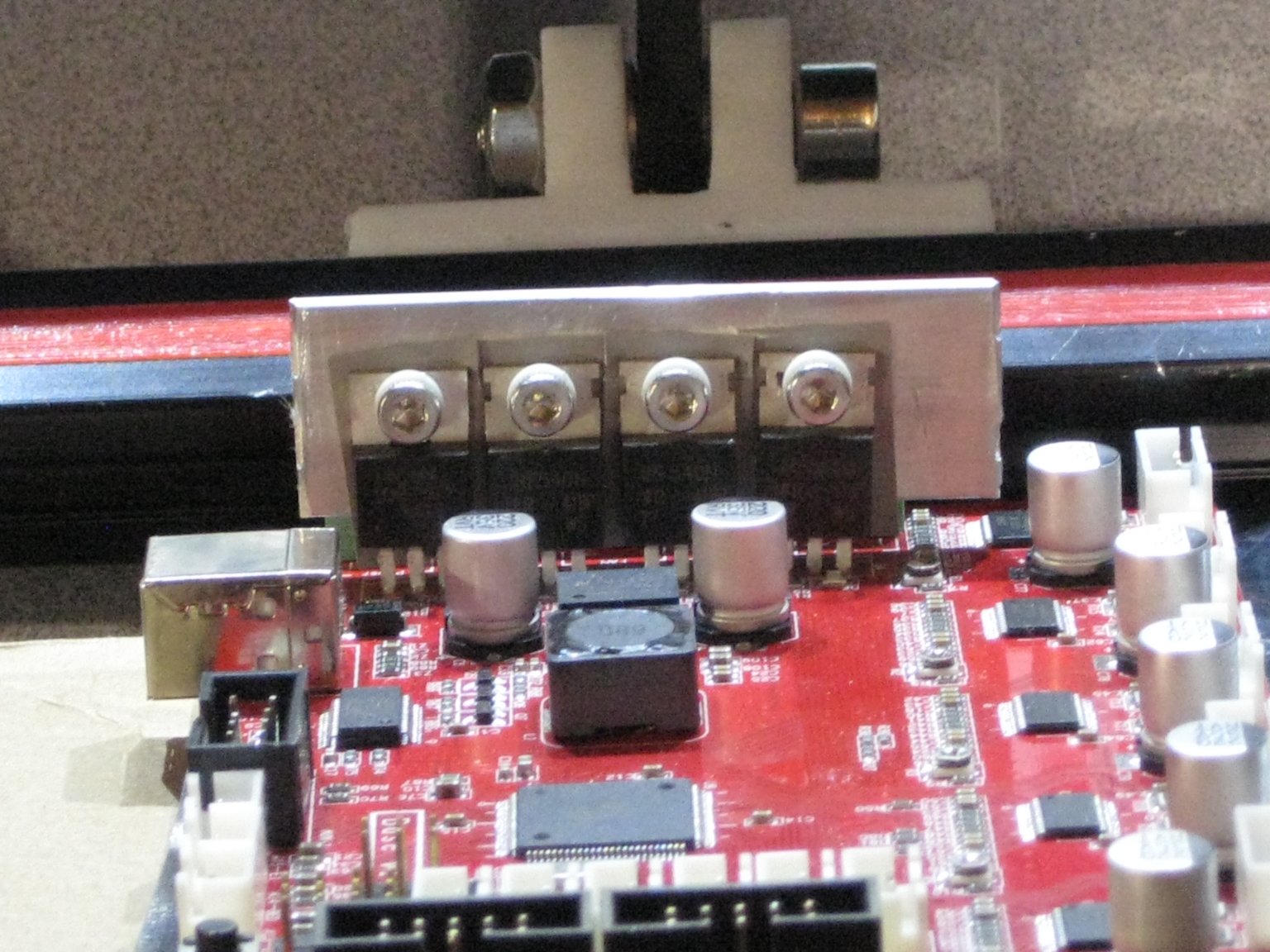

I have found that a Heat-sink is desirable on these controllers as the mosfets get hot.
I added a TO220 Transistor mounting kit and added an aluminum bar, along with a controller cooling fan.
