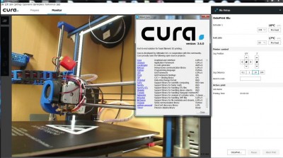

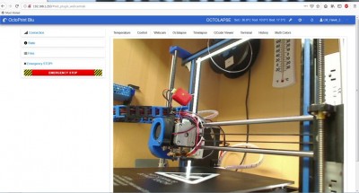

OctoPrint is a 3D Printer web interface Program that allows you to manage your 3D Printer, for remote access.
And the Raspberry Pi is an inexpensive alternate to a desktop computer for remote monitoring and control of your 3D Printer.
The Raspberry Pi is a Quad core computer that allows Octoprint access to web cams for remote viewing via a web browser.
At home at the store or at work you have complete control over your 3D Printers.
An even though the image shows Cura displaying my 3D printer, Cura does not support the Octoprint interface.
This is the main reason Octoprint has its own web interface and many plugins to help you control and monitor your 3D Printer
