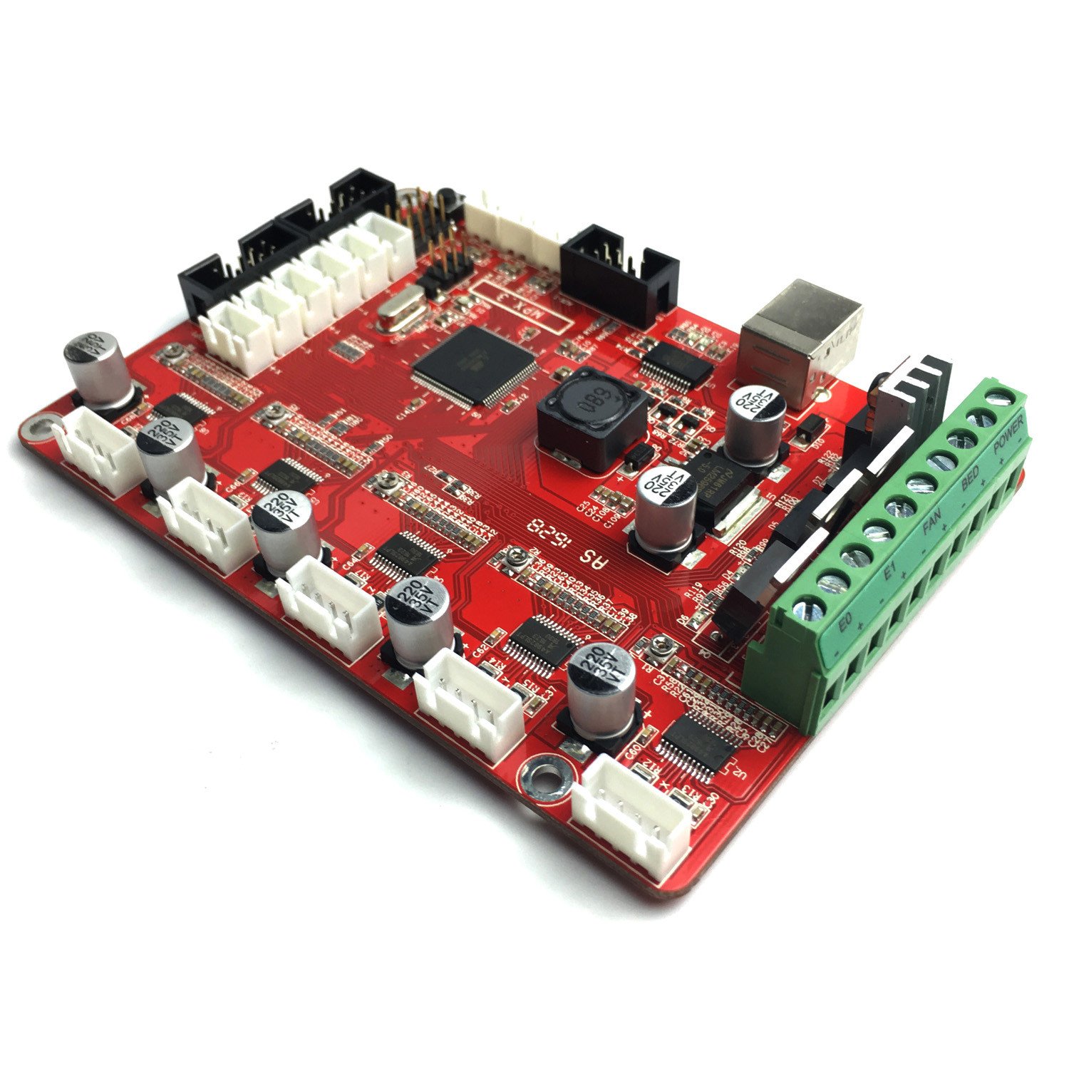

Today I will start my investigation into the fact that the Hictop Controllers are in fact a MKS BASE Shown Below.
This controller is a Ramps 1.4 Compatible controller but is a MKS Controller because it uses the Mosfet_D_Pin to power the 2nd extruder.

Asking for input from Hictop users if anyone knows for sure that I have come to the correct conclusion.
