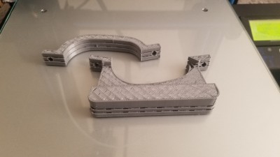

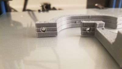

I'm trying to set up my Geeetech A10M and have run into some problems. It appears that my Y motor is skipping when there is some sort of profile change. This could be a new geometry, or a hole, an overhang, or any major change in the geometry at all. But it's not always consistent in the EXACT same spot, but it is a repeatable process if the same part is printed twice. I've attached an example (one of the more benign examples).

PS. The file model that was printed for this example is a prototype with just 1 layer and a 10% infill
