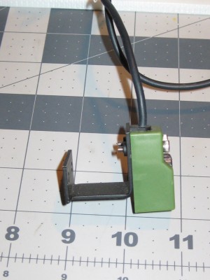

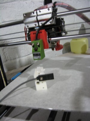

On your 3DP11 did it come with a SN04-P Proximity sensor and mount.
If so I removed My Solid Sensor mount and replaced it with a spring loaded slide mount.
https://www.thingiverse.com/thing:1534152/comments
Then I replaced the SN04-P with a TL-W3MC2 Proximity Sensor and redesigned the slide Mount.
Either the SN04-P or TL-W3MC2 Proximity Sensor make for a much easier alignment of the 3DP11.

yes mine originally came with that green sensor. As I may have said, I never had the z-axis limit switch installed and after watching some old videos I figure I left it off a couple of ears ago because I was using the green sensor. In my attempts to get the printer working last week I actually hooked up the z-axis sensor in the phoenix spot for the green adapter and just moved the green one over to an open phoenix spot Probably messed something up on the board. That new sensor in the bottom pic probably comes as just 3 wires at the end....How did you plug it into the board?
Re: Hictop 3dp11 Printer
I wired it to a Keyed connector as shown in the photo.
This sensor is the similar to a end-stop switch nothing is changes in the firmware.
As my 3DP11 did not come with this sensor, when I purchased one did not have to change the firmware.
When I changed over to the smaller TL-W3MC2 sensor I then inverted the sensor input.
