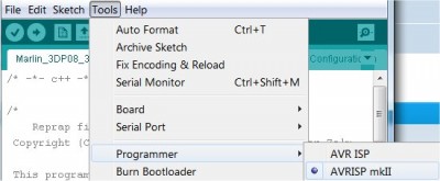

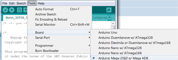

This step slipped my mind.
You have to select Board> Programmer Arduino Mega 2560 or Mega ADK
You have to select Tools > Programmer AVIRSP mkII
