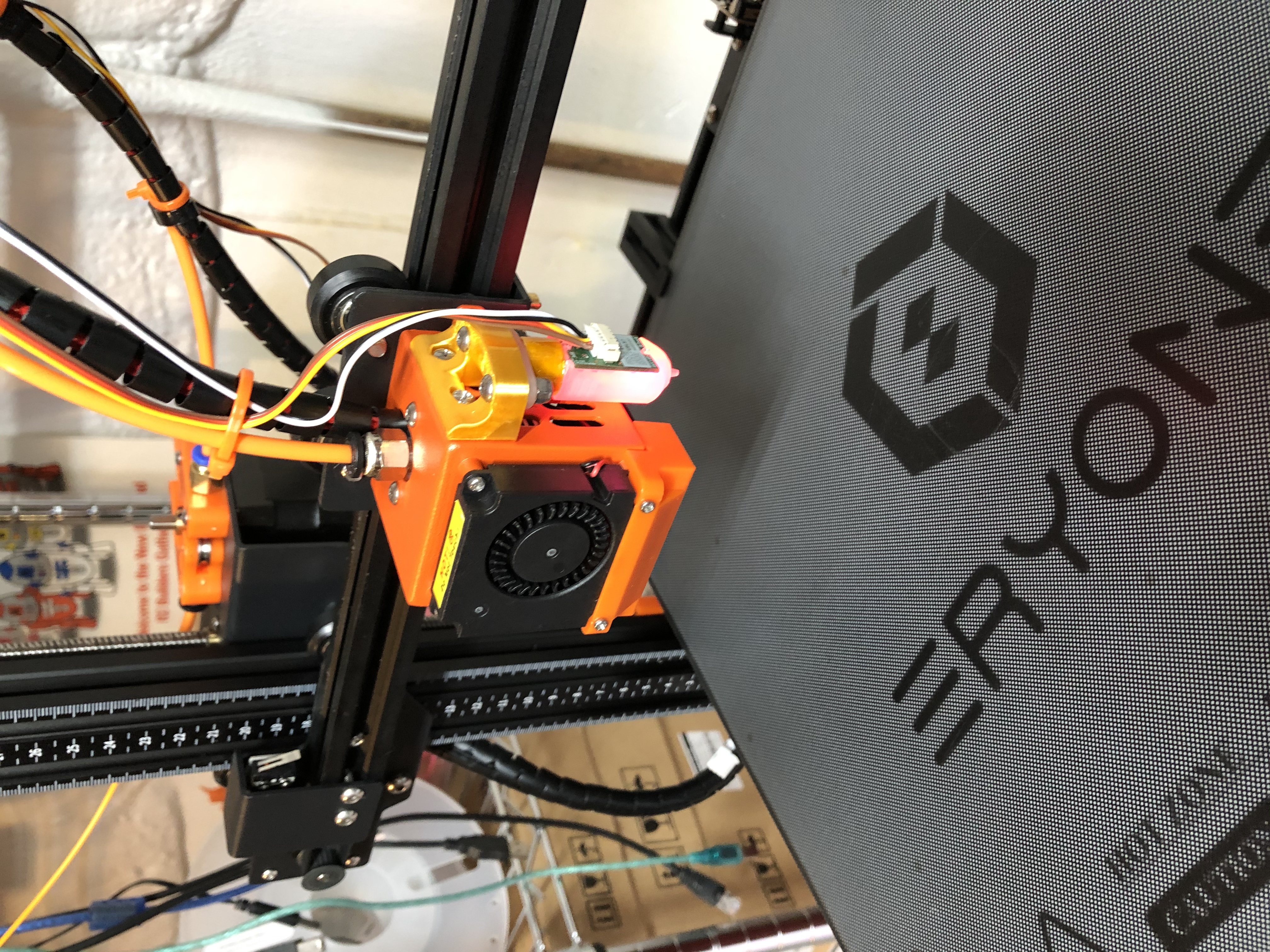

I had a rattling fan from the control box area due to the fan being screwed in too tight to the sheet metal shroud. A few little turns, backing it off, silenced it.
The machine has dual z lead screws and the vertical beams have measurements on them. It struck me as not needed at first. But it’s a darn handy way to see if your X gantry is level at a glance!
Another neat perk is near the extruder motor mount, they have a pre wired jack for a BL touch to plug into. I installed one and after figuring out which pins I had to move on my BL Connector, it was super easy to setup.
Like most bargain priced printers, the beds can be less than perfect. I checked and leveled each for the four corners twice. The middle still had quite a dip. The glass bed came with binder clips and these wonderful glass clips. A metal [ shape with a threaded hole at the bottom. It’s so clever I wish more printers had this.
The printer doesn’t seem to have any eccentric nuts for fine tuning. Mine hasn’t needed any. I did have to tighten the belts but I am told they are left slackened to avoid flat spots while sitting/waiting to be sold/shipped.

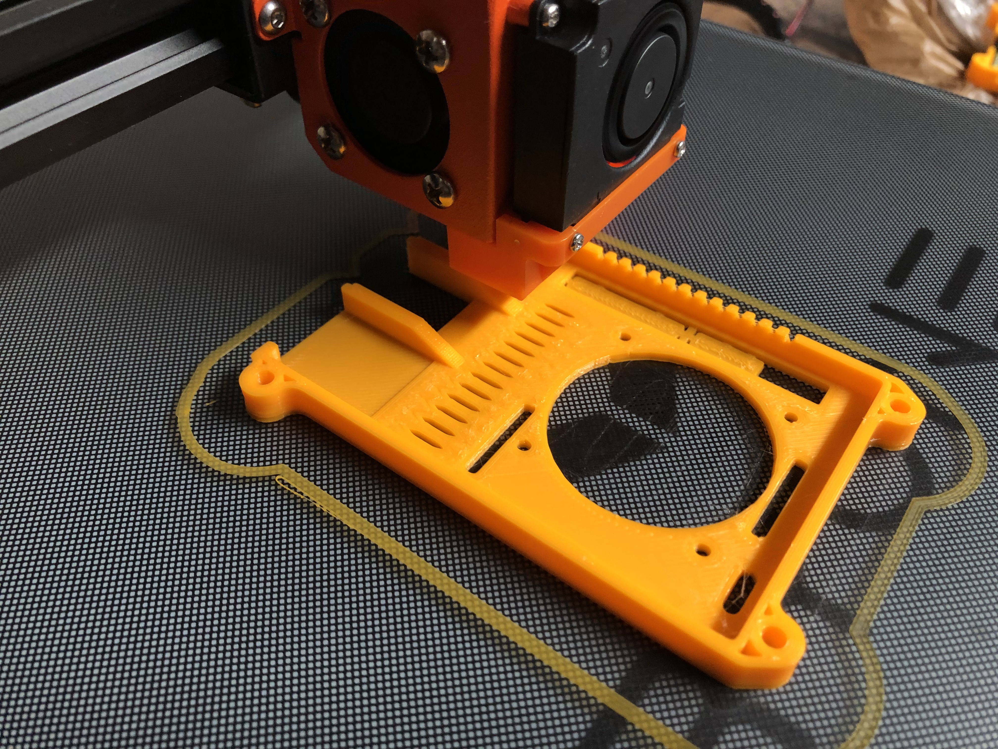

Print quality is very good. No salmon skin! And the only thing you hear is the whisper of the hot end fan. It’s almost too good to be true.
