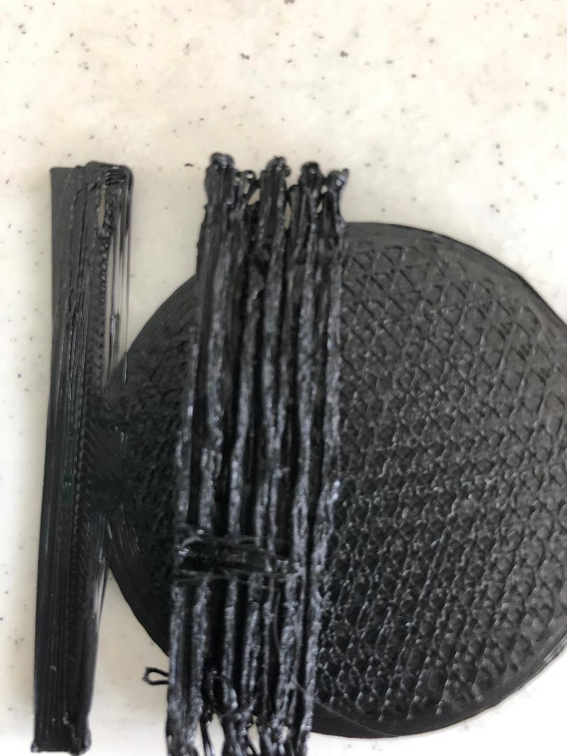

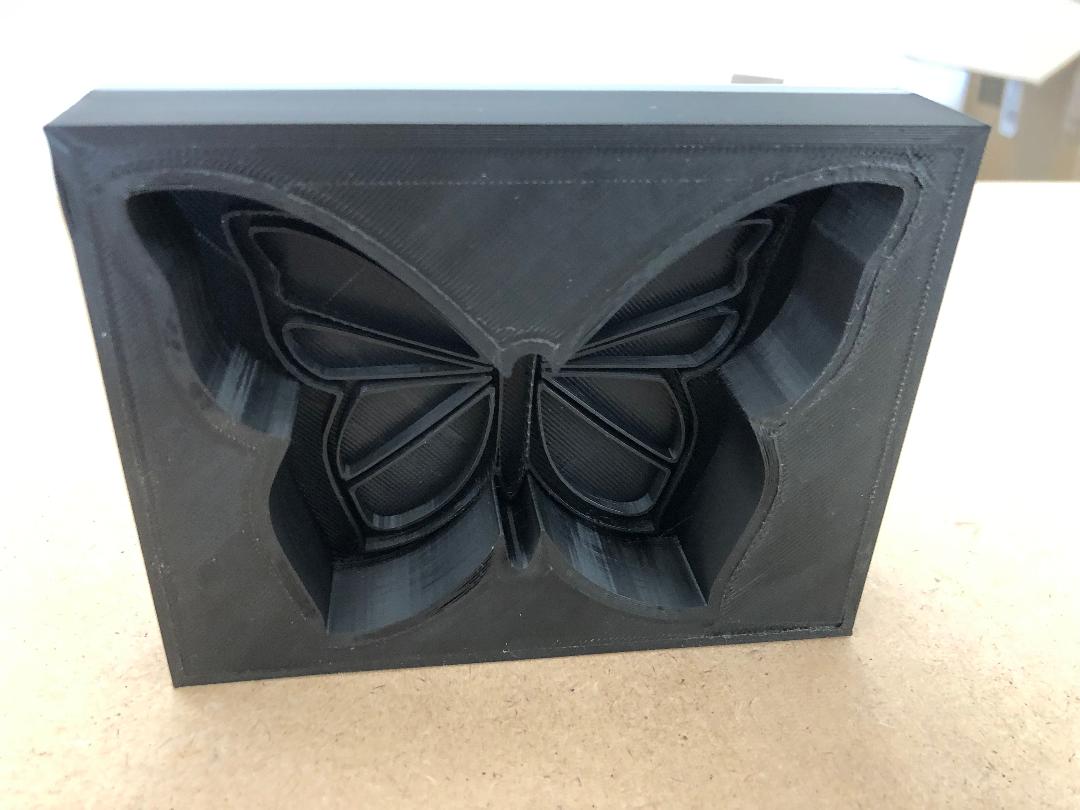

Hi all, Have 2 Hictop dual extrusion printer. They have been printing simply beautiful prints until recently and have completely gone off the rails

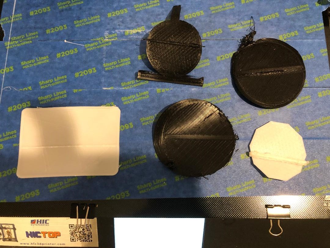

Attached are pics of one of the great prints and the others are of what has been happening lately

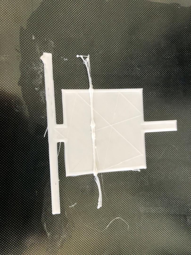

Lays bottom layer and next 3-4 layers no problem, no adhesion problems, then they start either printing layers off skew or, and this now happens all the time, starts printing a horizontal line across the middle of the print (as per pic)
Has anybody got any ideas as to why this is happening and how I can fix it - PLEASE

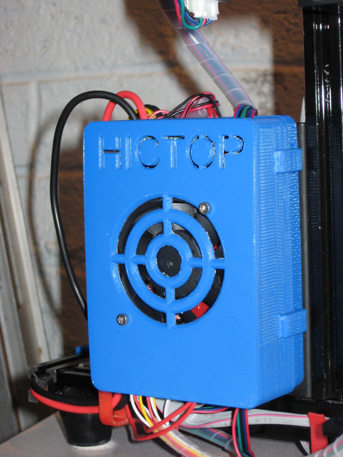

First I make a 3D Printed case of my controller an lined the inside of case with aluminum Duct Tape, this proved effective,
but it required more shielding. I also moved the LCD displays to the Front frame rail for ease of use also helped stop unintended moves.
I re-routed all cables inside controller case the shortest direct path to the an exit portal with-out crossing the stepper motor drivers.
My Case Designed Attached, No fan mounting hole's were included holes need to be drilled for fan used.
