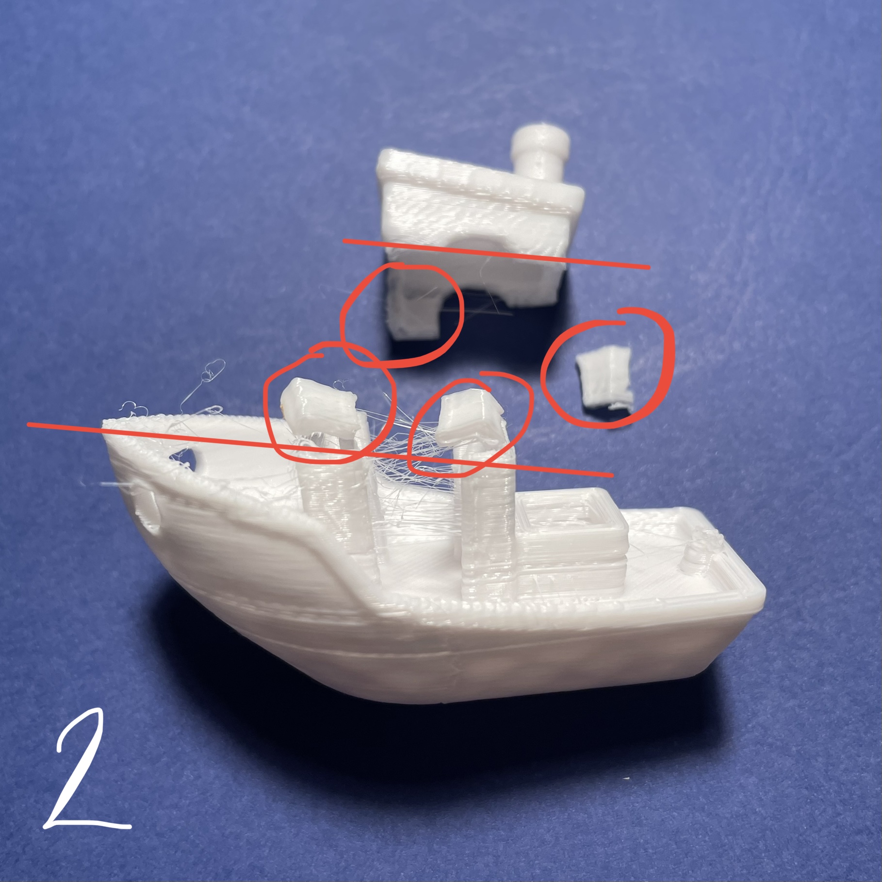

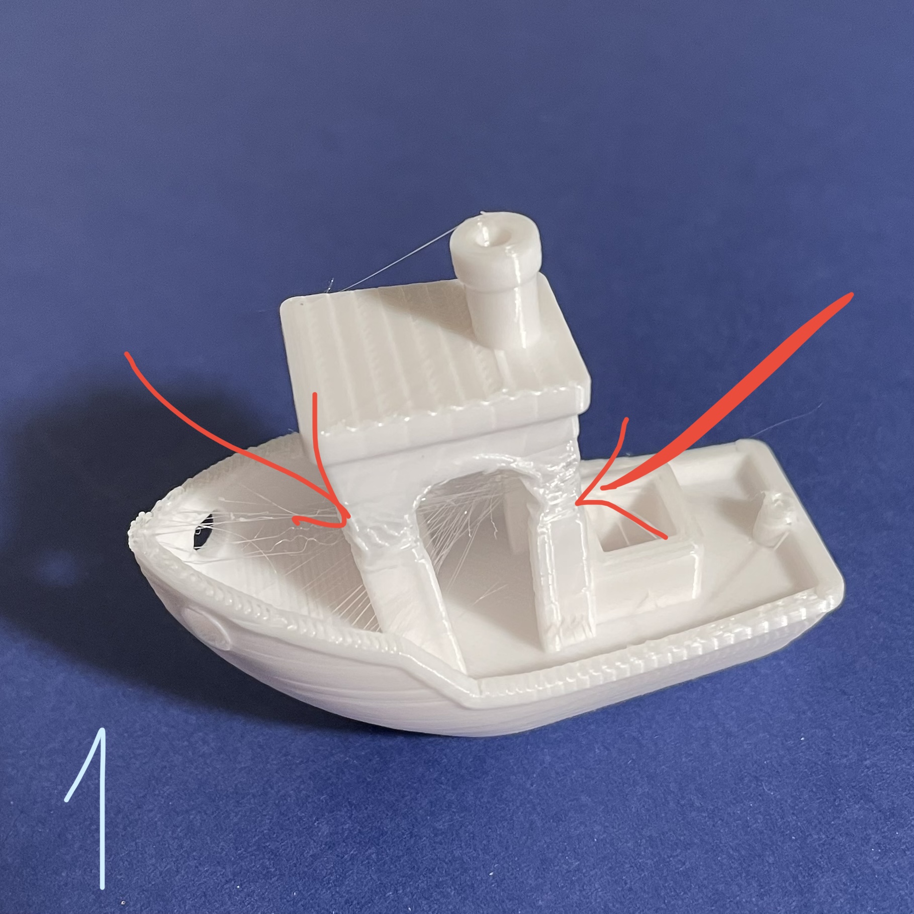

I´ve spend a lot of time calibrating my Ender 3
(first version; connected to an octoprint-python3-server via USB/serial on macOS).
What I did so far:
- bed leveling to perfection
- check axes angles
- check extruder nozzle
- filament and feeder are okay
Benchy now works so far as seen in the pics. Only thing is the deck house pillars are unstable at these marked two points:
Within the pillars themselves are absolutely stable (see circles on Pic2). Seems to me as if the critical two points are exactly at the beginning and end of the slices where only these pillars are printed. So after the last slice where parts of the "bow is ending " an the before the deck houses roof slices come up.
I tried already to reduce the speed to 25mm/s (even travel speed) assuming that the PLA has no time to harden when the extruder arrives to early for its next slice as there only these pillars to print. But that does not go together with the fact that the pillars are stable within themselves.
Tried bed from 50-60 and extruder temps from 195 to 210 °C.
I really have no Idea why ONLY these to deckhouse transition layers are affected...
Any help would be really appreciated!
