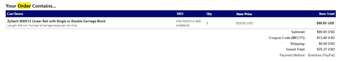

Just wondering if anyone replaced the three rail/block assemblies with something better than what came with the FT-5? If so, what model and price. I don't want to pay an astromonical amount, but don't want to go cheep with hiwin knock-offs. A max of $150 for a full set of direct replacements would be fine.
I couple of years ago I replaced the ball bearings in all three blocks, but it has gotten noisy and slightly binding again in spite of maintenance.

I have 2 FT-5 R1's and 1 FT-6
I think some of the people in the FB group upgraded to the Zylech rails. Mine seem like they are always full of orange gunk when I clean them

This is what was suggested
