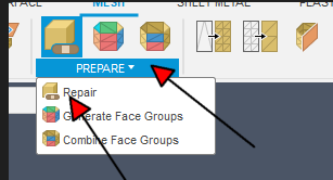

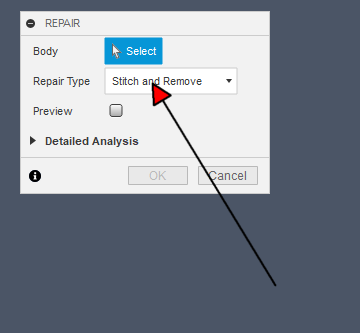

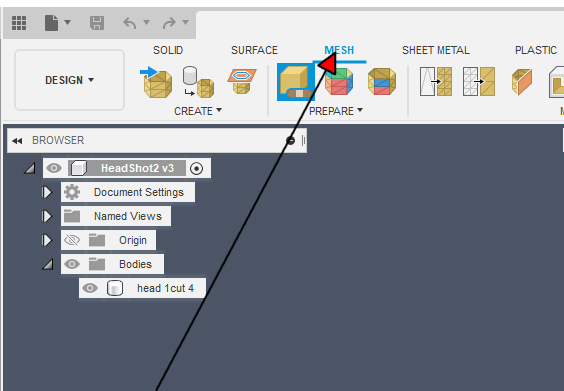

With the original mesh open,
Select the "Mesh" Menu system:
Ithen selected the "Prepare" section and then the "Repair" item:
Then used the "Stitch and Remove " command
Selected the surface and hit "OK"
Hope the images come through and this helps.

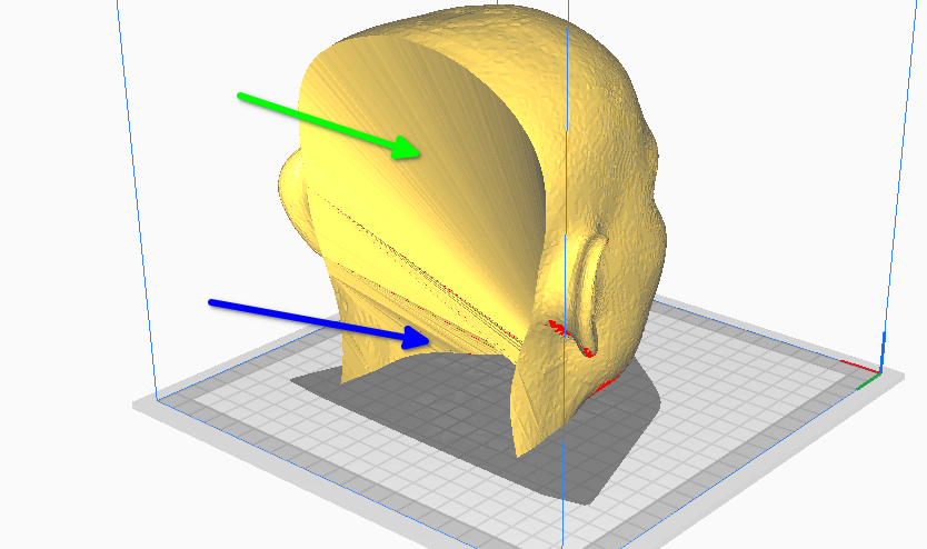

do you know how I might be able to reduce the amount of material inside the head? I went to print it and the print will almost take a week :shock:
because the step to fill it in was done inside fusion360 I assume that I would need to reduce the amount of material in fusion.
here's a link to the model i'm talking about:
https://fastupload.io/OGPdeJIXQDnSzde/file
and i've attached a picture. the green arrow points to the area i'm focused on.

I have avoided answering this one in your other thread because you are asking for an oxymoron! Remove material, but not provide support! If you remove material, it won't be supported and you state you don't want to print support. Can't have it both ways.
Now having said that, you might try the shell command applied to the back face and then try slicing it to see your print time etc. You will probably have to add supports and I would suggest trying various types to see the effect on material usage, and time to print. Also might try slicing as is with a very reduced infill and maybe with something like the "lighting" infill??

basically I just need to reduce the amount of material inside the head to a healthy middle ground where there is enough to serve as a support, but not so much that it takes nearly a week to print. that way I won't need to add any additional supports, while still maintaining a printable object. (but adding supports is fine. i don't have any problems with that.) the original problem i faced was having the object in blender not being anywhere near thick enough to 3d print, hence the need for infill.
is there any way that i could tweak the amount of infill inside the head? because that's all i really need to do.
the material that has filled the head is produced in fusion after I solidified it. so i'm not sure if i would be able to alter the amount of it in another program.
can you elaborate on what you mean by 'shell command applied to the back face'?
i'll try out your other suggests asap
Country_Bubba
Posts: 69
Joined: June 8th, 2019, 10:12 am
3D Printer(s): Tronxy X5S-400, Ender5
Re: cura not slicing
Post by Country_Bubba »
The shell command in fusion 360 removes all material from the inside and leaves a wall of the thickness you desire. i say apply to the back face as it will remove that face to shell out the rest of the body.
You can then slice with supports of your choice.
If you slice with it as is, you can set your wall thickness in cura and also specify the density of the infill. I usually use between 10 and 15% for non structural parts.
As previously stated, try it different ways to see what the estimated time and materials are.
