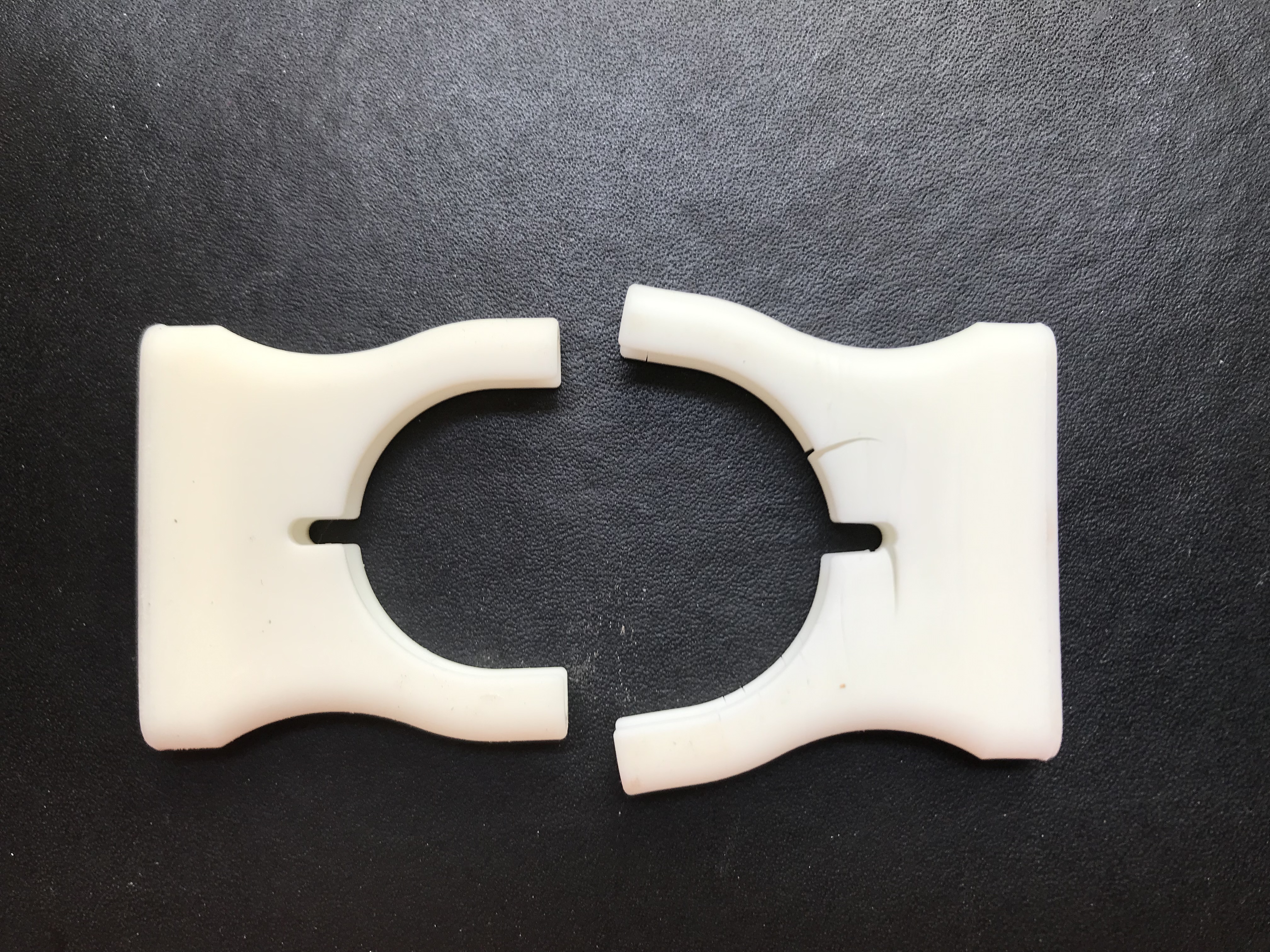

I sometimes leave my prints in the alcohol for a while before I clean them with a brush and take them out to be cured, usually only a few hours, or at most a day.
I 3D printed a small bracket and left it in the alcohol over the weekend, when I took it out it was all distorted:
Good print in the alcohol 10 mins vs bad print left in a weekend.
I never expected it to distort this much. The parts are just over an inch square.
