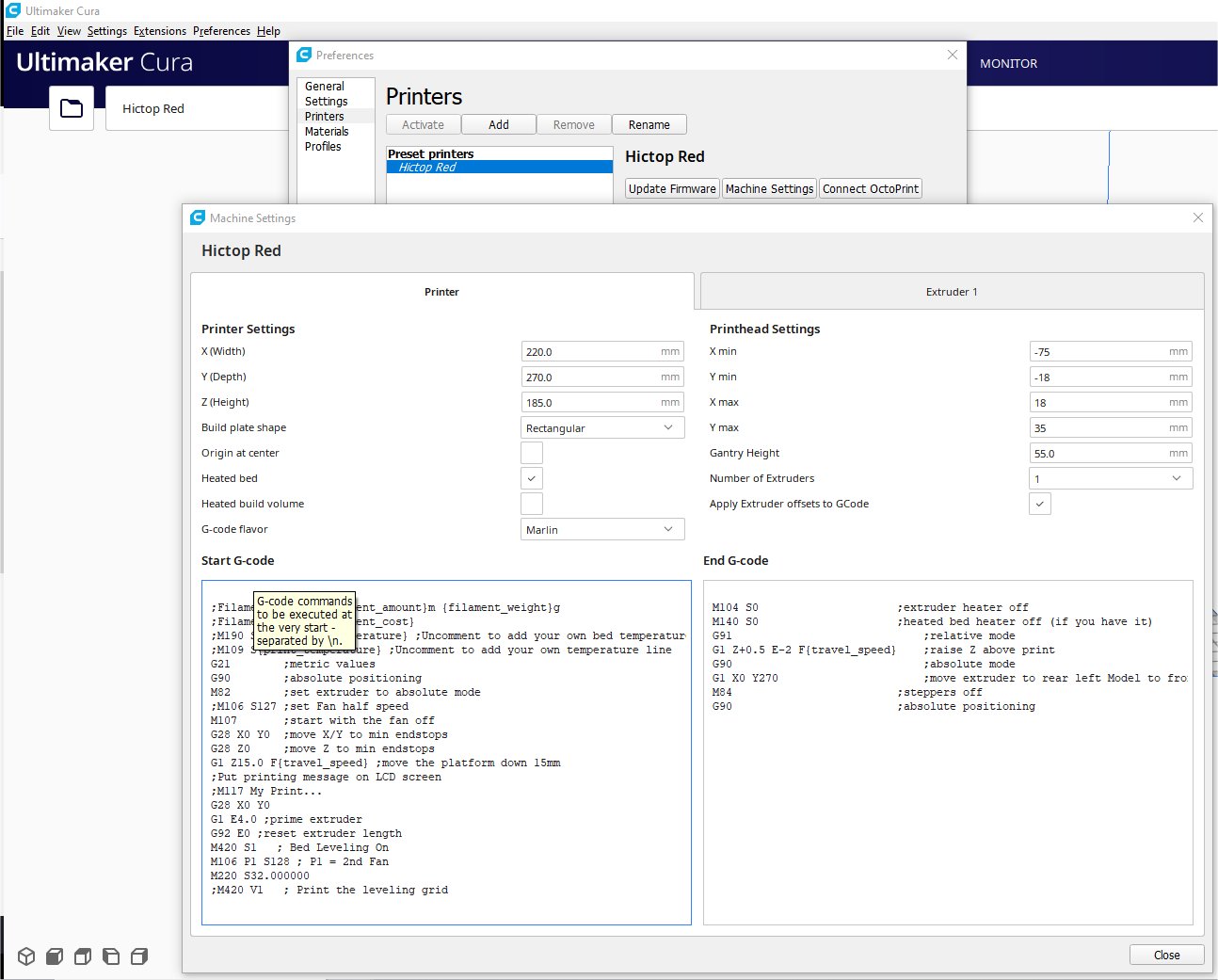

Previous to switching my machine on I had installed Cura 4.3.0. But after a hard failure a couple of years ago I lost my Cura G-code settings. So running a test print today everything worked fine, except that is at the end of the print were the bed would move to the back of the machine, then the extruder would park to one side then the bed move to the front for print removal.
So could anyone here please check my start and end G-Codes in Cura machine settings and let me know if anything is missing please?

I will be here for a long time to come.
For me this G-Code is( for my Hictop 3DP11- or 12 printers ):
It has been a long time though I believe the code should be.
My Bed size is 220mm X x 270mm Y
Code: Select all
G28 X0 Y270 ;move nozzle to back Left, so the head is out of the wayRe: Cura Machine Settings G-Codes

In Cura Click on Preferences select Printers
Select Machine Settings.
You will see the settings used in my Hictop 3D Printers
Below is the code line you want.
Code: Select all
G1 X0 Y270 ;move extruder to rear left, Model to front.
I should have noted that not all Hictop 3D Printers have the 220 X 270 Bed surface.

Hi Clif
A bit late in the day but better late than never!
Many thanks for your reply and help.
