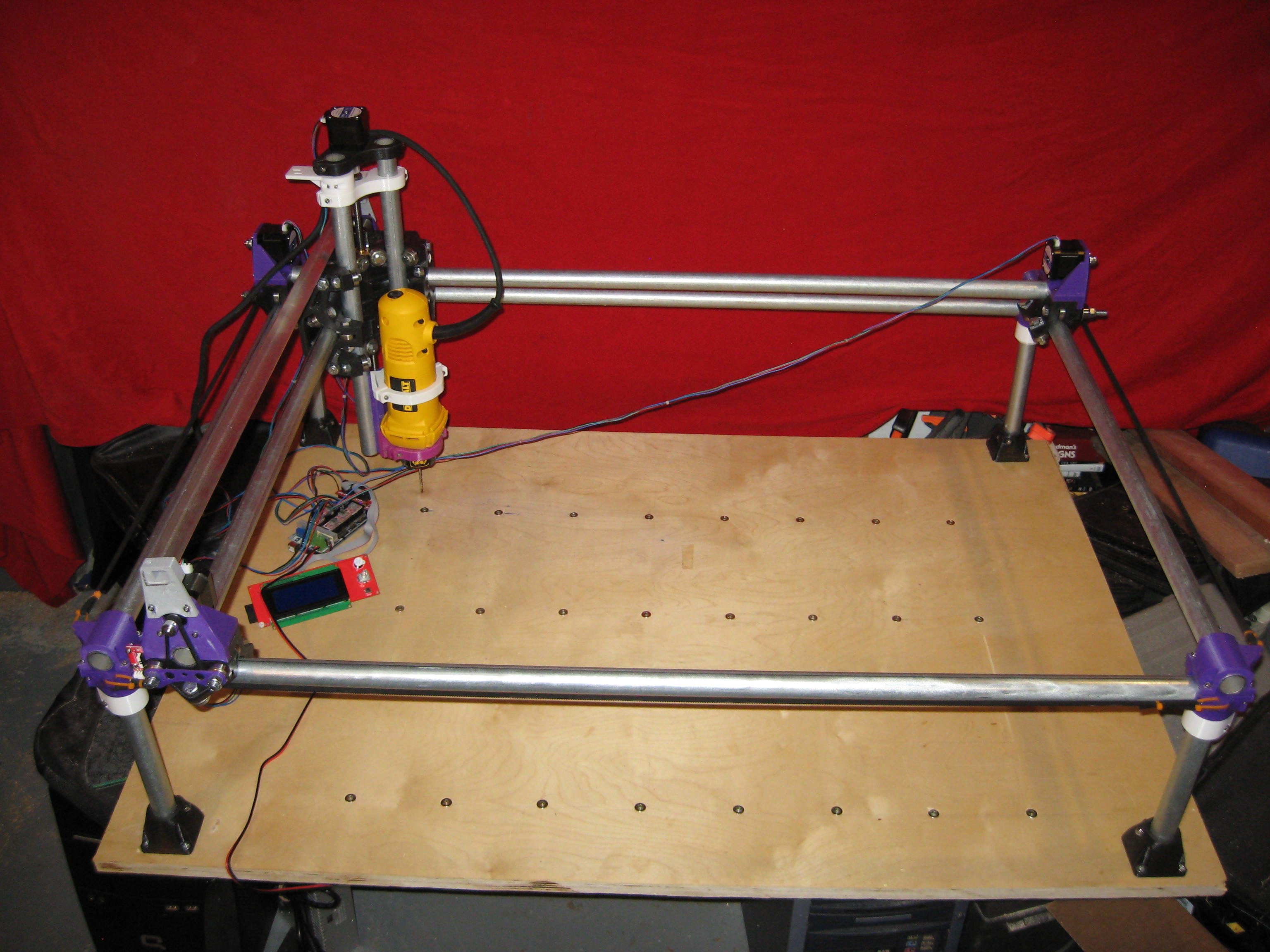

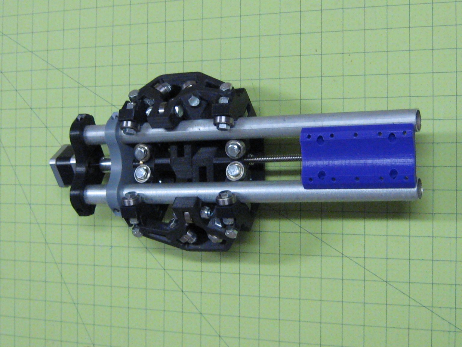

I 3D Printed in ABS most of the Parts for my MPCNC

That's a very neat CNC, maybe you should add some sub-forums here for the 1610-3018 series and home-brewed machines? There's a lot of commonality with the 3D-printers.
